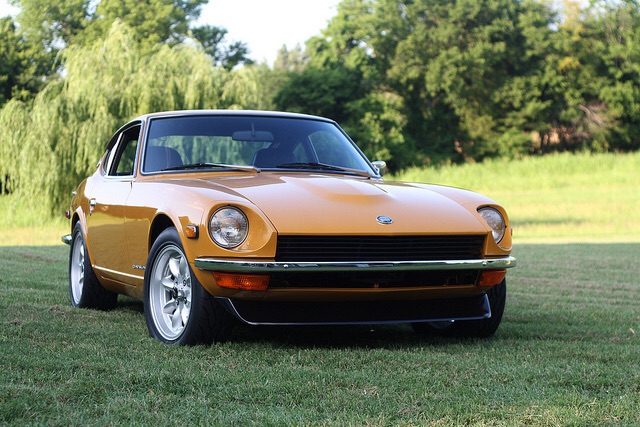

I have been itching to try to put a more accurate fitting BRE replica rear spoiler on my car.  So I pulled mine off and I need to do some tiny little scratch touch ups.
While I was doing that I thought how some cars really looked 'the business' with a black rear spoiler.
What color were the spoilers when the dealer added them? They did paint match them.  Datsun did not supply the car with rear spoilers did they?
If I wanted to put on an accurate rear spoiler, which one would have been picked back in the day. I am thinking of going with a BRE from www.bre2.com and order from Gayle and Peter.  But should I get it paint matched, or should I just paint it the same color as the rear tail light panel?
What was the typical way they came?

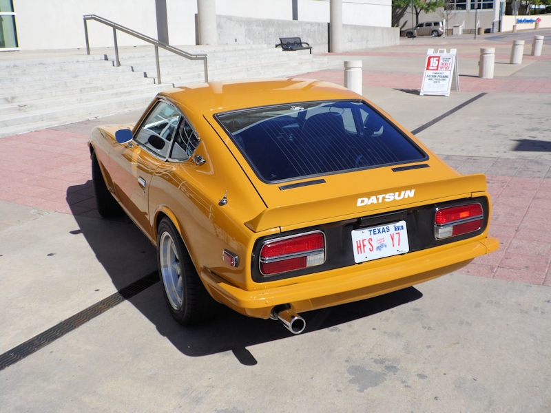

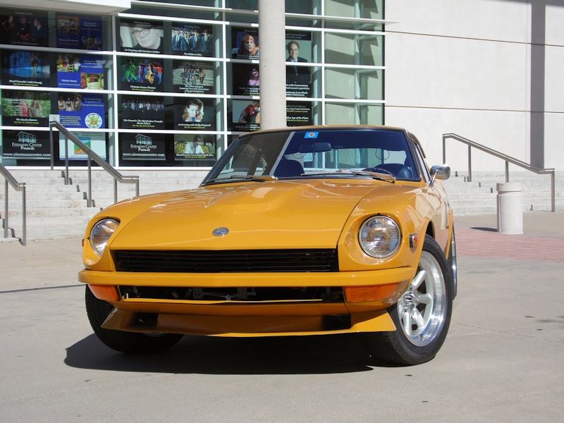

The dealer added spoilers ( both front and rear) were BRE type to mimic Morton's Road Race of Champions class winner. I'm guessing it was owners option. Personally I like the rear spoiler painted the color of the car....the front spoiler a charcoal gray or black.

But it sounds like I could go either way if it was an owners choice. I may paint my current one the same as the rear tail light panel, or an even darker flat black like your front spoiler Guy.
Then I will order a new BRE style from BRE or MSA.

I bought my BRE type spoilers from MSA, then used wood clamps to clamp them to the front valence. I drilled 5 holes and bolted on with stainless steel bolts and large flat washers. I can't remember how many bolts were in the rear spoiler, but we used a thin rubber spacer (O ring) around each bolt to allow a small space for water to pass under the spoiler and seal the bolt hole water tight. Whatever you like is the right way as far as color for the spoilers.
BRE spoilers look great body colored or as a contrasting color.

The dealer had already installed the 1st-gen BRE Spook and rear spoiler on my car when I bought it back in '71, they painted both in body color.  I stuck with these choices when I resto'd the car.  My general observation is that body colored front and rear spoilers will add visual "bulk" to the car - provided the car is not a very dark color to begin with.  Body color will also cause the add-on to better blend into or accentuate car's lines.  I second Diseazd's comment about the use of small O-rings as seals against the body.  As so many of us have said - your car, your choices.
