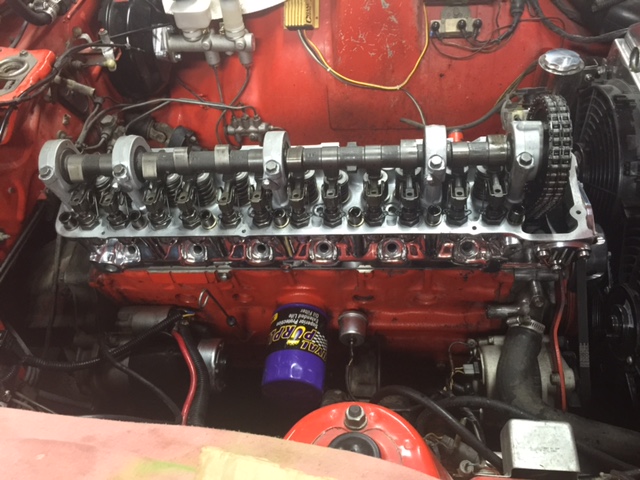

I removed my P90 head off my 1974 260z (N42) and I installed a polished E88, with performance cam, to raise the compression.  Tomorrow I'm installing the ceramic coated 3-2 header and rebuilding my dual webers.  Hopefully it will work nice with my 4.10 rear gears and 5 speed trans.  This is how I'm spending my two week Christmas vacation.  I hope to get everything completed before I go back to work.

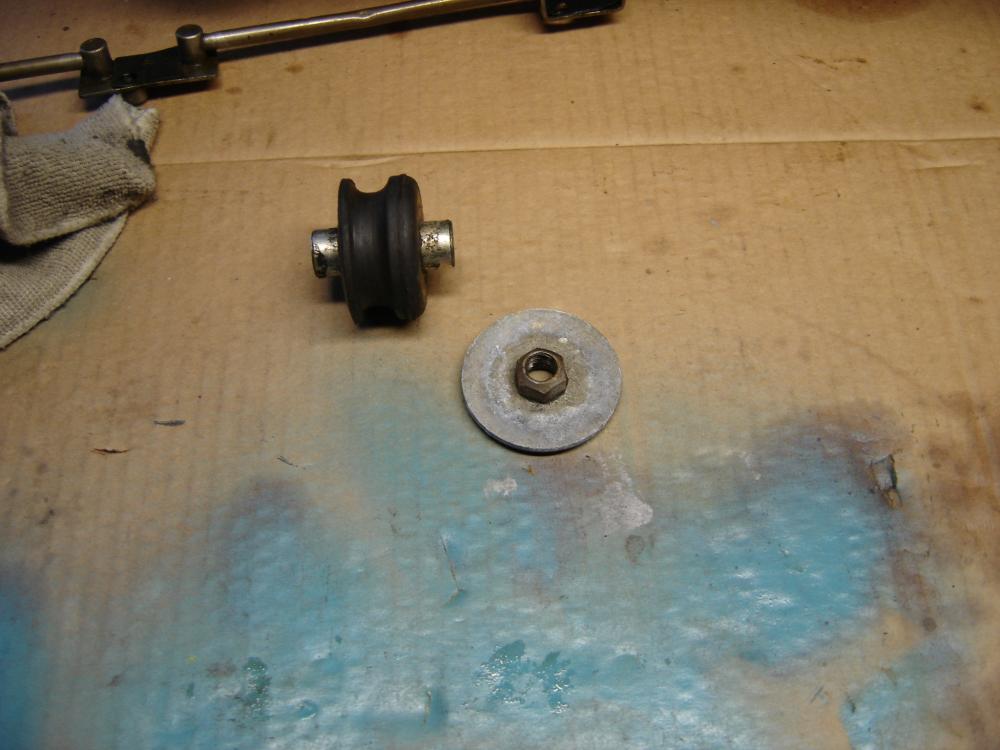

Drove the 280 and found this cup washer and nut in my driveway when I got back home.  Luckily the bushing hadn't fallen off yet, it was really close though, got lucky!  I'll put it back on with some red Loctite then do the other side as well just to be sure.
