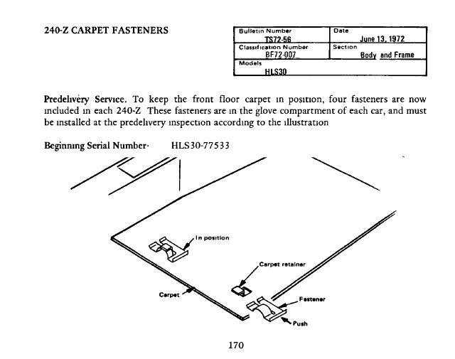

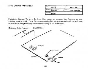

I remember seeing this TSB a while back and I thought it was relevant to this thread:
post-7818-0-37903900-1449082000_thumb.jp
Does anyone have these clips? The dealer was supposed to install them during PDI.
Mike
I have several and I am working with Ryan at Zcardepot to have them reproduced and made available again.
Way to go Jim! That will save me from trying to find someone to reinvent the wheel or hours translating Japanese ebay pages looking for them
