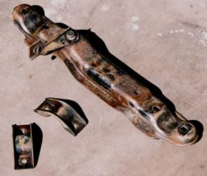

October 24, 20159 yr comment_479719 Hey! I found some more pictures. Here are the front suspension compression rods I was talking about. I also have yellow paint on the transmission brace bolts and differential mounts. The yellow paint was applied to indicate correct installation and torque. You made me giggle with your overspray, comment, Dan. Who the hell is ever going to know?!!?!! Here is my best oil pan overspray picture...both styles! Link to comment https://www.classiczcars.com/forums/topic/52669-cataloging-240z-factory-manufacture-paint-marks/?&page=2#findComment-479719 Share on other sites More sharing options...

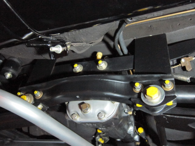

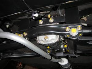

November 14, 20159 yr Author comment_481014 Thanks to everyone who helped out with all of the reference pictures. I finally took the plunge and started to do some of the yellow inspection markings to see if I wanted to go down that road. Here are some pictures and your comments are welcome-too much/over the trop? Link to comment https://www.classiczcars.com/forums/topic/52669-cataloging-240z-factory-manufacture-paint-marks/?&page=2#findComment-481014 Share on other sites More sharing options...
November 14, 20159 yr comment_481015 Dan Don't forget the large red paint mark on the tranny Link to comment https://www.classiczcars.com/forums/topic/52669-cataloging-240z-factory-manufacture-paint-marks/?&page=2#findComment-481015 Share on other sites More sharing options...
November 14, 20159 yr comment_481019 Too clean. Too sterile, neat, tidy. You're missing drips and runs in the paint. Splotches! We must have splotchy paint! And splatters. It's the splatter that matters! Link to comment https://www.classiczcars.com/forums/topic/52669-cataloging-240z-factory-manufacture-paint-marks/?&page=2#findComment-481019 Share on other sites More sharing options...
November 14, 20159 yr Author comment_481022 Too clean. Too sterile, neat, tidy. You're missing drips and runs in the paint. Splotches! We must have splotchy paint! And splatters. It's the splatter that matters! I just knew you were going to see, and say that. I agree, but it goes so much against a neat freaks nature. Time for further experimentation! As for the red paint mark on the tranny, that's a whole new project, ie., correct color, placement, drips, runs, etc. Thanks guys Link to comment https://www.classiczcars.com/forums/topic/52669-cataloging-240z-factory-manufacture-paint-marks/?&page=2#findComment-481022 Share on other sites More sharing options...

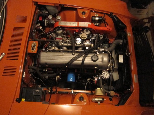

November 9, 20168 yr Author comment_506125 On 11/14/2015 at 2:47 PM, 26th-Z said: Too clean. Too sterile, neat, tidy. You're missing drips and runs in the paint. Splotches! We must have splotchy paint! And splatters. It's the splatter that matters! Thought I would update my pictures after re-doing a lot of the manufacture inspection marks on my car. Not quite as neat and sterile as before. I still need to research the correct red for the front suspension compression rods that 26th-z mentioned and for the tranny bell housing splotches also shown in previous posts. I still need more evidence that those red inspection marks would be correct for my car. Link to comment https://www.classiczcars.com/forums/topic/52669-cataloging-240z-factory-manufacture-paint-marks/?&page=2#findComment-506125 Share on other sites More sharing options...

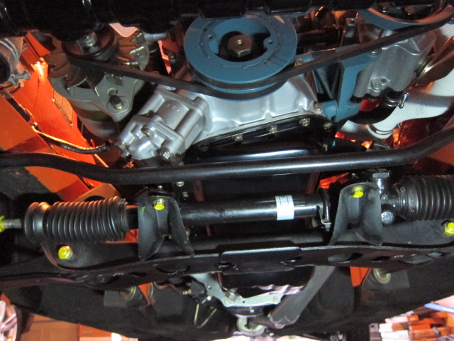

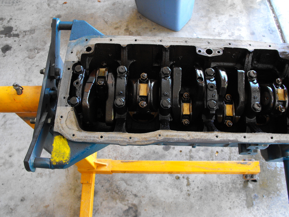

November 9, 20168 yr comment_506126 Hi Dan, Here are a few inspection marks that are on my 1970 on the bottom of the motor and steering rack. Rich Link to comment https://www.classiczcars.com/forums/topic/52669-cataloging-240z-factory-manufacture-paint-marks/?&page=2#findComment-506126 Share on other sites More sharing options...
November 9, 20168 yr Author comment_506129 Hi Rich, thanks for those. I'm not seeing anything on the steering rack other than the colored tape. I'll definitely do the yellow mark on the engine. you have the earliest of oil pans, so may need to do some more research on the preserved white V marking. I've got one of those early pans in the attic which will go on eBay unless someone here wants to offer on it. Dan Link to comment https://www.classiczcars.com/forums/topic/52669-cataloging-240z-factory-manufacture-paint-marks/?&page=2#findComment-506129 Share on other sites More sharing options...
