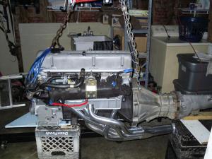

I did the motor and transmission first, then dressed it up. I'm on my phone now but will post a picture of my set up. You need to build this wooden crate looking thing, I can get the measurements, to mate the motor (on the wooden thing) and the trans., on some kind of jack. If you're trying to do this by yourself.
Try your best to decipher my scattered brains this morning.
Mr Zedyone_kenobi had a great thread about his motor swap, showed a crate he built for the motor.
I built the crate, added some steel wheels.  Put the tranny on my motorcycle jack and slid them up to each other, bolted them together.  Picked the whole thing up with my engine hoist and put it into the car.
The 2x is too thick to let the rear clear the board so I had to chisel out 3/4" of the thickness and went down about 2" so it will clear the rear board, picture #2. You could still use the 2x but cut that out before nailing together. It sat about 1/2" short before I cut that out. But for storage it would be fine. And you'll have to go 1/2" farther back for the oil pump cut out.
Here's his thread, very informative read when you have a few hours, it's about 12 pages long. :)
http://www.classiczcars.com/topic/43476-my-datsun-spirit-l28-build/page-5
Go to post #86 for the crate info.
Here's mine ready for installation.
post-23570-0-17883200-1439480967_thumb.j
Looking back at his, I used 2x6 wood his is 1x6.  I would use 1x6 to avoid the problem with the rear not hanging off enough to mate the transmission. FWIW
