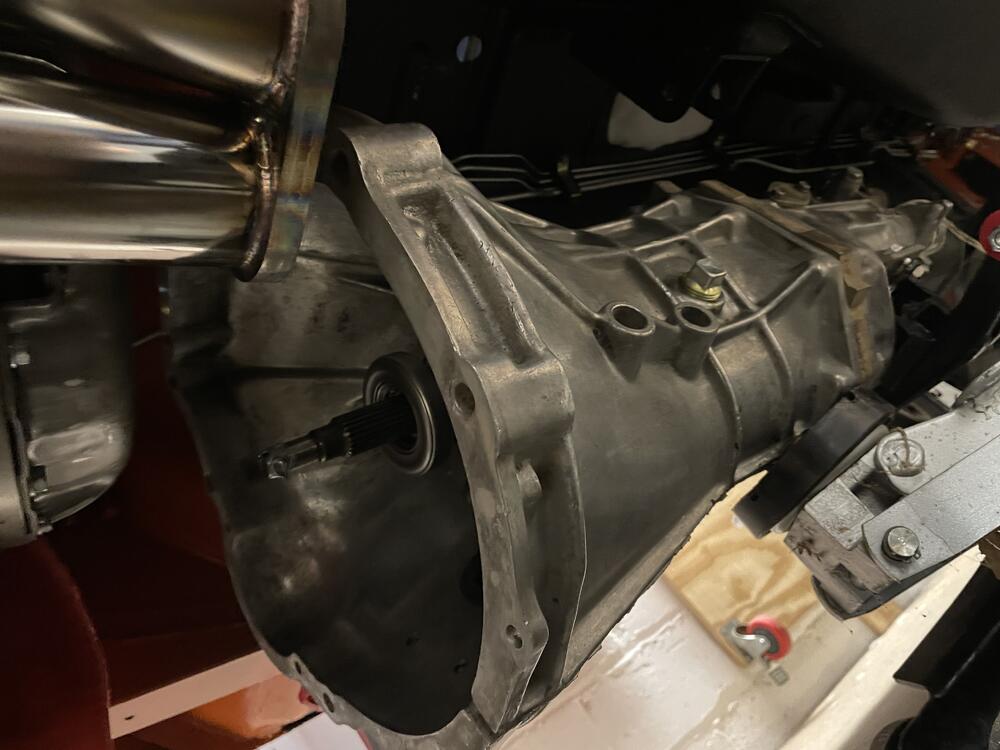

In other news, I installed my five speed!

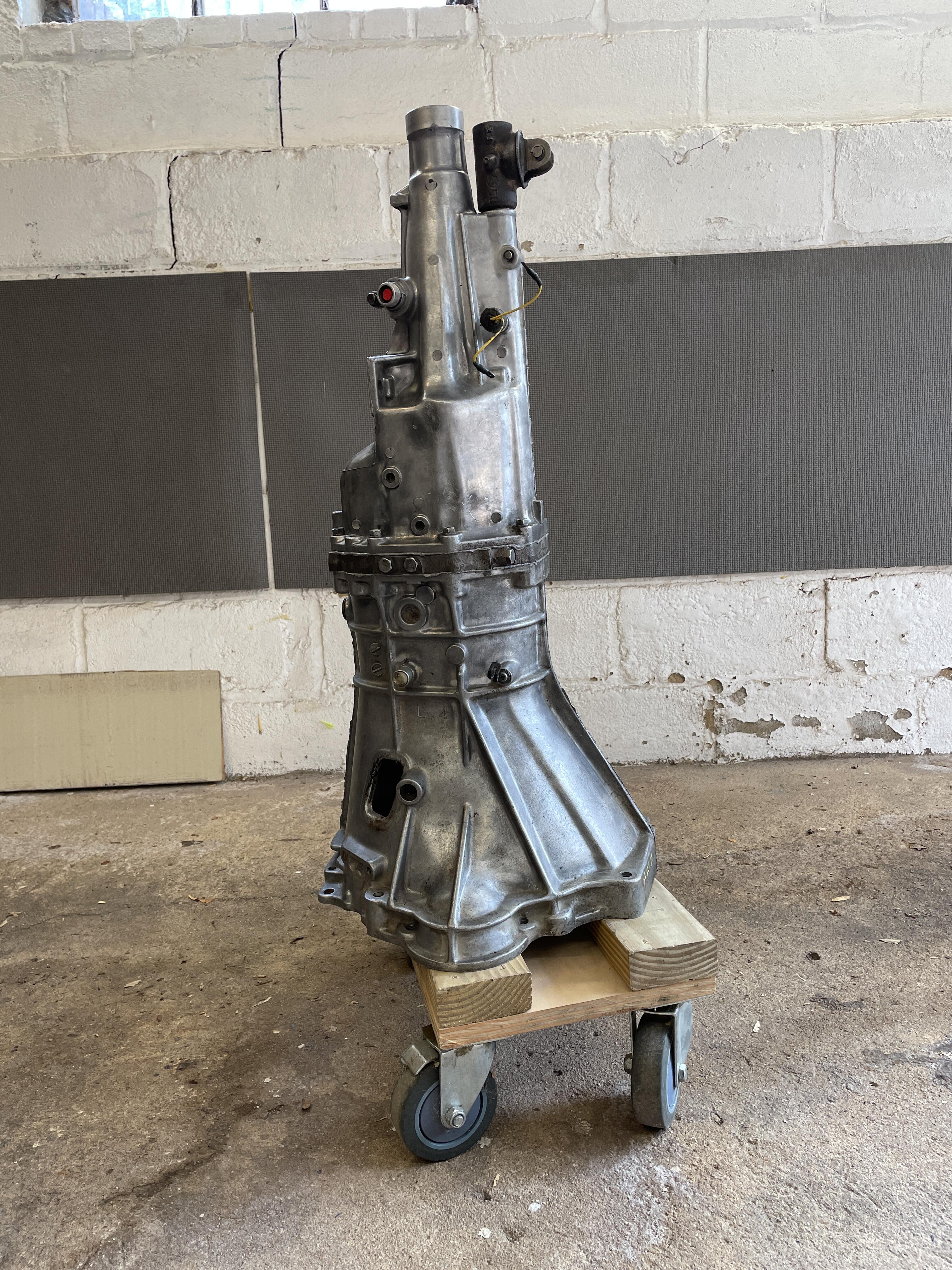

If you remember, this is a #1 case five speed out of a 1980 720 truck. I got it years ago from a yard in Idaho who pulled it back in 1983. When the transmission shop opened it up this summer they said it was nearly pristine, but I had them replace all the bearings and seals and springs anyway.

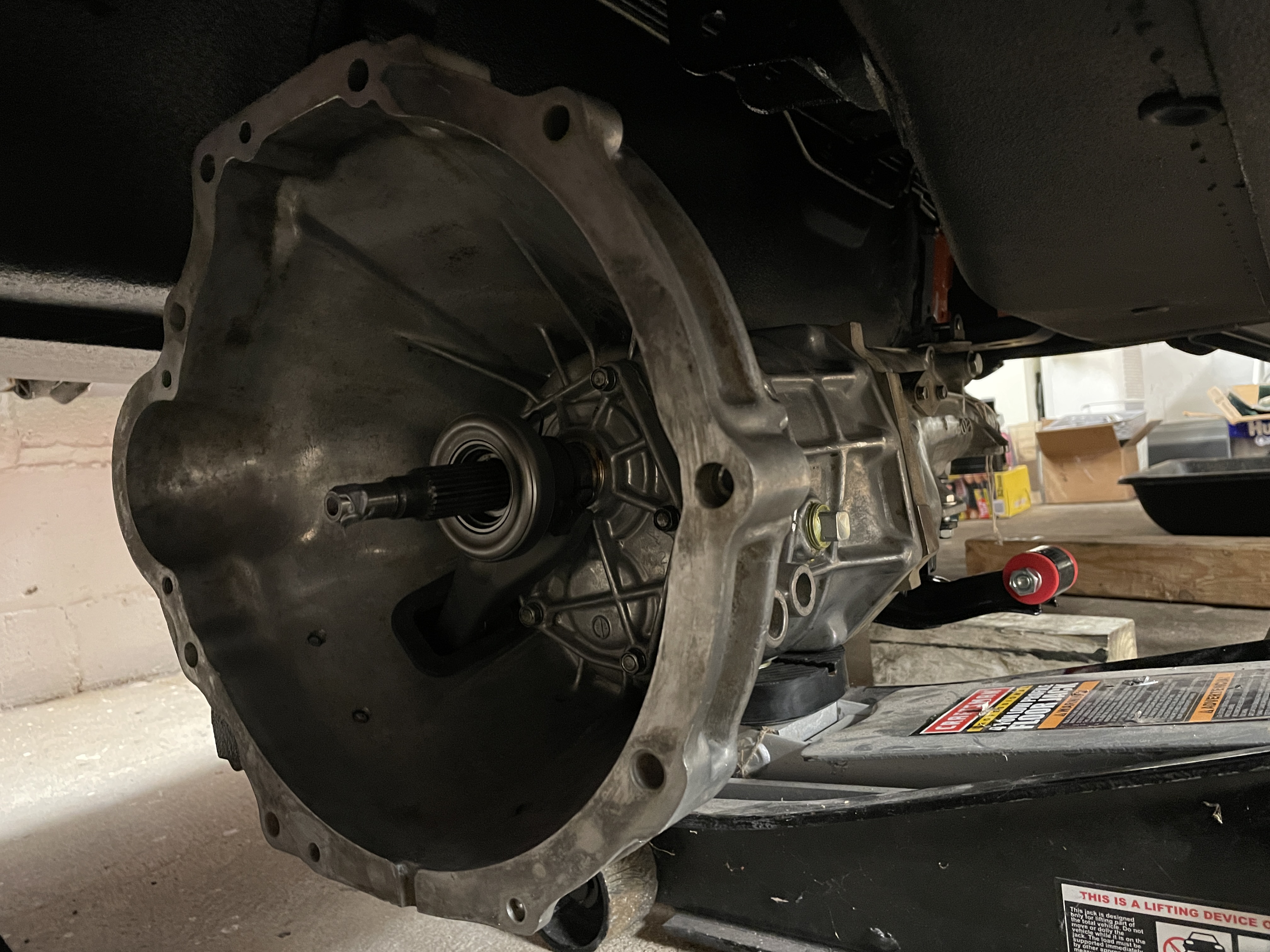

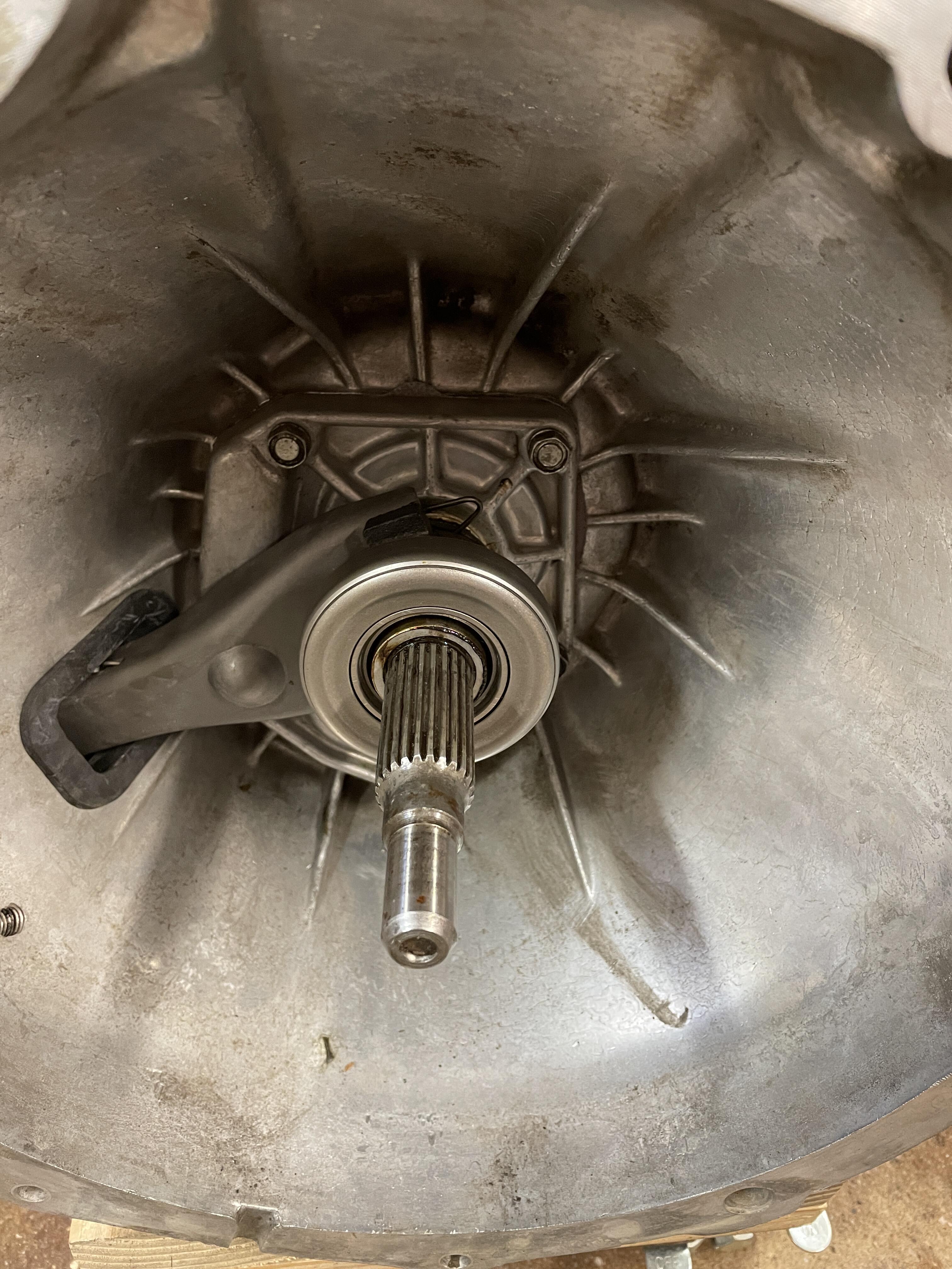

I got that back at the end of October and refurbished crossmember, got a new mount and all the random bits, and installed a 280zx clutch release sleeve and the pinion for my 3.54 rear end.

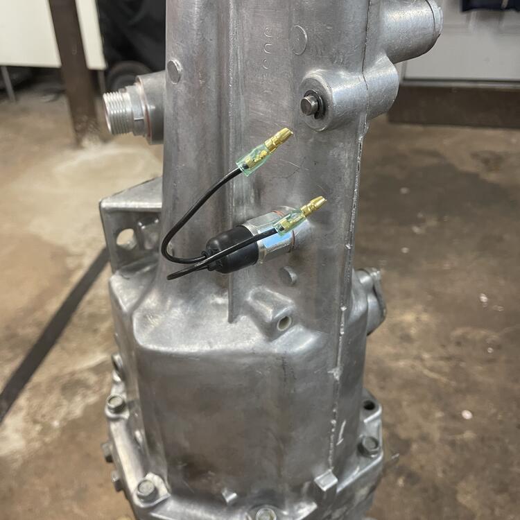

👆🏻 That’s a delete for the Top sensor.

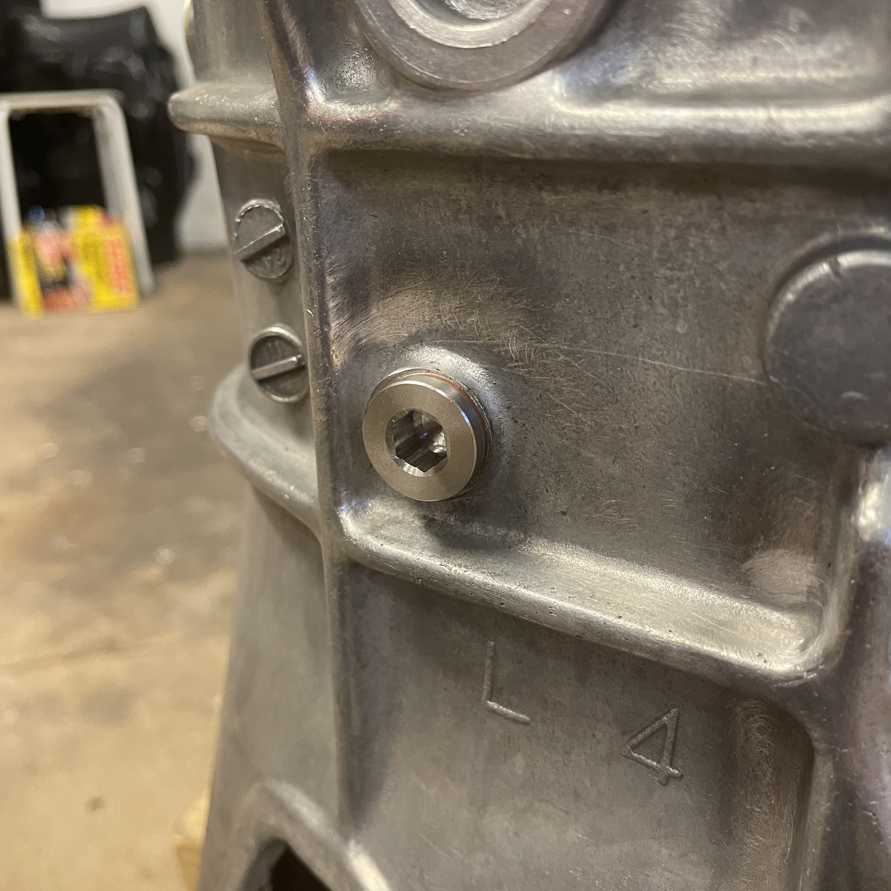

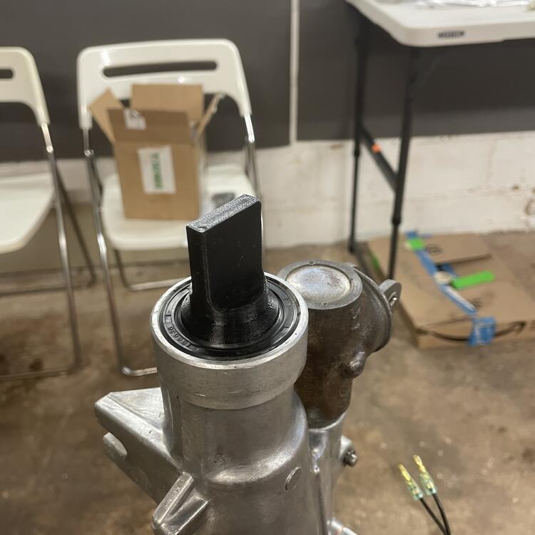

👆🏻 Output shaft plug until I put the driveshaft in.
👆🏻 240z vs 280zx clutch release sleeves.

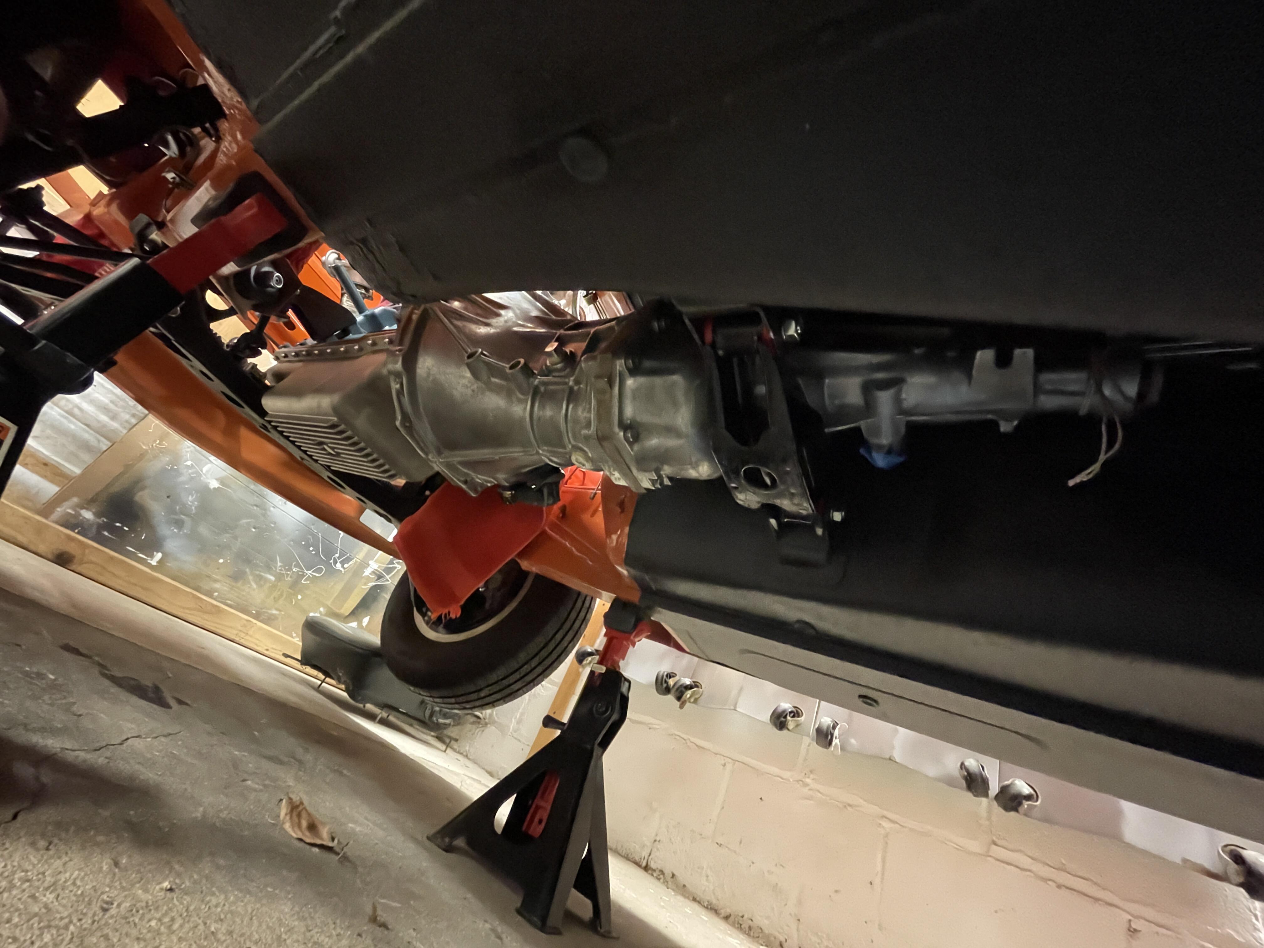

👇🏻Installation with the wrong kind of jack.
Yes I pulled the header to get the transmission in… at the last minute.

Looks like you have an F54 block with the holes for the engine-transmission gusset.  Designed to reduce NVH.  I can't remember how the holes in the transmission case look though.  Might not fit your setup.
Edited by Zed Head
-s
Oh, thanks. I had assumed those were for the power steering stuff that swoops under the engine, but I’ll check those out and see if they can attach to the transmission. There are a few holes that aren’t for the plate that is sandwiched between the transmission and the block.
So the 280zx gussets don’t mate to the 720 bell housing. The transmission isn’t drilled at the points where they would connect. I could drill it out, but really don’t want to. I’m going to look into whether the 720 had similar reinforcing parts.
Kameari makes a reinforcement, but it’s $200 and might have the same problem, plus it attaches at the oil pan, not the hard points Zed Head pointed out.
I think what will probably end up happening is I’ll live without it for now and fabricate one out of bent steel in the future. Given the transmission and engine are only connected by four bolts, I’ll definitely be doing something.
Would you mind sharing the stl file of the output shaft plug?

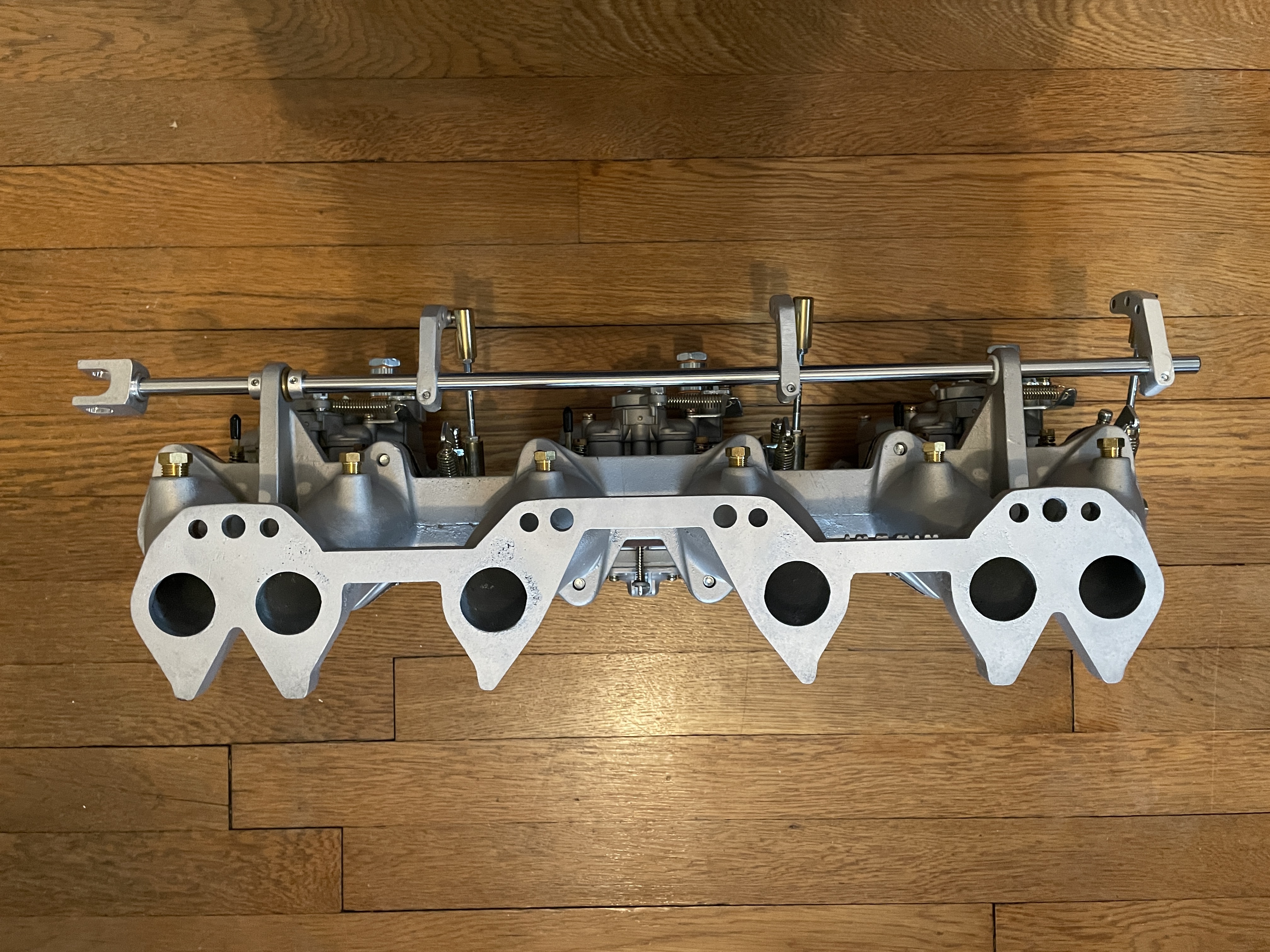

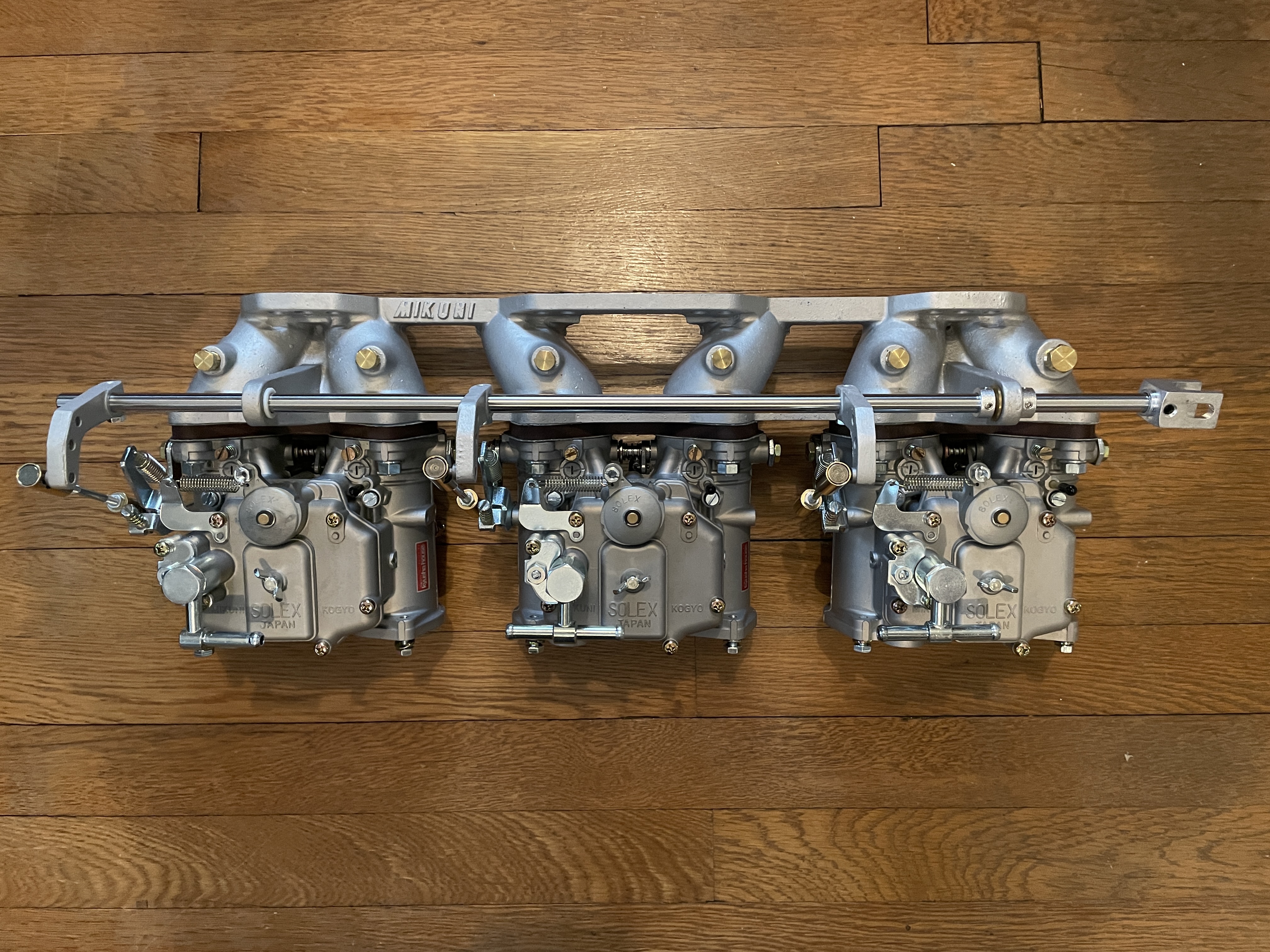

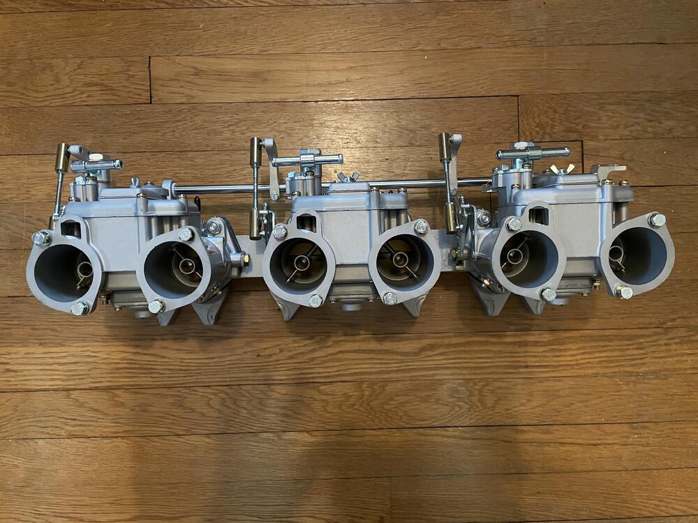

New treasure!
3 Mikuni 44 PHHs. I bought these on Yahoo! Japan back in December. Jesse Streeter helped me get them Stateside and I had them rebuilt by Taka at Kyushu House, who moved to Houston in the middle of the rebuild, hence the delay.
They look fantastic. The manifold also looks pretty good considering it was pretty beet up when I bought it. It had no linkage and needed to be vapor blasted, but there are very few imperfections. Just some putting on the surface that mates to the header gasket.
Can’t wait to get them running.
