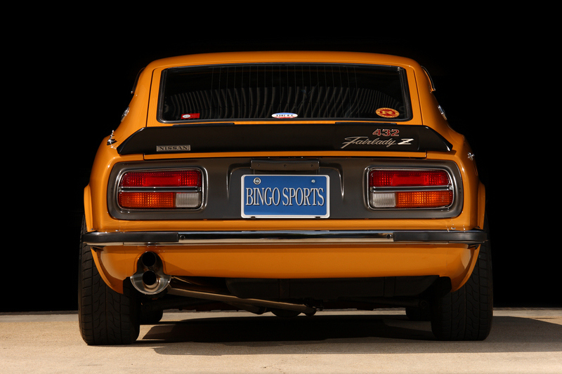

22 hours ago, Matthew Abate said:
Very bold. I like that orange a lot as well. The thing about the original paint is that I always wish it was a little milder. I see pictures of 432s and Zs in yellow, Mexican Orange, Red, and that weird in-between red-orange all over and I have found that I can't land on which one I like best. All I know is that sometimes when I go into my garage I am not 100% in love with the orange that is in my door jambs and inside the engine bay. My ferret picture of an orange Z is this one of the 432R, which feels much mellower than what is on my car (but it's probably just the lighting):
I think the Anrancio Borealis kind of captures that subdued tone better than other things I've looked at , such as the 2017 Nissan Monarch Orange.
I wonder if this is the arse end of the car in your post?  I believe it is and I tried to match it with mine, minus the $175,000. :)
Best pic of mine I could find on my laptop.

I think the image link of your car broke because I'm not seeing it (although I see it in your signature when I use my laptop), but yes that's the same car.
I stumbled upon that series of photographs when I was looking for a 911 project can and it pretty much convinced me there and then to drop the Porsche hunt and go find a Z. I really wanted one when I was a kid, but somehow I totally forgot until I saw this.
