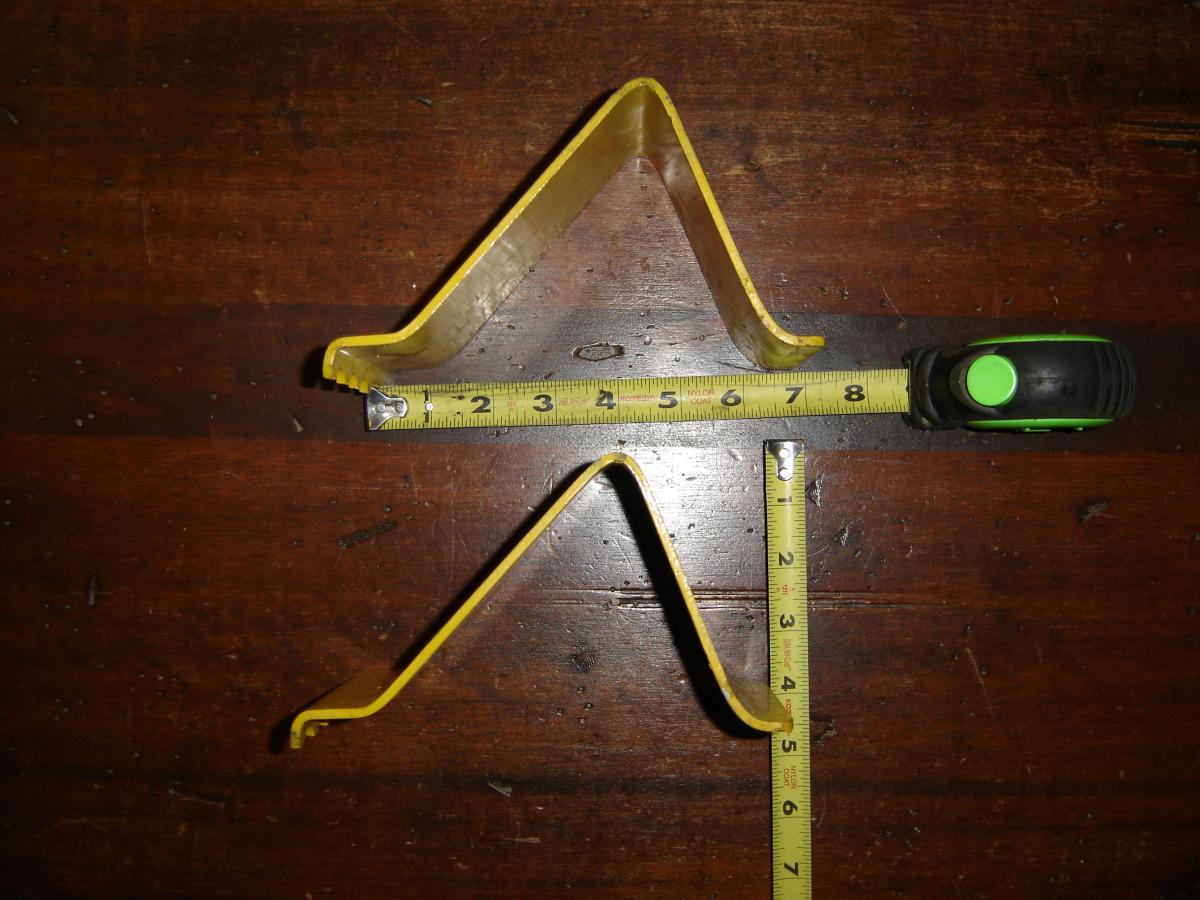

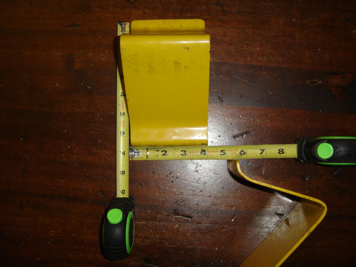

April 18, 201510 yr Author comment_468001 Did some work on the Z today. Cleaned out the interior. No rear carpeting, but the rear deck is very clean. Also found the original tool kit plus two yellow metal wheel choks with "Nissan" on them. Were these part of the tool kit too? I took the old battery to get tested and it was dead dead. Bought a new one. I decided to hook it up so I could test the electrics, etc. As soon as I did, smoke started coming out of the alternator. Obviously I disconnected the battery. All the connections on the alternator appeared to be in place and there were no obvious bare wires or anything. I decided to pull the alternator so I can test it. Since the bottom bolt would be easier to reach from under the car I jacked it up and put it on jack stands. Undid the connectors and loosened the tensioning bolt for the alternator and then went under the car. First thing I noticed is that a lot of the under body rust protection is peeling off. This isn't so bad as it revealed that the primered metal underneath is in good shape except for one spot. It looks like at some point the car went over a curb or something and came down on the passenger side frame rail. It's kinda crushed/bent and the rust protection is scraped off and it's rusted out. The bottom section about 18 inches in length plus a spot towards the front on the inner side. I've never done any welding. Is this something that can be done in place, or will the car need to be up in the air to do? Also with all the under side rust coating coming off, I'm guessing I need to do something about that as well or I'm just asking for trouble in the future right? The other thing I noticed was oil. The entire bottom of the engine back to the transmission is covered in oily gunk. It's obvious the oil pan gasket is completely failed. It looks like you have to remove the suspension cross member to drop the oil pan, am I right? So now I'd like some advice from you guys who have been through all this. I was hoping to just do a rolling restoration as the body is for the most part very sound and I thought rust free. I did not intend to rebuild the engine (at least in the near future) but, going through the electrical system I can see a lot of wiring that's looking pretty sketchy (brittle sheathing, etc) and with an alternator that starts smoking just by having a battery hooked up I'm beginning to wonder if I need to go through all of that as well. It looks like my dad did his own installation of the alarm and stereo and I don't really like how he tapped into the wiring for power, etc. Do I just say screw it and strip the car down completely and do a full restoration knowing it'll be several years before it's back on the road or am I making too much of this stuff? I appreciate your advice. Link to comment https://www.classiczcars.com/forums/topic/51311-my-new-z/?&page=4#findComment-468001 Share on other sites More sharing options...
April 18, 201510 yr comment_468010 Odds are good(bad) that you connected the battery backward. Nissan did not use red and black like everyone else did. Follow the cables to be sure which is ground and which is positive. The cross member is actually what the engine is mounted on. Can't be removed without removng the engine too. You can get the oil pan off with everything in place though, it might take a couple of tricks. There are tons of parts for sale from people who decided to just tear the car apart and rebuild it from scratch. One year of looking at boxes of parts and you won't even remember it used to be a car. Link to comment https://www.classiczcars.com/forums/topic/51311-my-new-z/?&page=4#findComment-468010 Share on other sites More sharing options...

April 19, 201510 yr comment_468034 My '72 240s have the yellow 1 piece wheel chocks. '77 280 has orange collapsible ones. Link to comment https://www.classiczcars.com/forums/topic/51311-my-new-z/?&page=4#findComment-468034 Share on other sites More sharing options...
April 19, 201510 yr Author comment_468037 My '72 240s have the yellow 1 piece wheel chocks. '77 280 has orange collapsible ones. Yep! That's them. Link to comment https://www.classiczcars.com/forums/topic/51311-my-new-z/?&page=4#findComment-468037 Share on other sites More sharing options...
