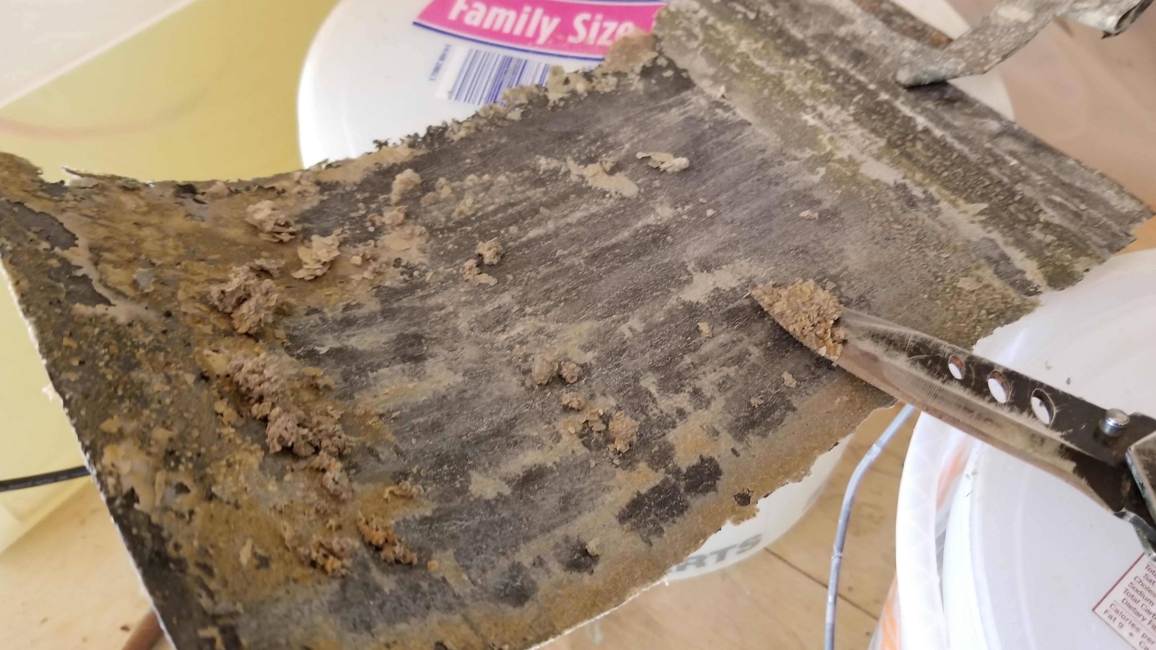

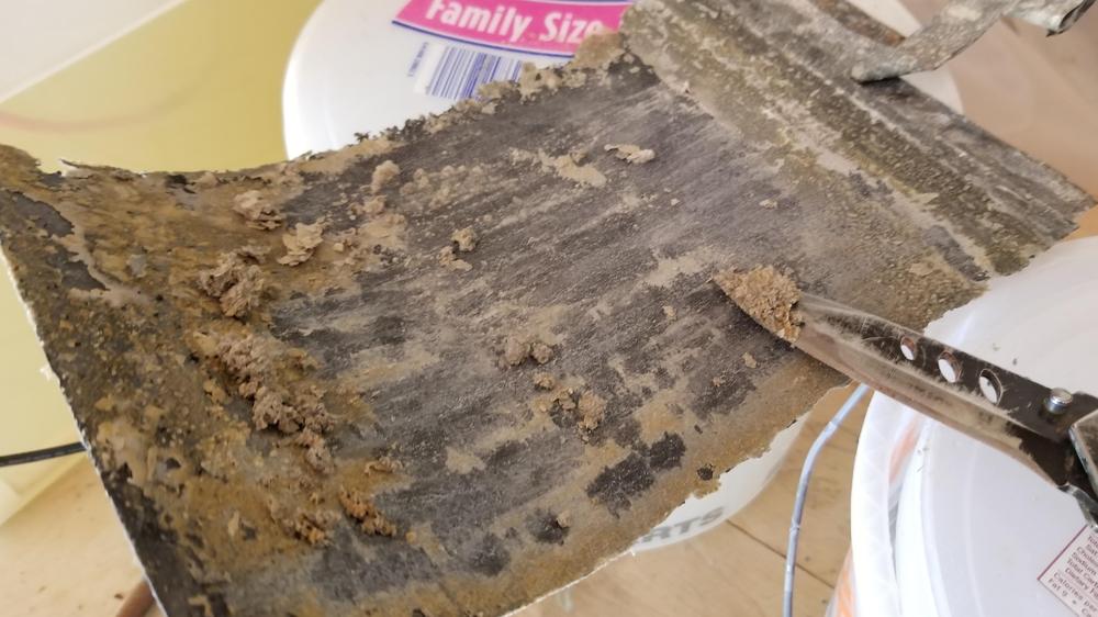

I knew I could filter through charcoal. One of the problems with doing that is it removes all the brightener. As I have been getting good results up until the other day I didn't want to dump all the brightener. It is also a little expensive. I did have some funk on my plates the other day that could have been organics too. So I may need to just go ahead and filter it...
Use polypropylene to filter it mechanically.
You can get the stuff at a dollar store: Cheap hazmat suits are 100% polypropylene.
Anode Filter Bags are polypropylene as well.
Edited by 240260280
I filtered it through a stack of paper towels last week. That helped a lot with the clarity. I also have a 5 micron filter I can use but it's a pain. The real issue is organics in the solution. You get "drag out" out of the other tanks that can contaminate the solutions. Carbon would remove all of that at a very fine level.
Isn't that a character from an old Woody Allen movie?
I plated last weekend and got much better results. Not perfect but pretty close
I had some build up on my plates because they got left in the tank all week
Scraped them a little bit. Sprayed them down and plated with them. I have been running a lot higher current densities lately. I don't know if that is a circuit issue, a solution issue or what, but I am still getting the results I want. So I am just working with it. When my plating is dull I just add some current, which is what I think was wrong with the batch from the other weekend. These plates are almost shot. They are paper thin and getting ragged on the edges.
