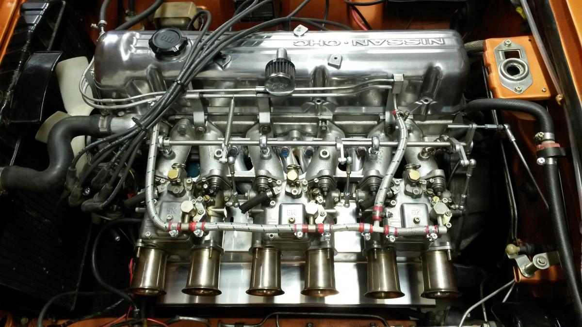

Here is picture of the whole engine bay if that helps figuring out.
post-19126-0-14933300-1431319505_thumb.j
If I am looking at this right your manifold does not have the balance tube connecting all the throats. Correct? If that is the case disconnect the booster off of the #6 intake and plug the port. See if that helps. If the booster is badly blown it may be causing the lack of draw on #6
