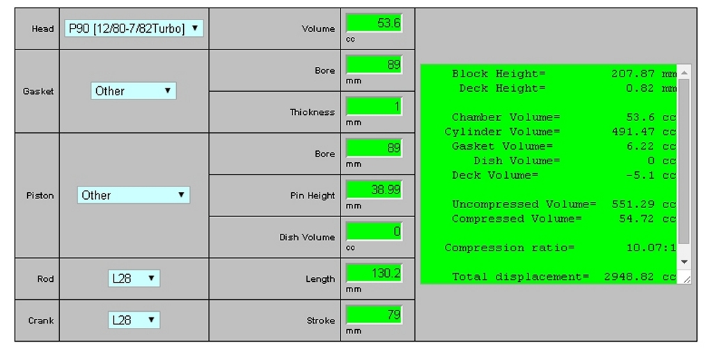

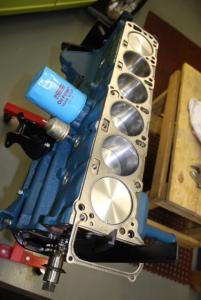

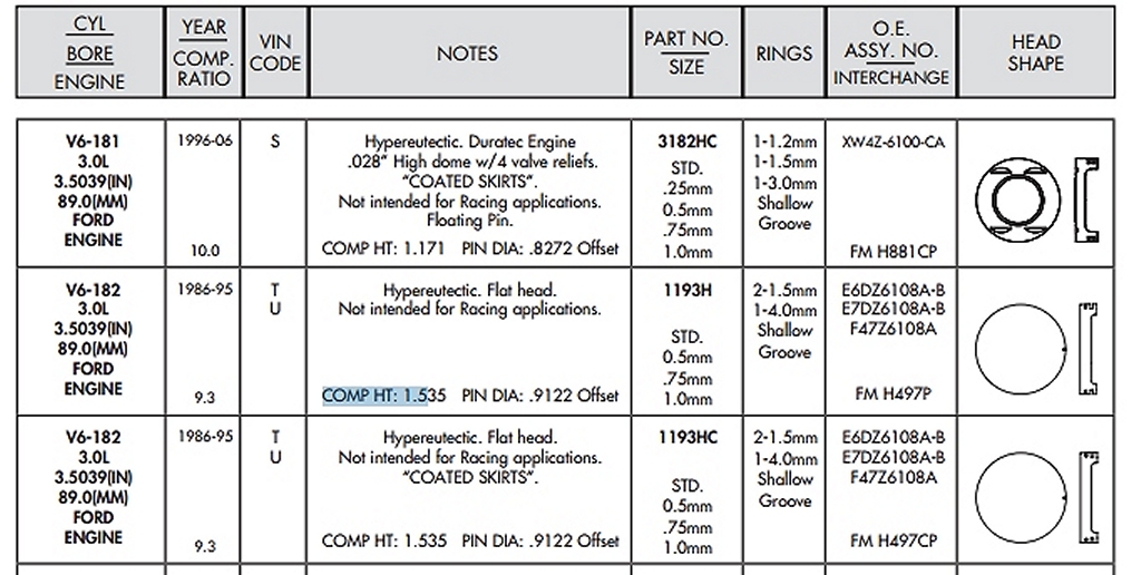

I think I found something:
Piston pin is ~ 1.2mm bigger in diameter so rods will need boring or existing pin sleeved.
The piston bore is 89mm.
The compression height/pin height is 38.99mm
Piston to Head clearance is ~0.32mm so it needs another .07mm off the pistons.
It should have a good squish if I can find a 1mm X 89mm gasket.
