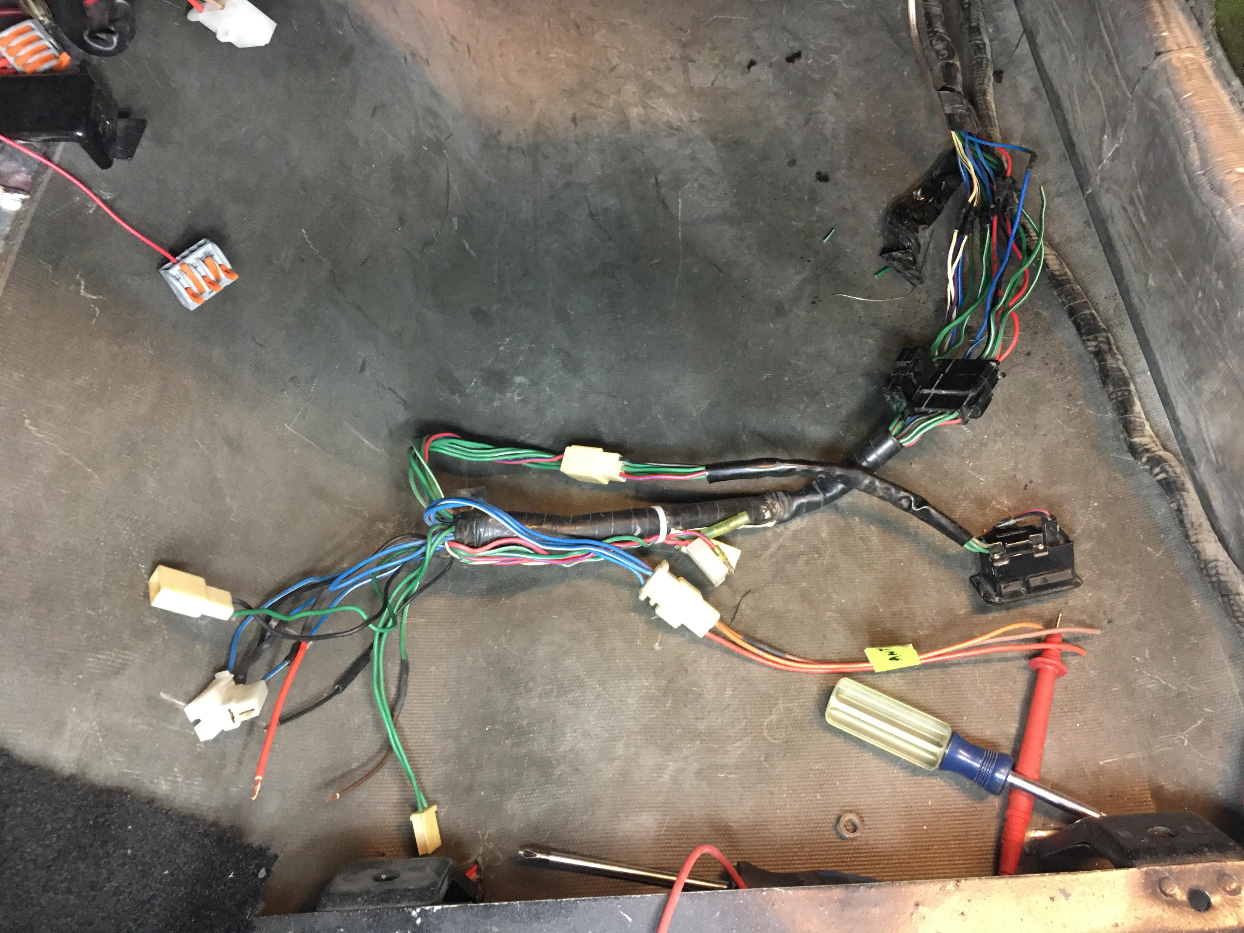

So after 6 hours of wiring and pin checking, I have a functioning set of flashers! Hazards and indicators work now! Amazing what a 75 harness connected to a 74 sub harness and a 76 flasher button Can do once you figure out all the wiring changes...
@zKars Here’s another one of those things that are similar yet not alike! Oh, and I found the fog light connections. They are on the 74 sub harness. Unfortunately, they do not pin out to the 75 harness and go nowhere.

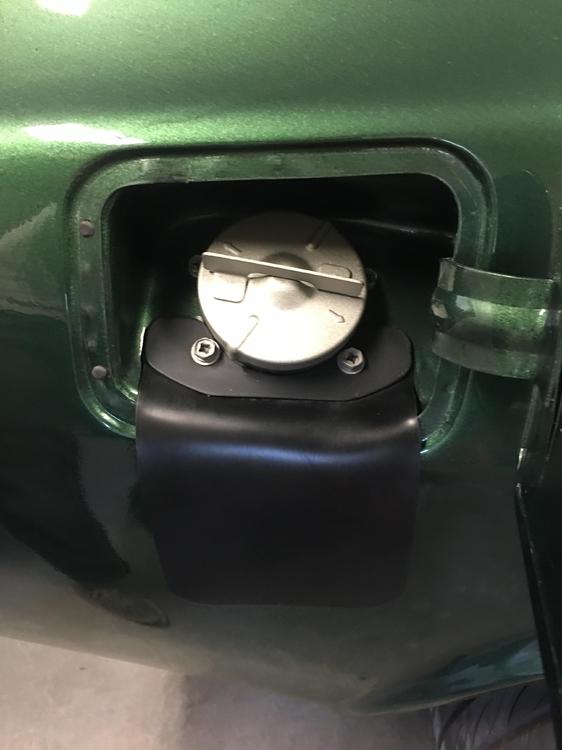

Details matter... added the gas flap and the rubber bumpers!

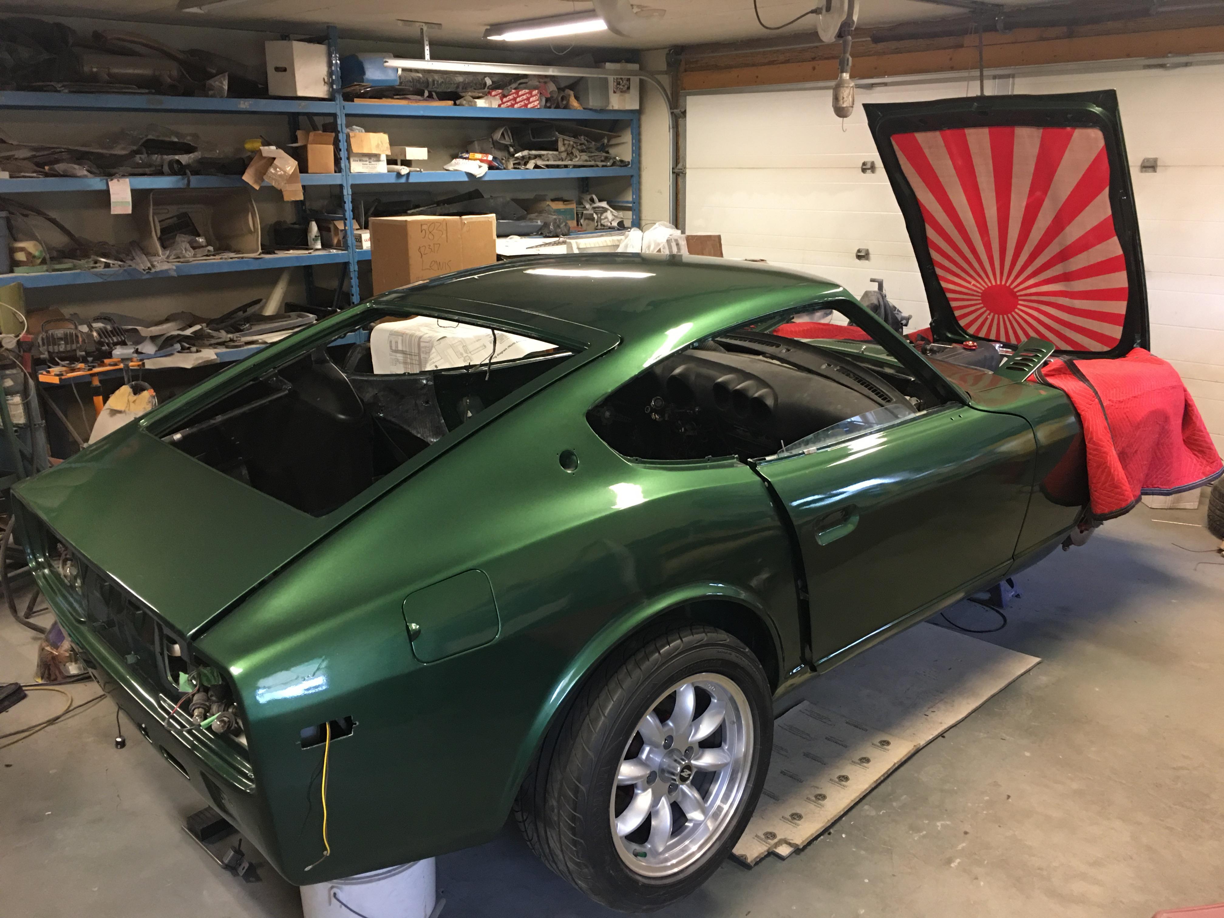

Oh look! Progress.....well, there is progress but you can’t see much of it outside the car...!

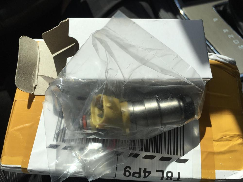

Excited to receive the new supra 3.0 larger injectors today! Then disappointed to realize I forgot I will need new plugs for them and have to redo the fuel injection harness... ?

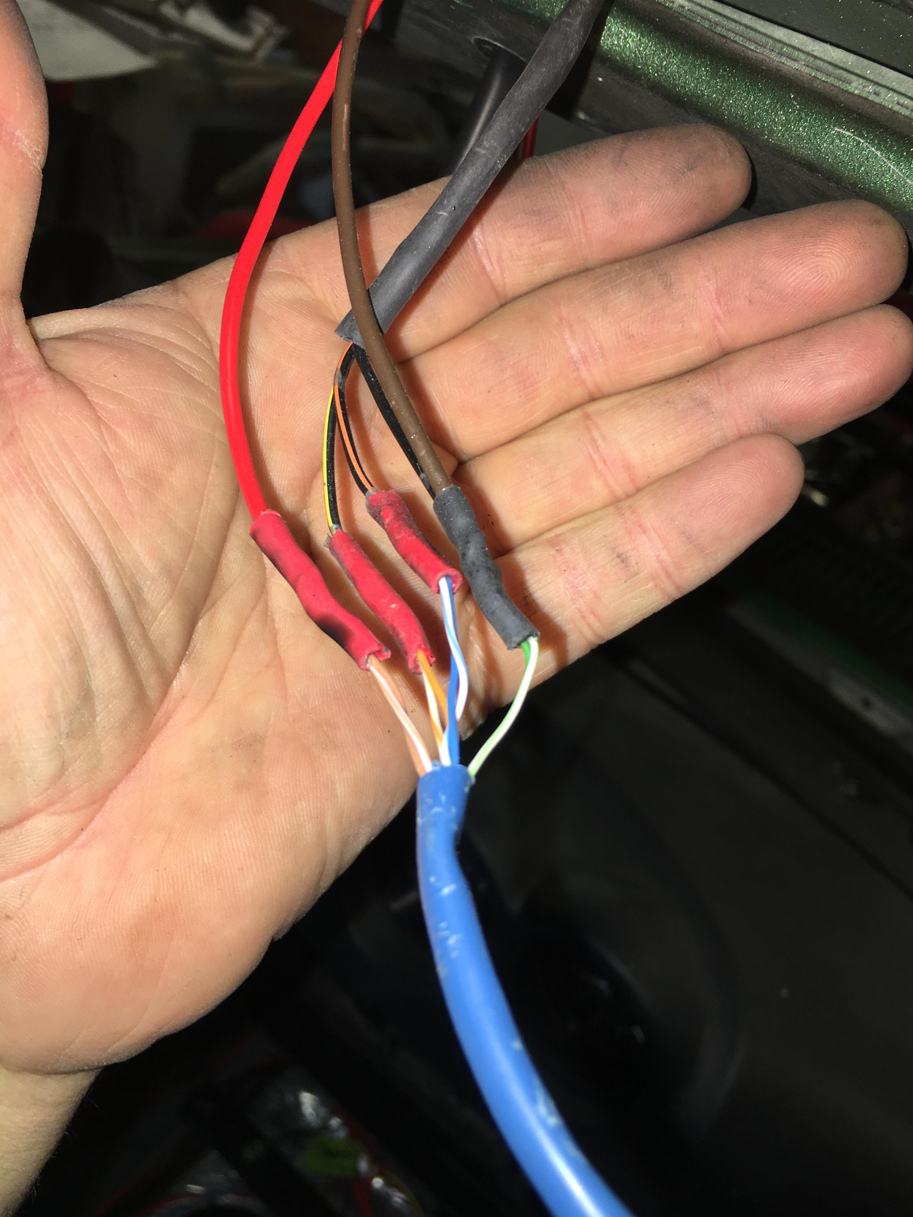

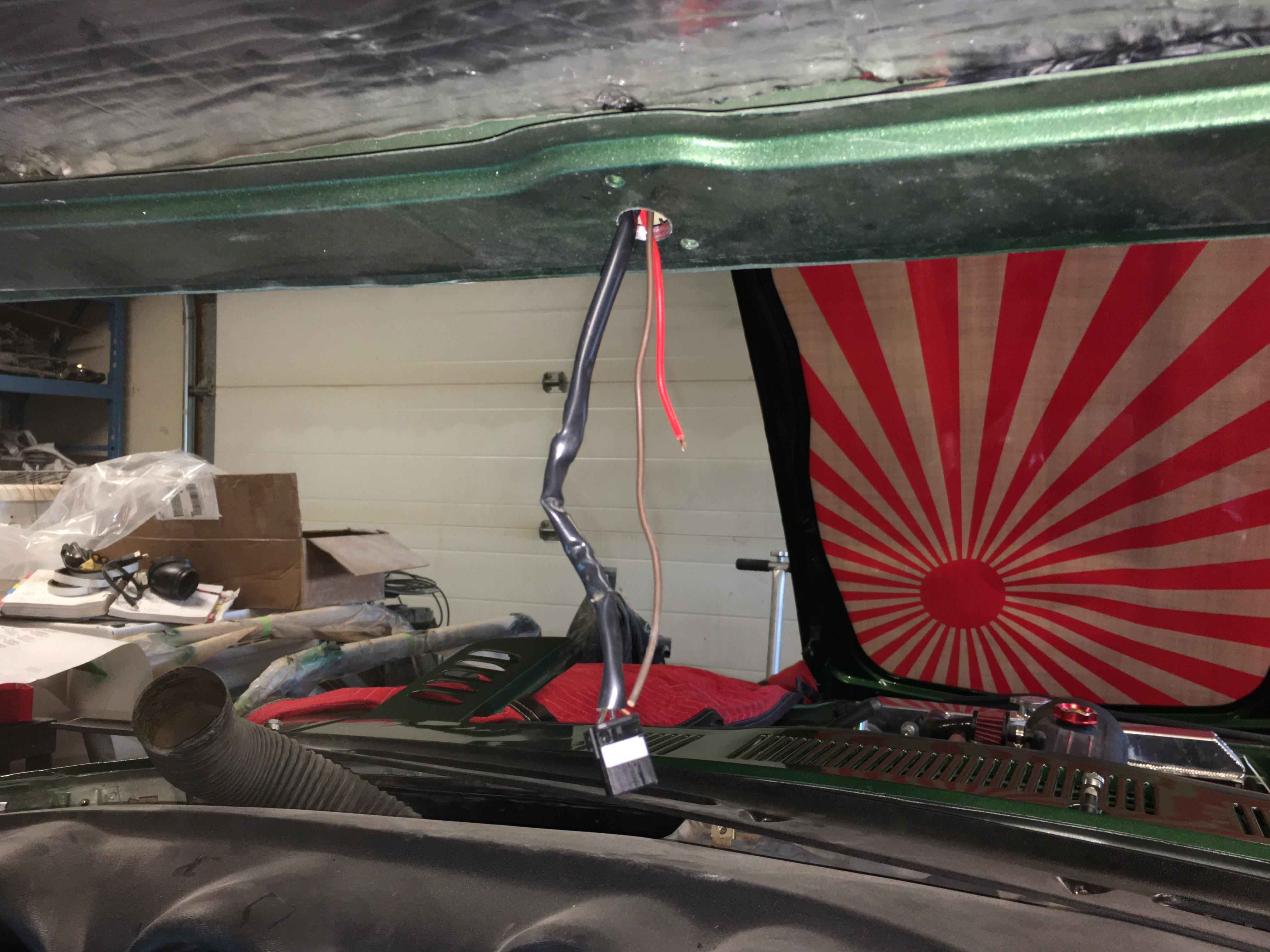

Sometimes good ideas create so much work! I am installing a Gentex Homelink mirror in the car and will probably run a radar detector too, sooo..... How hard could this be? Well, the channel for the mirror mount is double walled and tight tolerances to run five wires... separate fused hot leads, one for Homelink always on, two for accessory power and two ground leads. I used Cat 5 wiring in twisted pairs, one pair for each circuit and a common ground. Redundant wires to increase signal integrity and strength.
