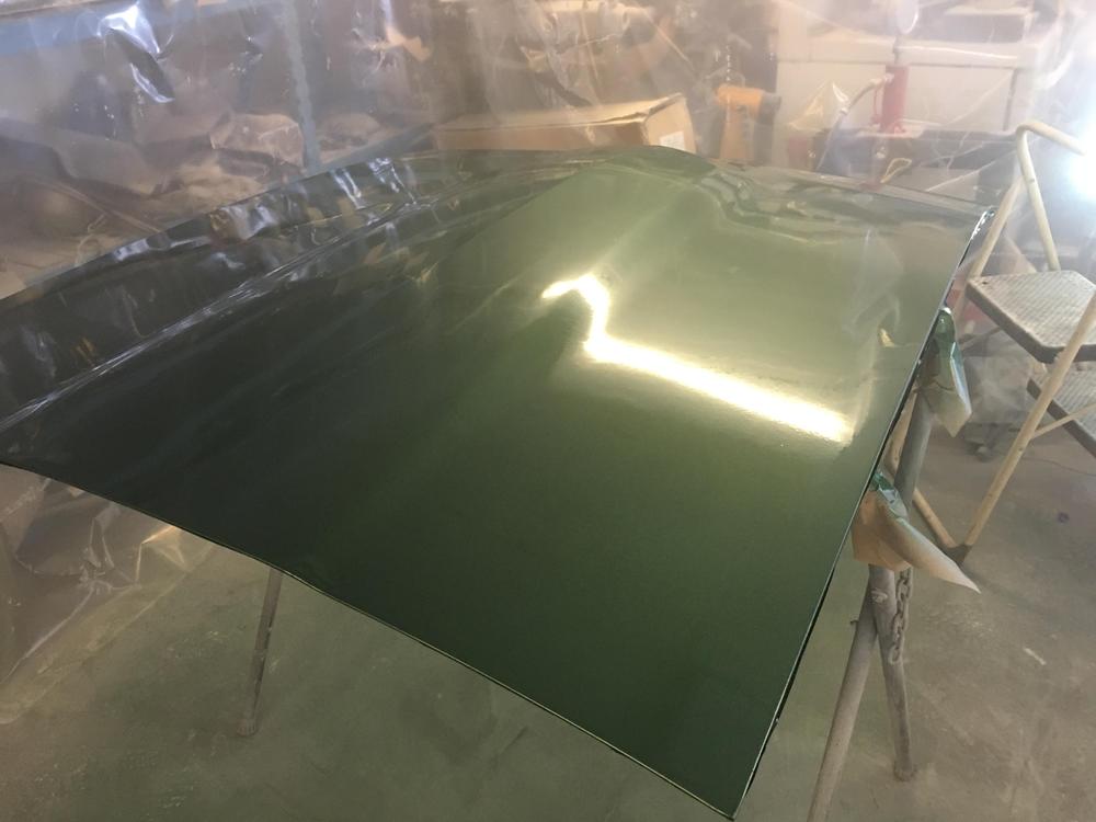

So! Went to work this morning and started the base coat!
First things first, a bunny suit!
Then I washed down the floor with warm water to quell any dust bunnies.

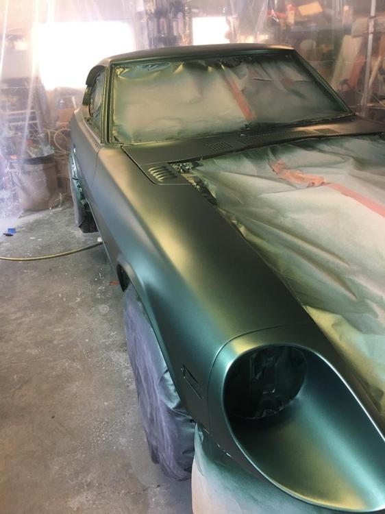

Then I walked around the car and hood with a tack rag, checking for any dust etc.

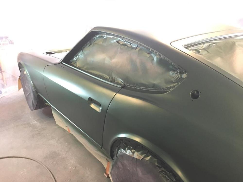

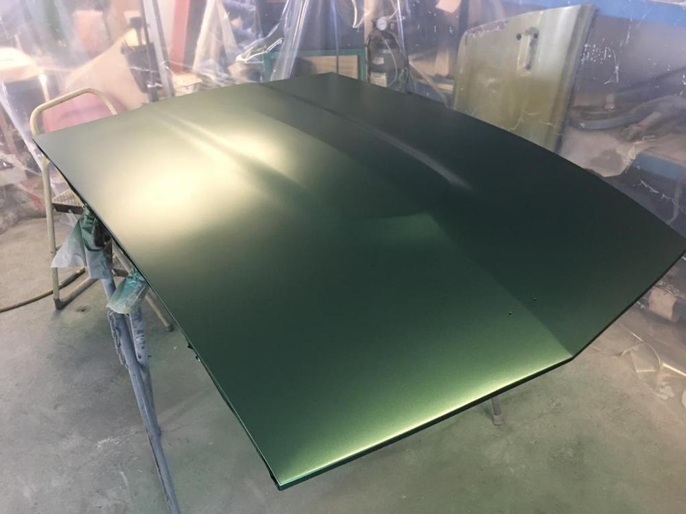

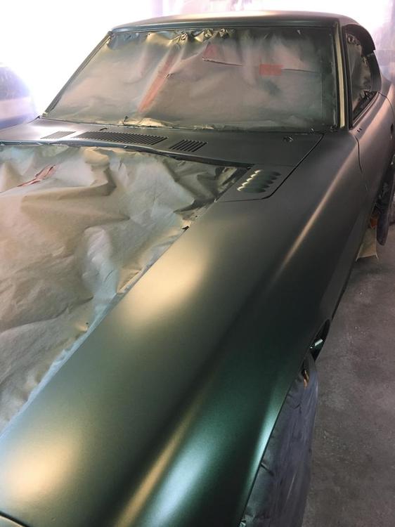

Then on to the paint! First coat, still wet.

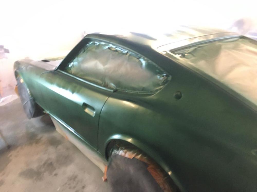

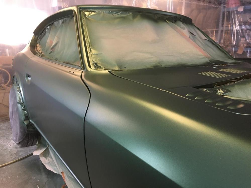

Second coat:

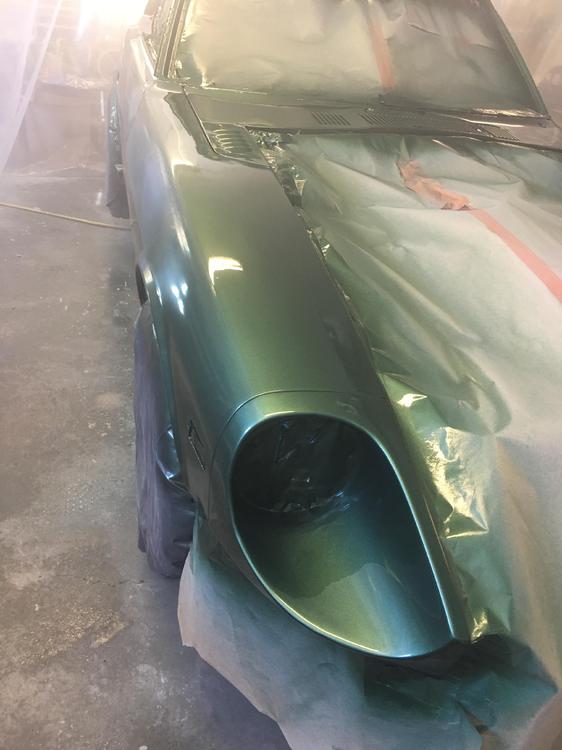

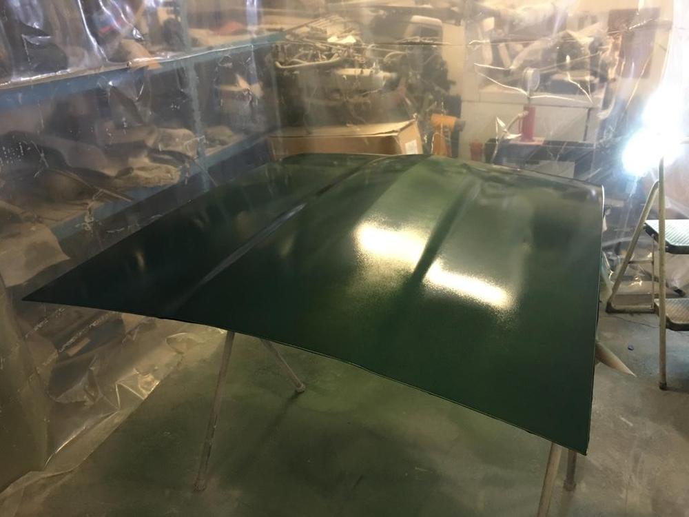

And third and final coat of water based British Racing Green!

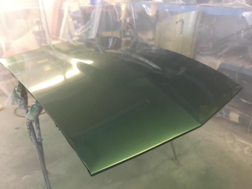

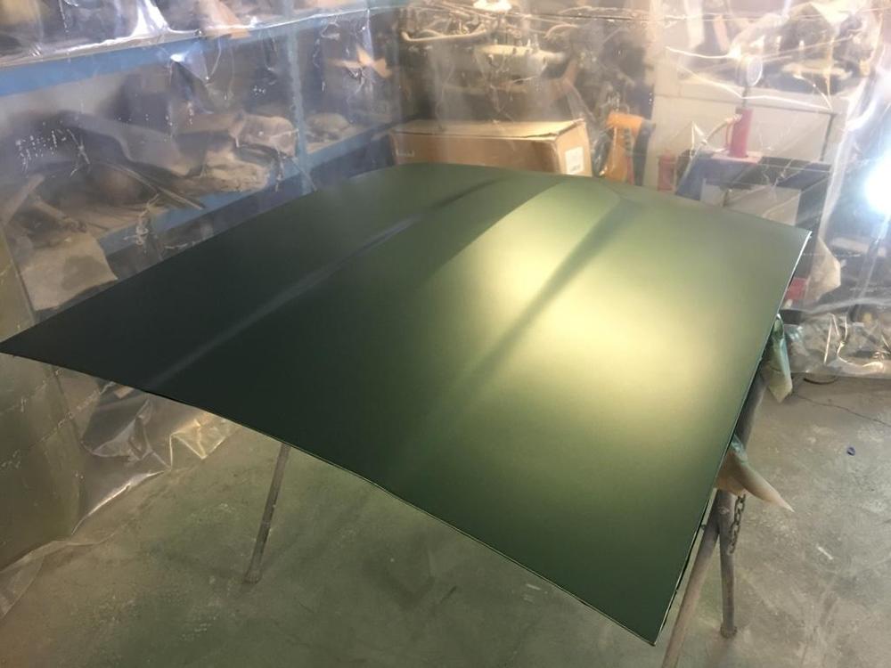

Next up: Clearcoat!

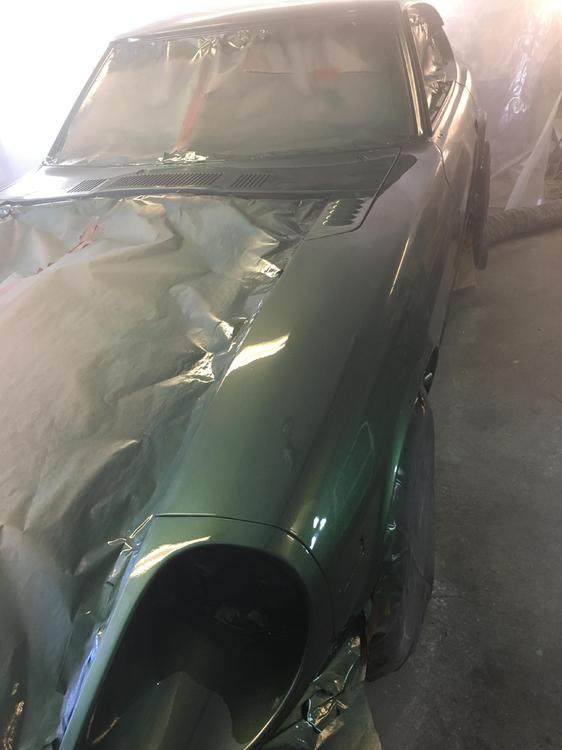

Three coats of European 5 Star Clearcoat later, I am out of the shop, letting it cure.
I saw a couple sags from a heavy hand, but nothing too major. I can clean those up in the cut and buff. Overall very little trash and everything looks good. Hard to tell in the shop lighting but I am happy. Done!!!
