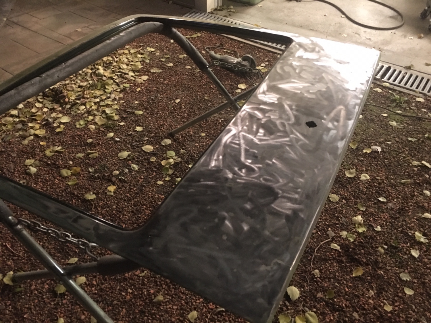

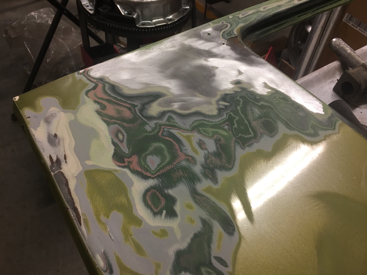

SO hopefully with the change of seasons I am going to be able to move into more of the restoration phase of SASSZ. Last night I pulled the hatch glass and hardware and started prepping the hatch for stripping. I used the new Eastwood green "brush" paint remover on the grinder and was dismayed to see the amount of paint, primer and bondo on the hatch. After some aggressive stripping I was even more dismayed to see the left bottom quarter of the hatch completely oil-canned.... Not thrilled to have to deal with that but c'est la vie!

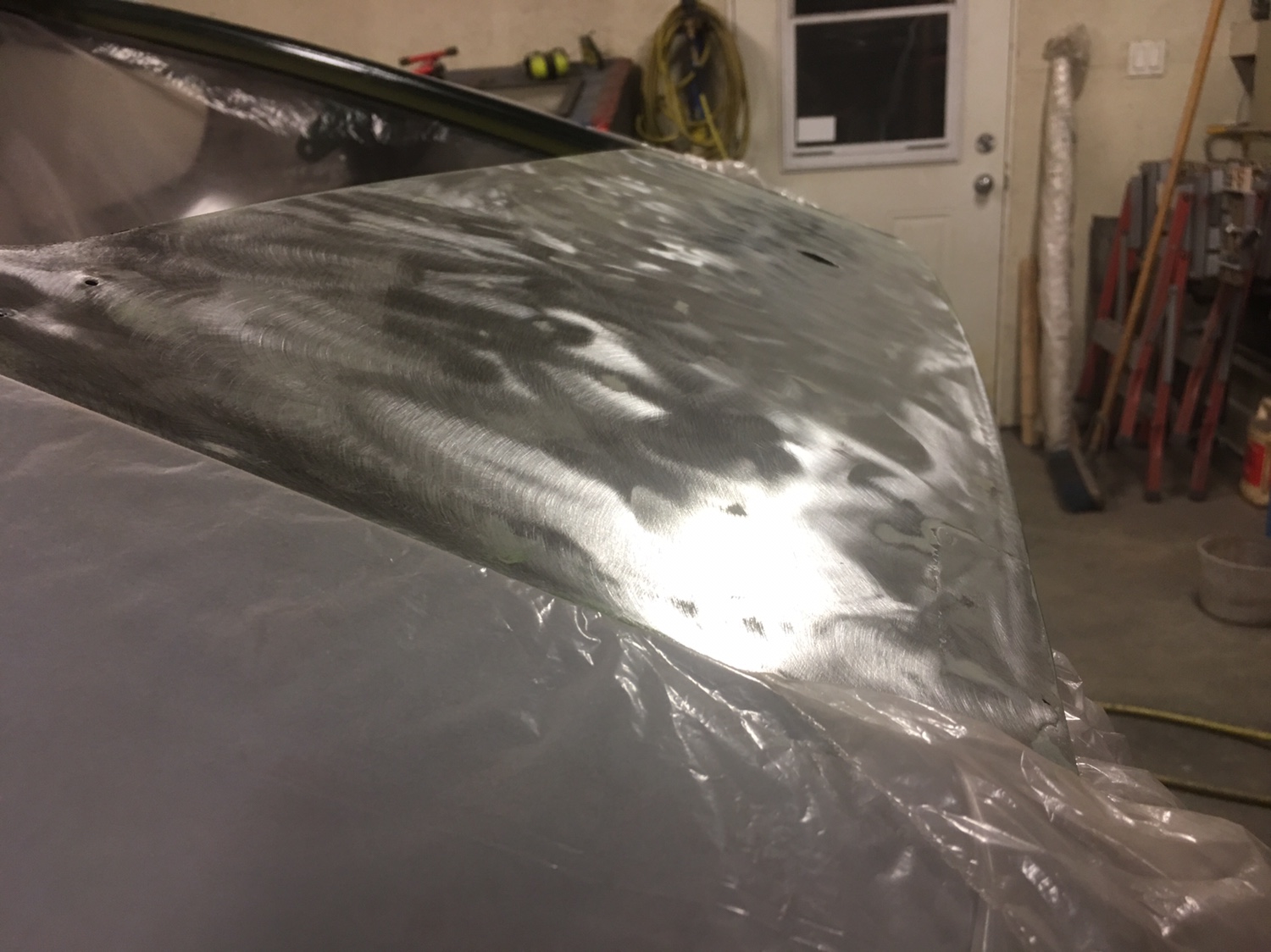

The rear hatch pictures show how the PO had applied massive dumps of bondo to fill the oil canning. Glad to know it wasn’t my stripping wheel. Still going to be a challenge to flatten this out properly.

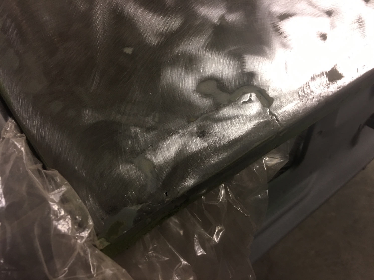

Mostly cleaned off but thankfully most of the damage is the bottom left corner. Looks like I will be ordering that shrinking wheel soon...

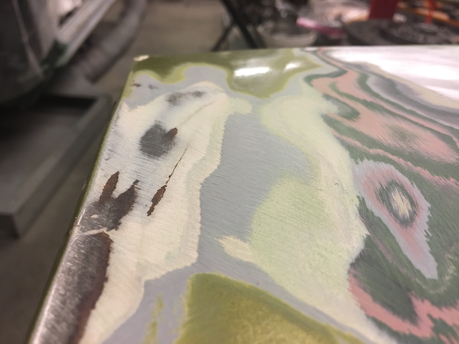

Looks pretty good with a little hammer and dolly work but it is still oil canned. The PO had done a small patch weld in the corner that probably started the tension issues in the metal.
