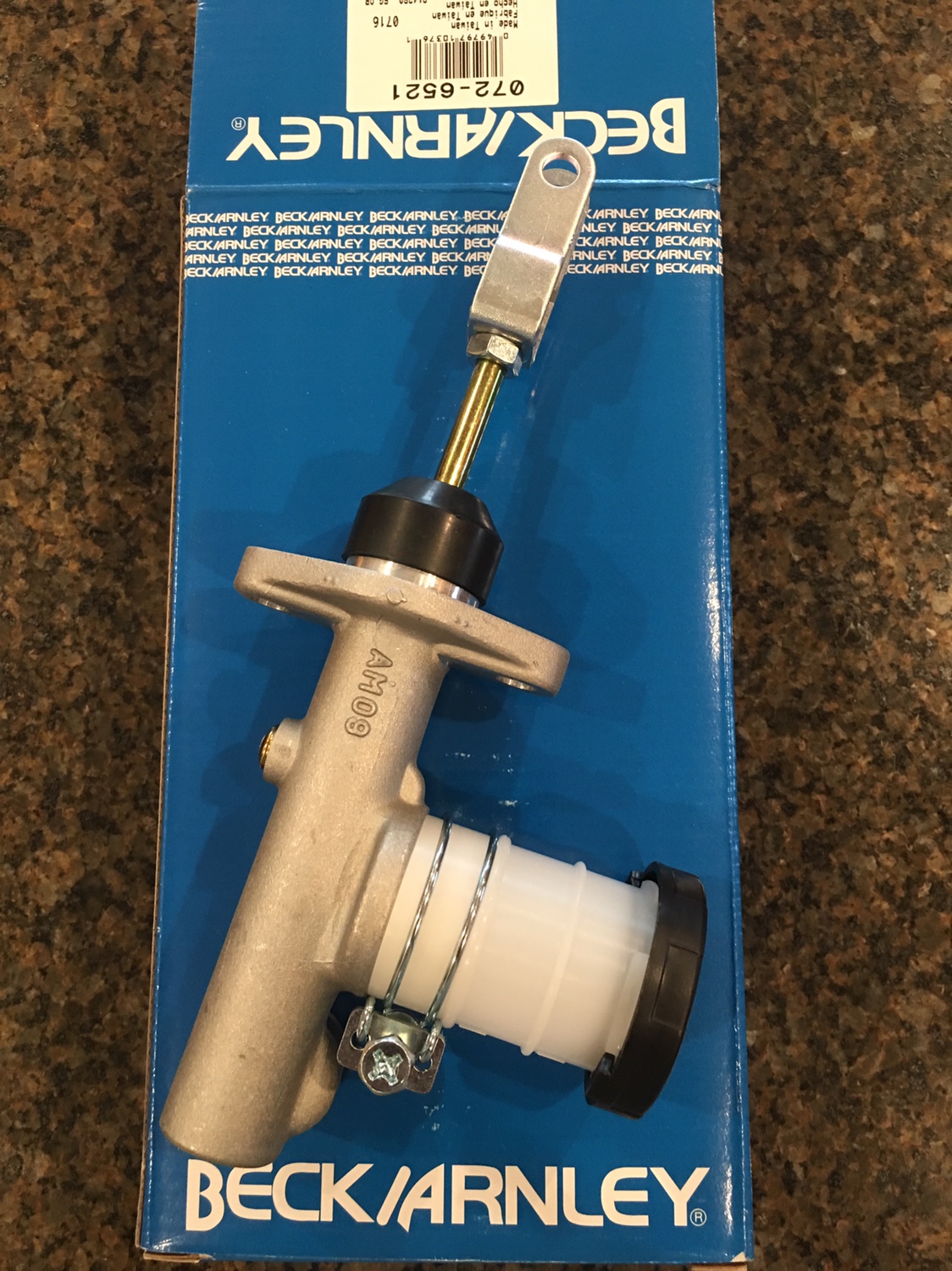

Yes, I will be getting a 15/16 280ZX master, probably from Arizona Z Car with the brake order. I am leaving the old 7/8 cylinder on there now for safety sake. No need to let dirt and dust in.

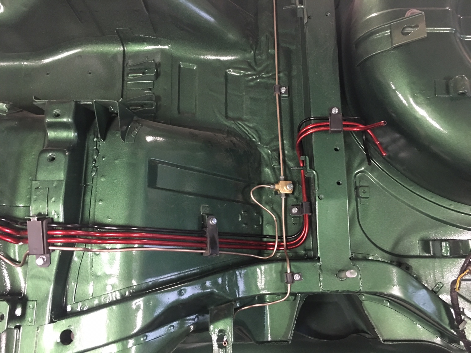

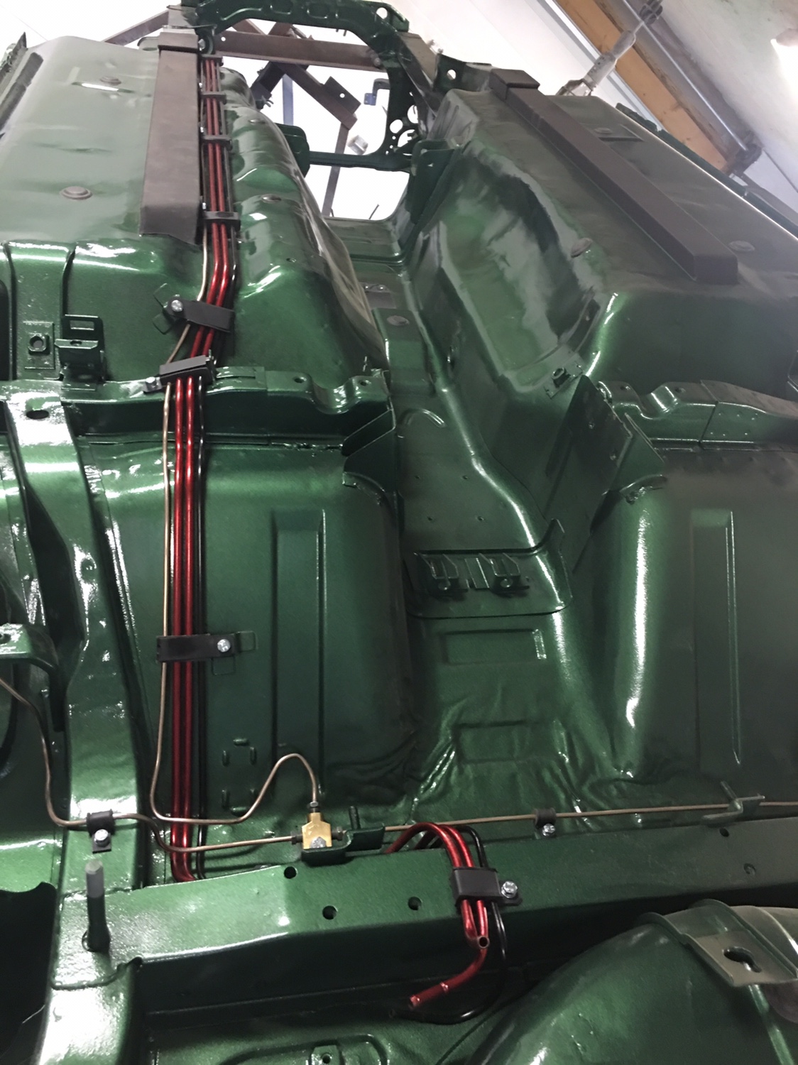

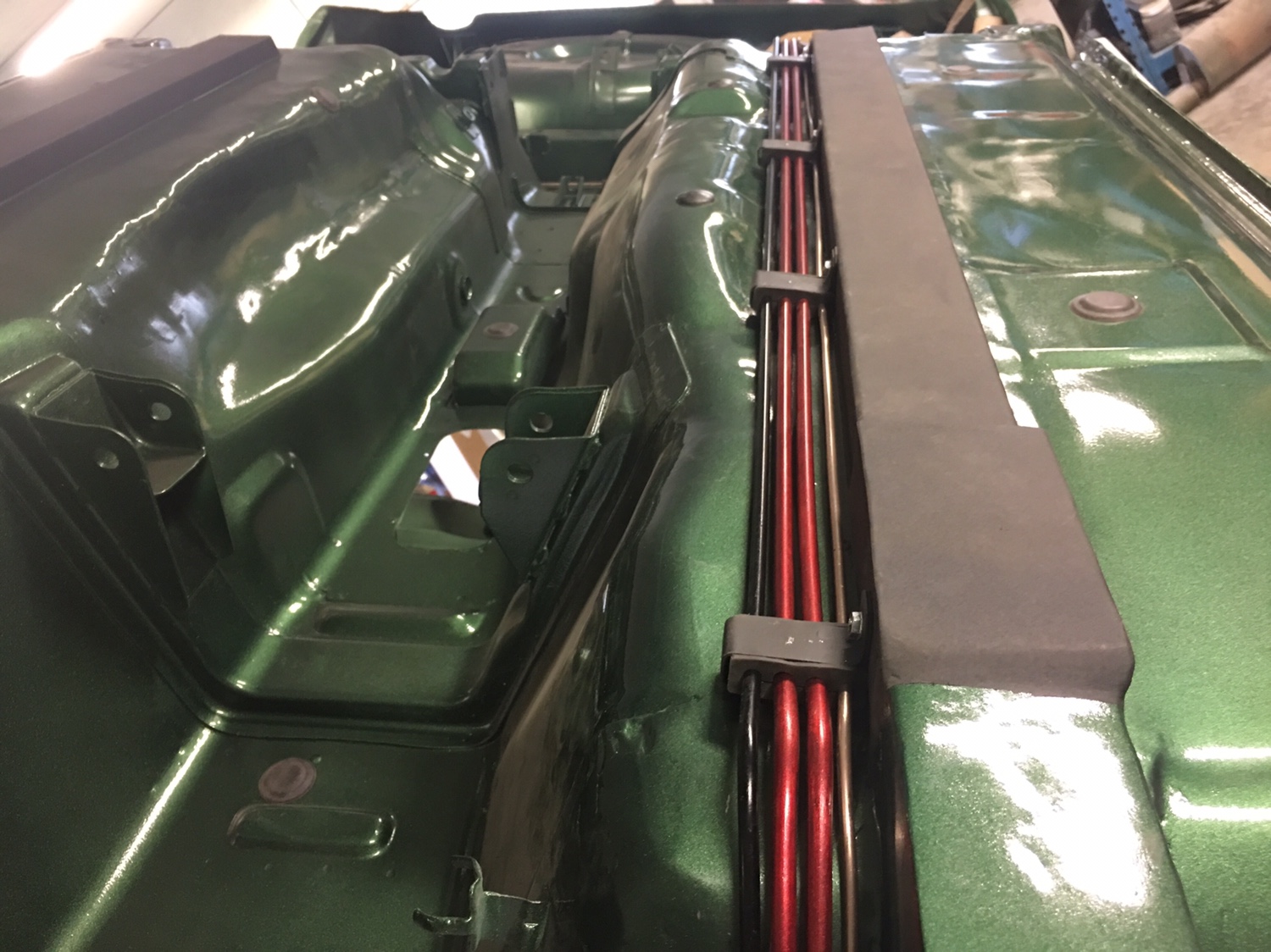

So the purists may not like this, but I wanted something unique.
The bare lines are for brake fluid, the red lines are for fuel and the black line is vapour return.
This was a huge pain in the butt to get lines bent and shaped just right. Flaring was a cinch (thanks Chris!) but the heavy lines were a chore.
Just the engine bay, clutch and front brakes to make up and then the lines are complete.
I like it Mark. Nissan should of raised the bar and done all Z car lines like yours! It makes good common sense and looks great too!

Thanks everyone! I found a really nice metallic red that matches the anodized AN fittings in the engine compartment. The brake hats and coilover suspension all match the same red too.
