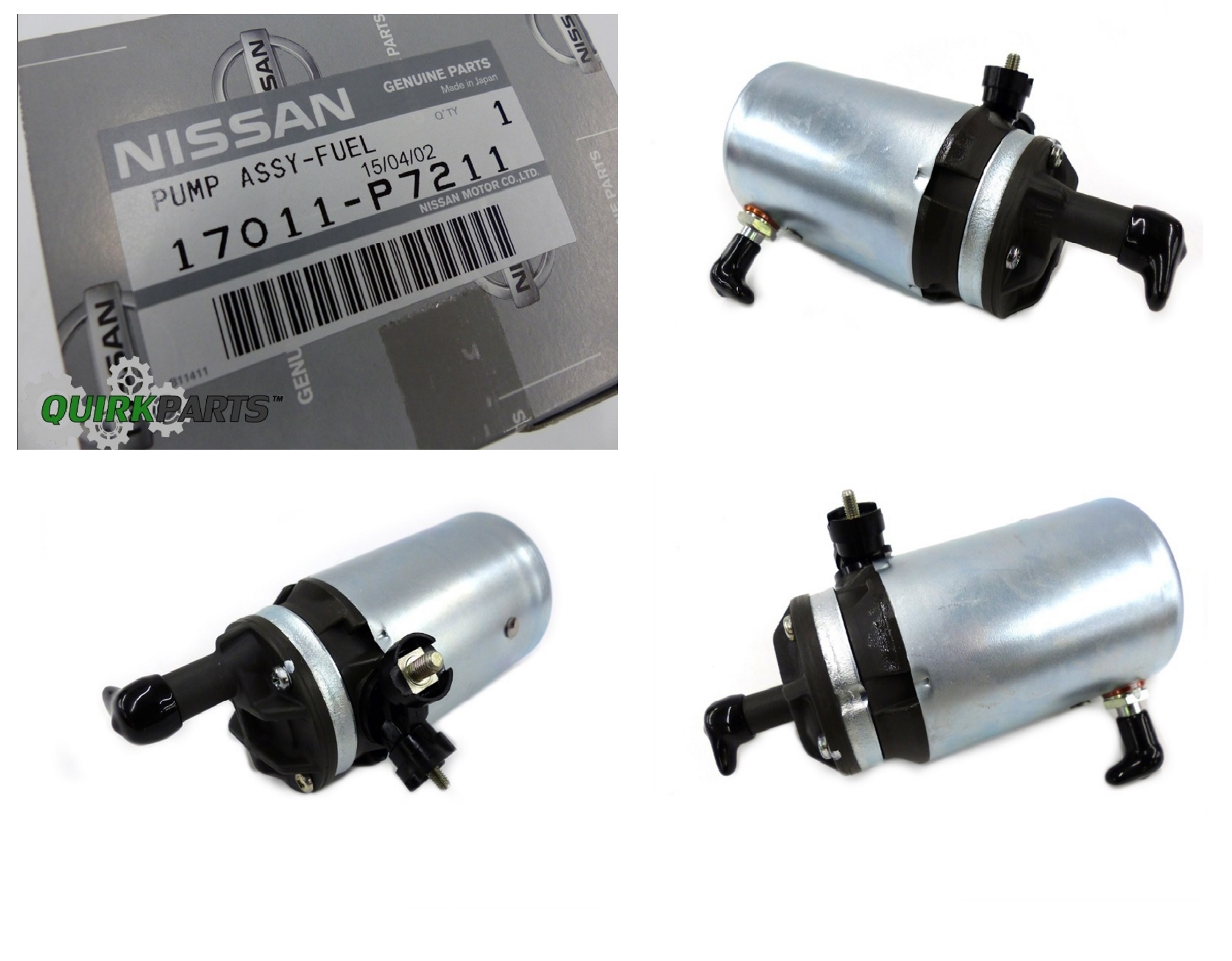

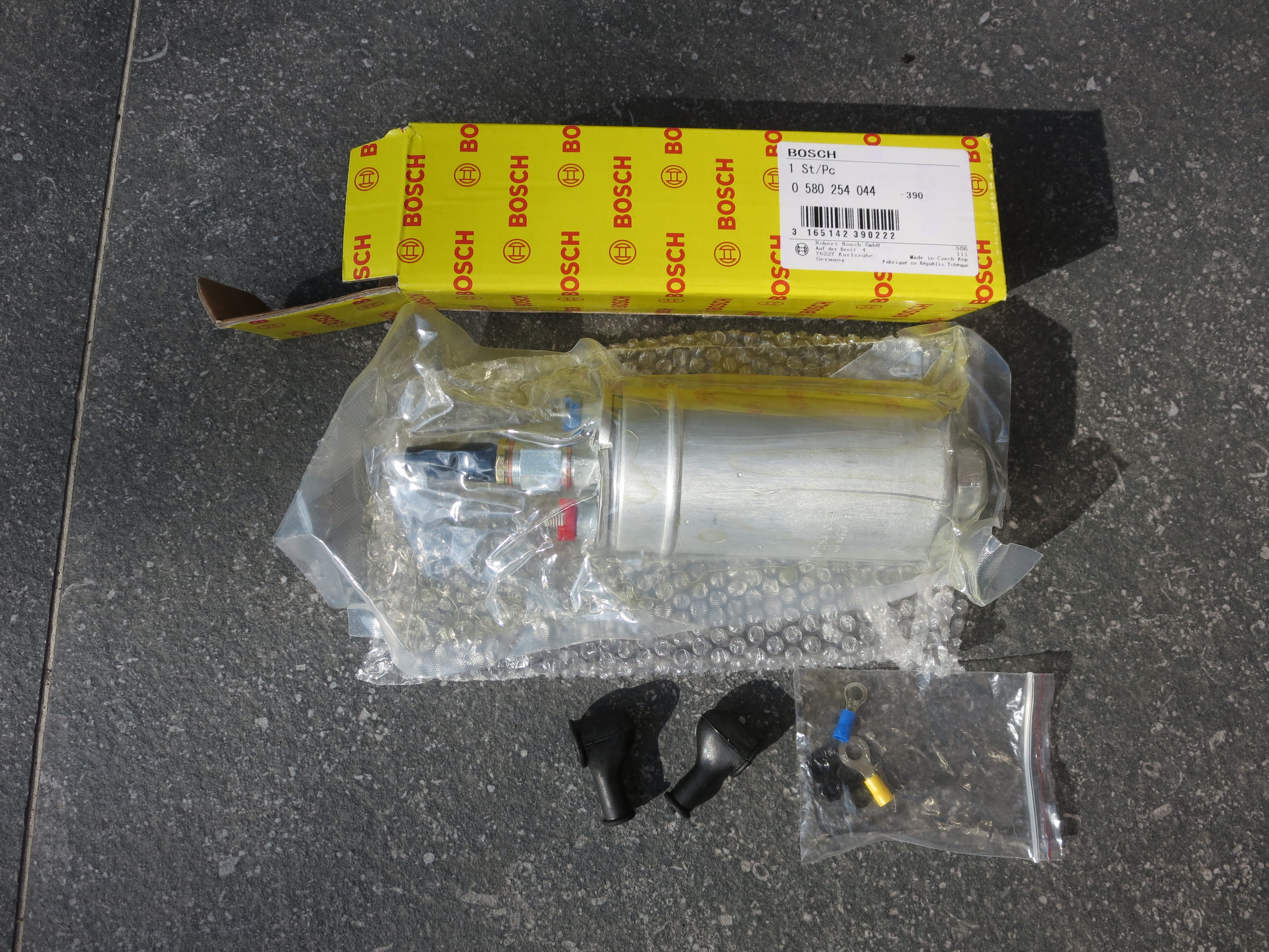

There is a nissan dealer on ebay with NOS units for $249. Manufacturing date on the box is April 2002. That is about where Bosch stopped making them. If you were to go with the original style, go with the Nissan NOS pump. Its a Bosch and from all the pumps I have seem the bosch version seems to wear less and perform better.
http://www.nissanpartsdeal.com/parts/nissan-fuel-pump~17011-p7211.html
http://www.ebay.com/itm/280Z-FUEL-PUMP-OEM-GENUINE-NISSAN-1975-1978-/331780616477?hash=item4d3faa711d:m:mP3RS9OVuY8fOIguL5bsLpQ&vxp=mtr
I went with the alternative Bosch pump. Thats the one Bosch suggests as a replacement since my good performing original Bosch pump was leaking at the house o-ring. I don't know the Delphi unit except its more expensive than the bosch replacement I bought so I would go with the bosch unit.
