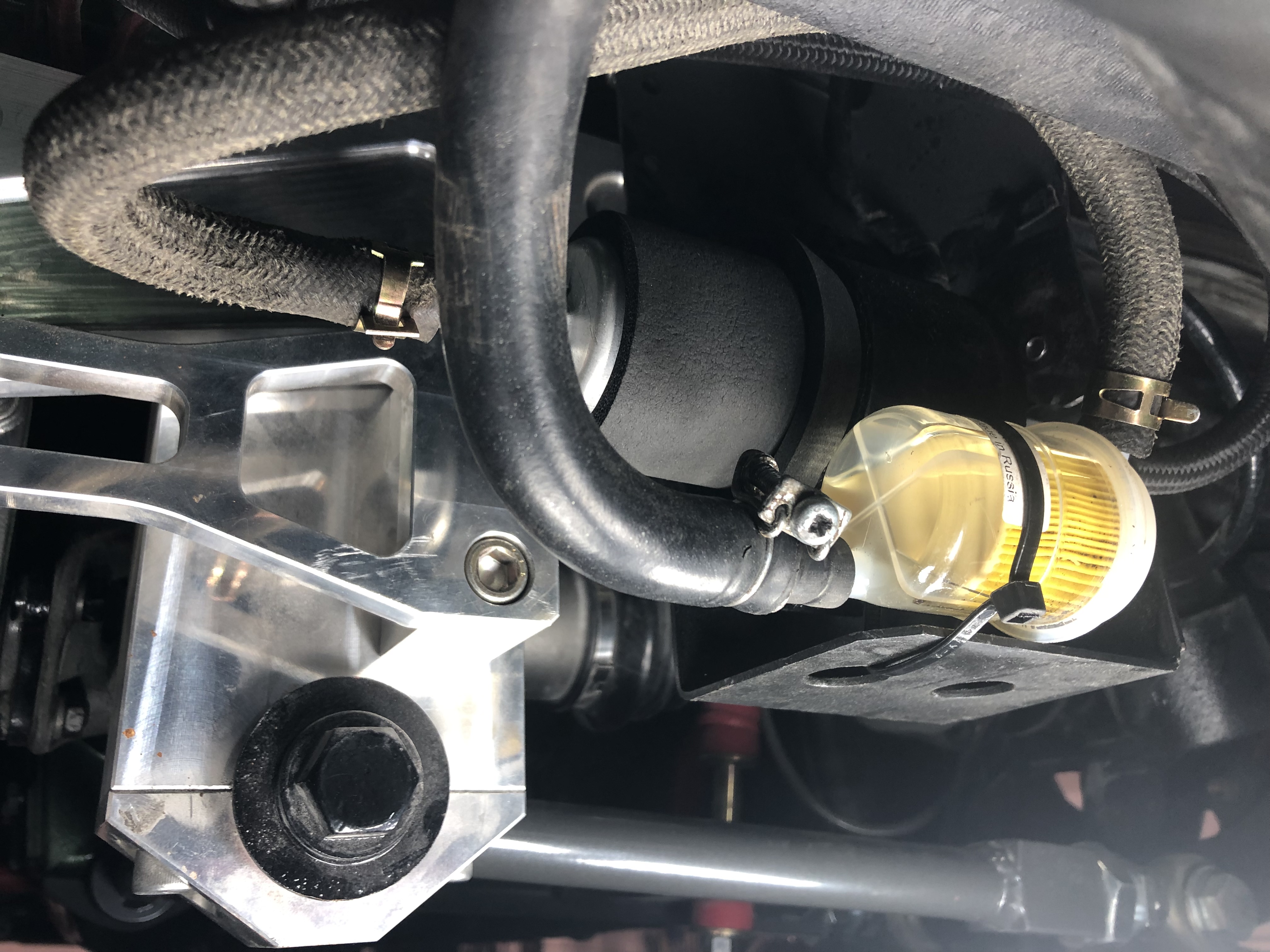

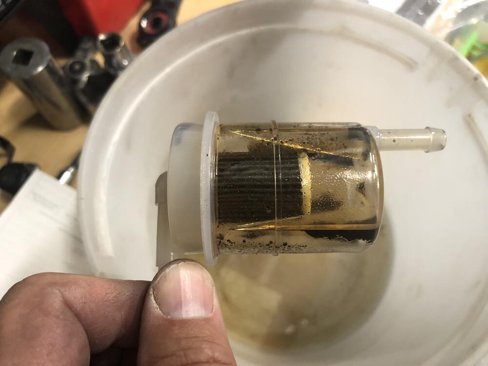

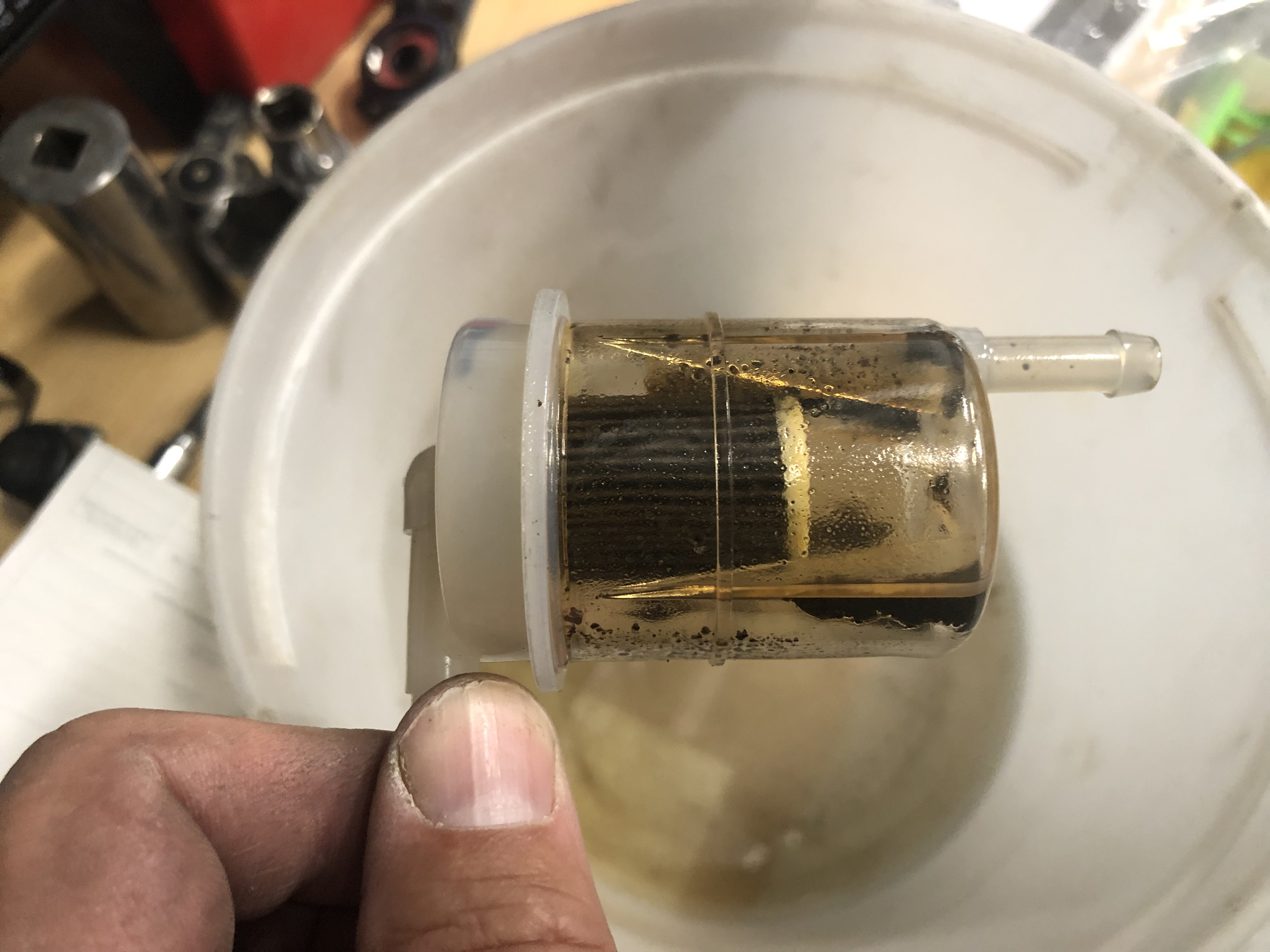

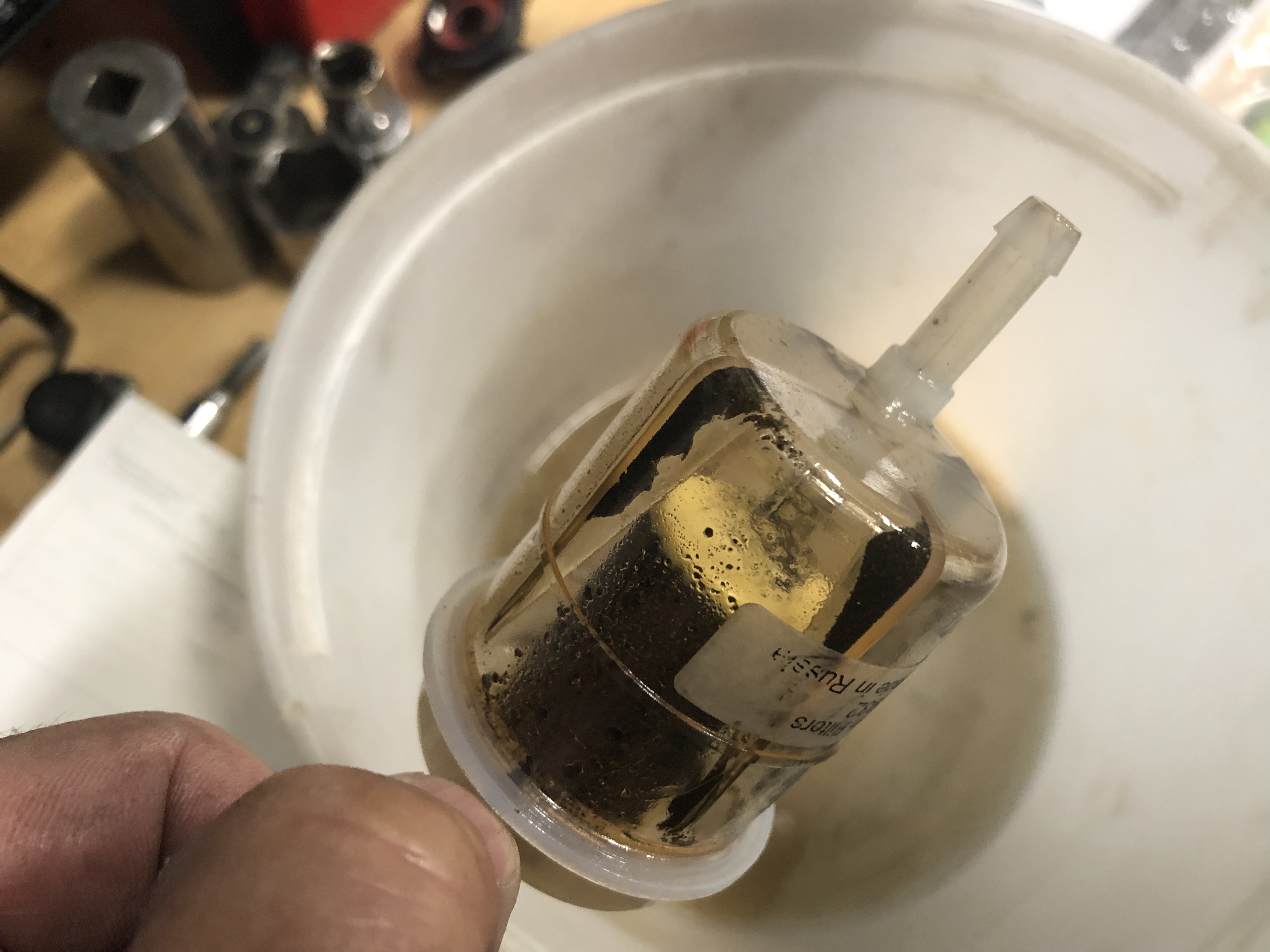

Finally got around to a few things this week. Changed the fuel filter before the pump… only about two hours of driving on it and it was filthy! New lines and a completely sanitized and coated tank meant I must have missed cleaning the inside of the rubber fuel filler neck. Only place for the crud to have come from.
after that, I drove it around a bit tonight and 5th gear works perfect with new shifter and welded shaft! Yay!

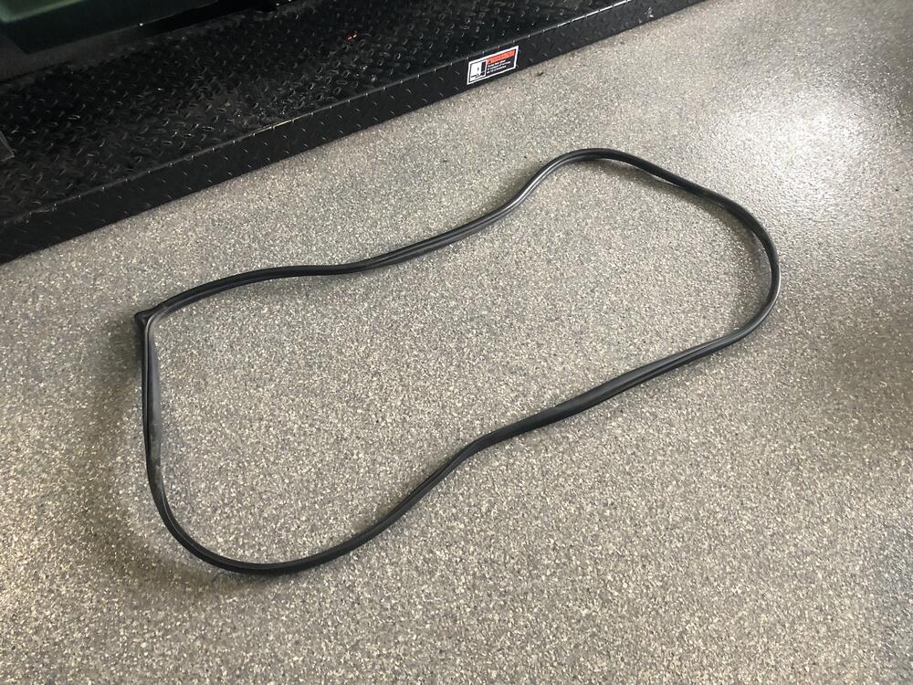

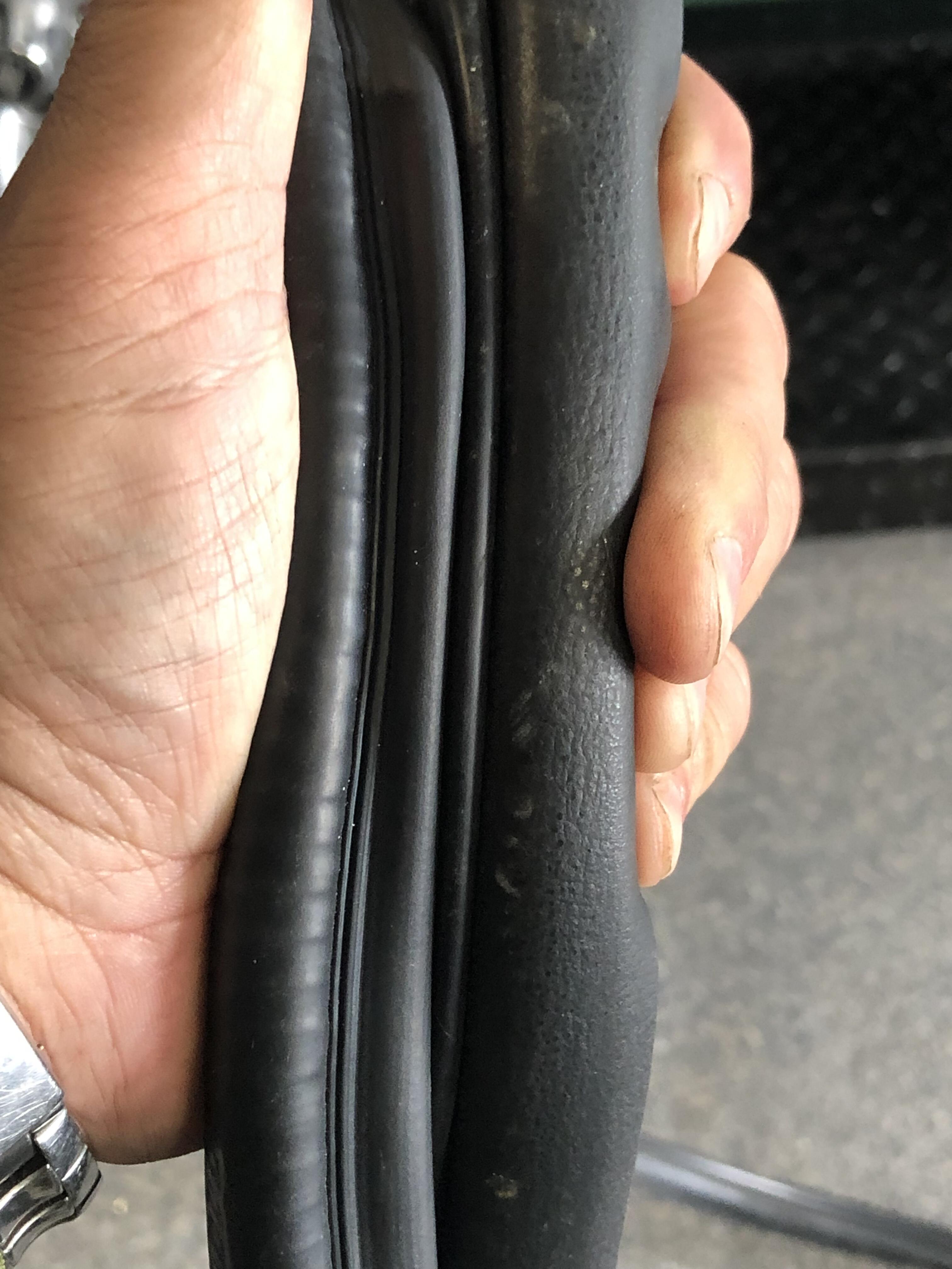

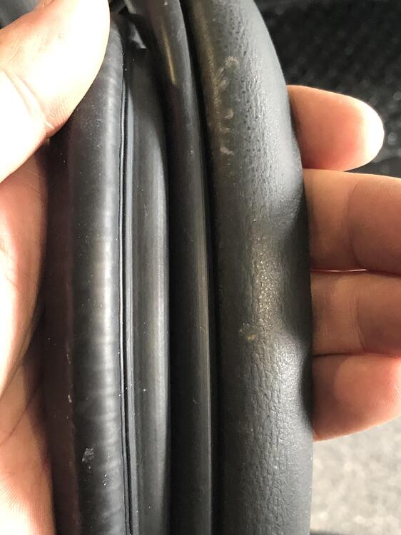

Here we have the famous Kia Sportage seal on the right and the MSA Z Store door seal on the left.  The first picture is relaxed normal size. The second and third pictures are compressed. Note the difference in the compression rate of the KIA seal… much tighter. This is why they make great replacements for the stock seal!

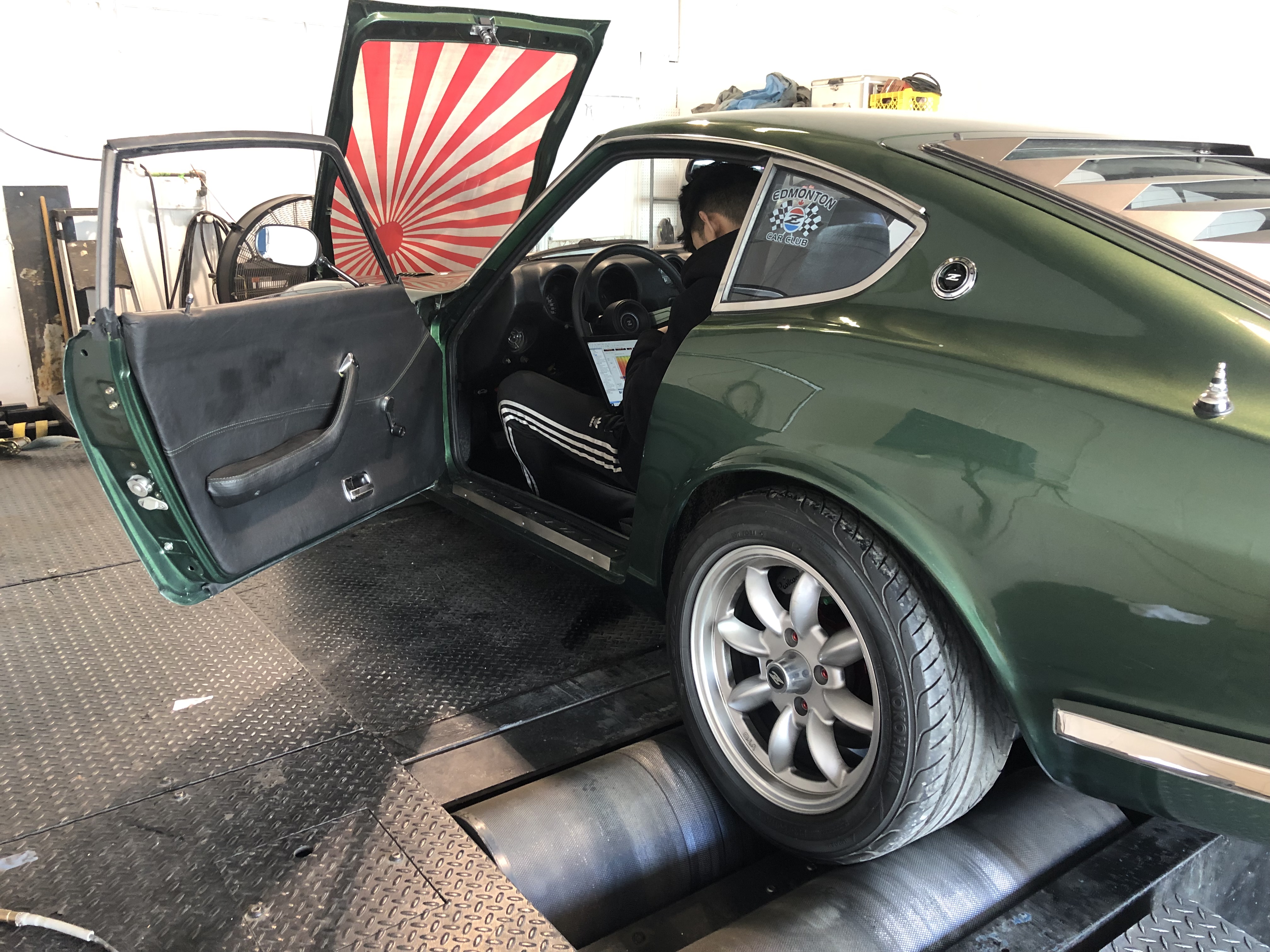

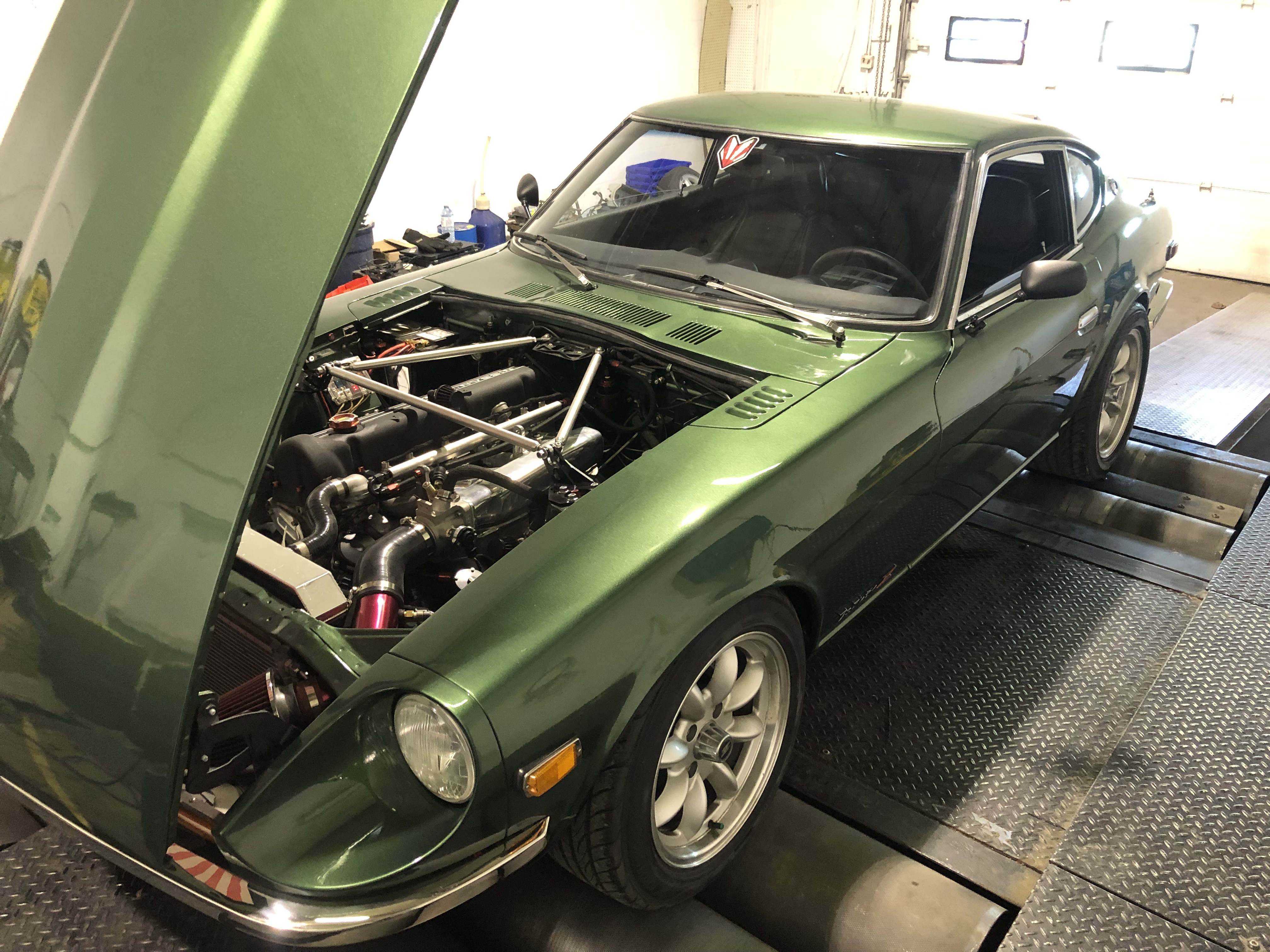

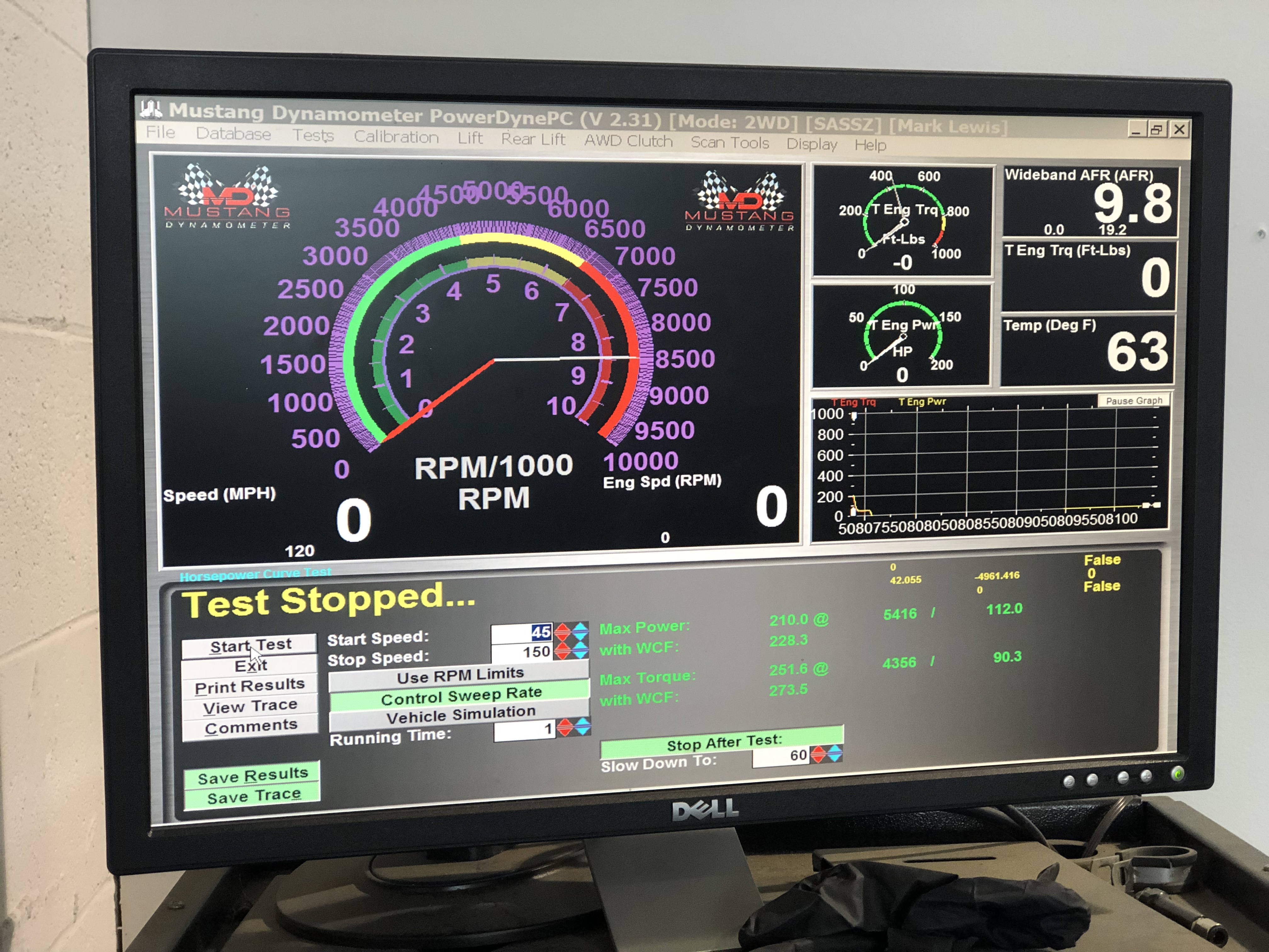

Well, dyno day came and the car did quite well. Despite a dead O2 sensor that needed replacing, my tuner Matt did a stellar job clearing up the fuel tables and working his magic making the car run smooth and idle properly.
The mustang dyno came in at 210 HP and 252 TQ, but the load sensor was flaky and I’m not really sure where we ended up. We spent 8 hours tuning and each better than the last. I feel like a true number would be closer to 250 hp and 290 TQ. With a bit of mechanical advance on the timing chain, it might make a little better power under 4000 rpm. I will redyno in the spring. Overall the car runs great now.
