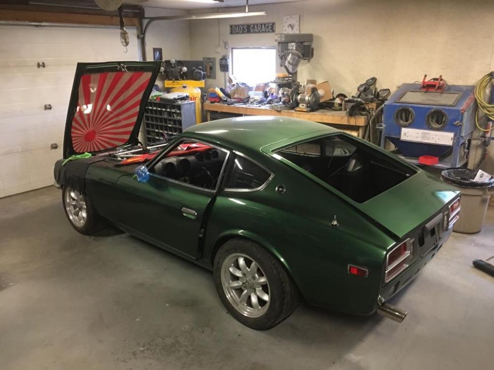

October 18, 20204 yr Author comment_608410 Got so much done today!! ... cleaning that is. Half the shop done! Link to comment https://www.classiczcars.com/forums/topic/50908-1976-280z-restoration-project/?&page=279#findComment-608410 Share on other sites More sharing options...
October 19, 20204 yr comment_608424 You are so close! You've really made good time... Link to comment https://www.classiczcars.com/forums/topic/50908-1976-280z-restoration-project/?&page=279#findComment-608424 Share on other sites More sharing options...
October 19, 20204 yr comment_608426 It looks great, where are you with the tune, is it running nicely yet? Link to comment https://www.classiczcars.com/forums/topic/50908-1976-280z-restoration-project/?&page=279#findComment-608426 Share on other sites More sharing options...

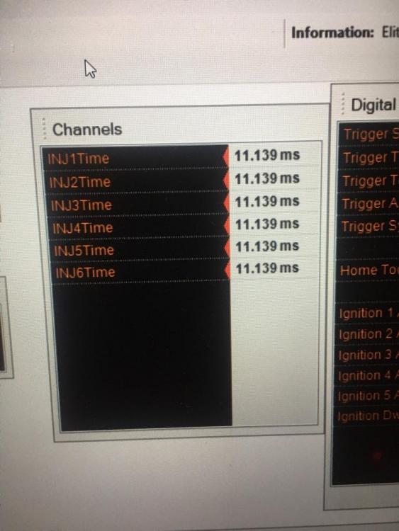

November 6, 20204 yr Author comment_609687 Ever hear the story about the guy that wired his injectors and COPs for Haltech in 1-5-3-6-2-4 firing order instead 1-2-3-4-5-6 cylinder order?Yeah, that’s me... I’m the idiot... Link to comment https://www.classiczcars.com/forums/topic/50908-1976-280z-restoration-project/?&page=279#findComment-609687 Share on other sites More sharing options...
November 6, 20204 yr comment_609693 You're kidding... Wrong firing order? That was the issue? Link to comment https://www.classiczcars.com/forums/topic/50908-1976-280z-restoration-project/?&page=279#findComment-609693 Share on other sites More sharing options...
November 6, 20204 yr Author comment_609694 That is one of the issues... I have a few more tuning bugs and hopefully will have it running soon. Link to comment https://www.classiczcars.com/forums/topic/50908-1976-280z-restoration-project/?&page=279#findComment-609694 Share on other sites More sharing options...
November 6, 20204 yr Author comment_609695 Somehow I have an injector issue too. Link to comment https://www.classiczcars.com/forums/topic/50908-1976-280z-restoration-project/?&page=279#findComment-609695 Share on other sites More sharing options...
