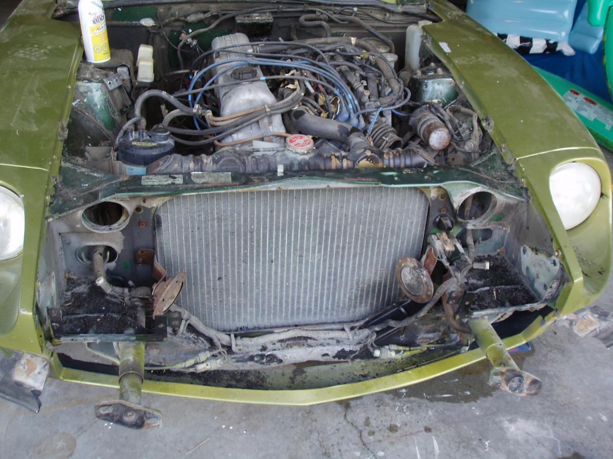

Just realized how messed up my front crossmember/lower rad support really is....
The nose support is completely gone and the horn mounts non-existent. I am thinking I should find a donor crossmember to replace mine as mine is already bent up. The only real dented piece on the car.... I knew something was up based on the horn positions in this pic!

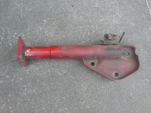

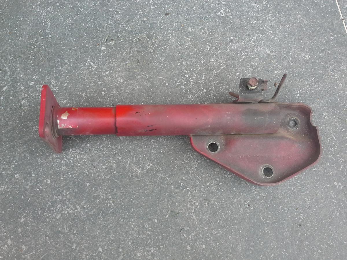

Depends on what month your 76 is, but they changed the horn mounting position to a stud on the bumper shock. See here in photo.
I made new brackets for mine when I changed the bumpers.

Mine is an early model, 9/75 so I think it matches the position from Hazmatt's thread, along the crossmember.

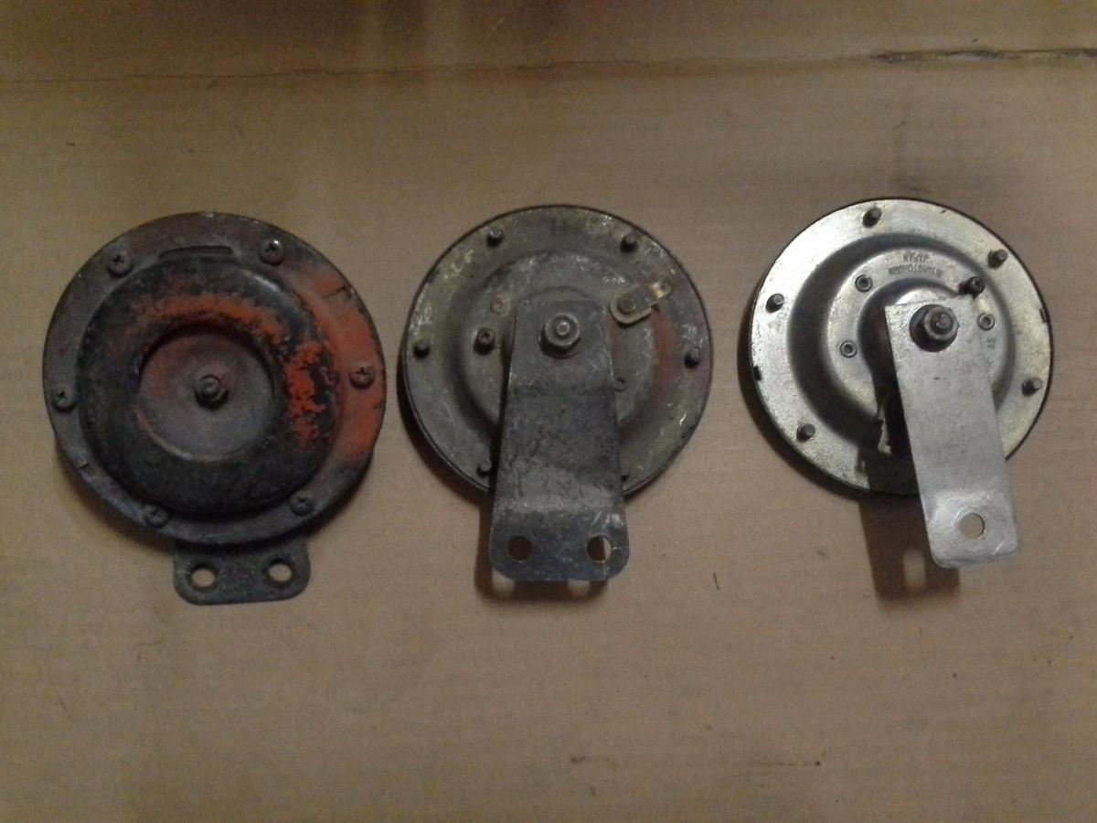

I think they changed somewhere mid 1976. You have the early units with the mounting bracket with two bolts. The later version had a strip with one mounting bolt.
I took a photo of my spares. The photo has the 240Z type on the left and center. Later type on the right. The earlier 280Z would be similar to the 240Z but then bent at right angles so the horns are verticle.
Chas
post-25317-0-69501400-1440444975_thumb.j
Edited by EuroDat
You are exactly correct. I have a question Chas: do the horns have a paper gasket between both sides of the thin steel vibration plate? Mine were completely gone when I disassembled... just a corroded mess.
And can I just make new ones or do I have to replace them with a factory gasket?
