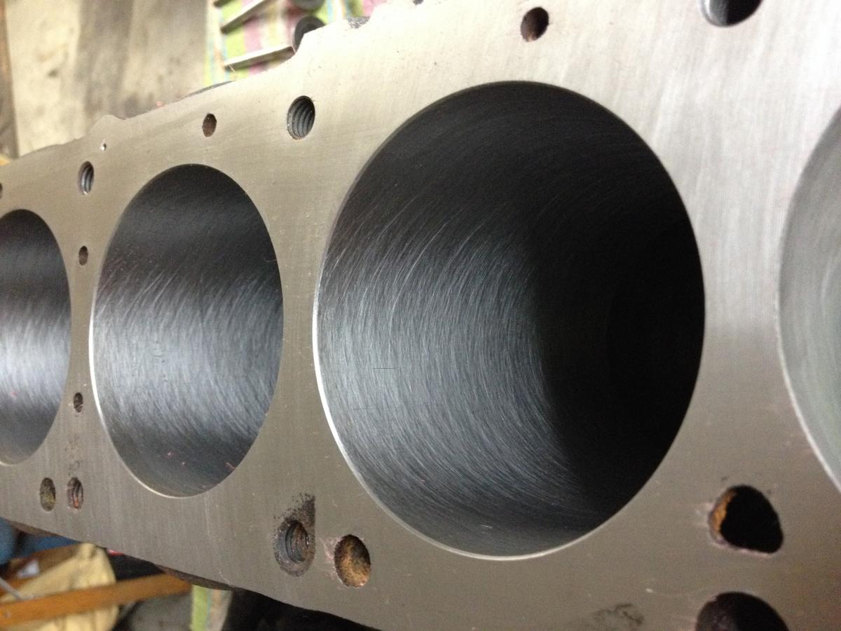

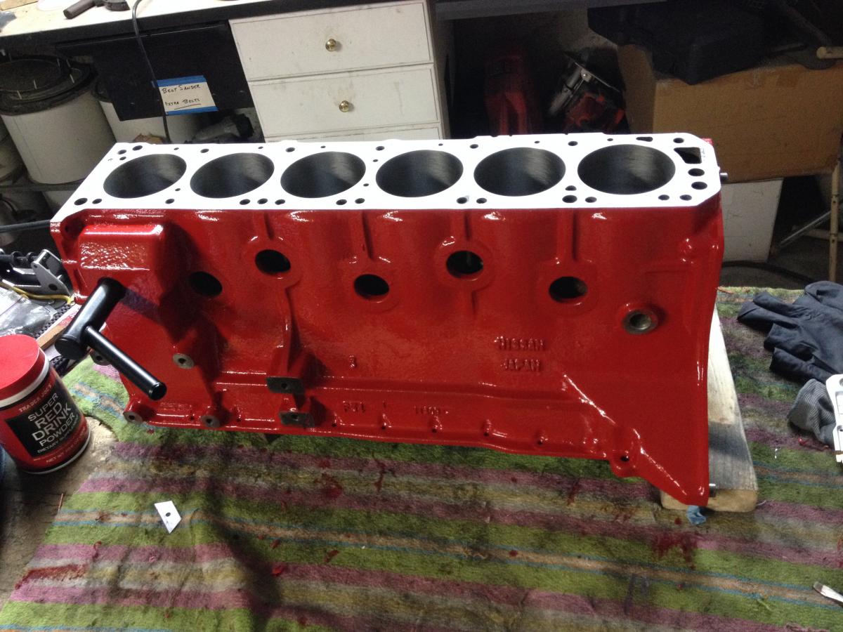

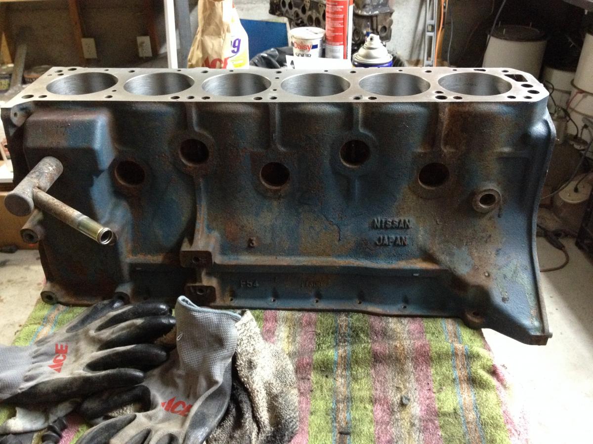

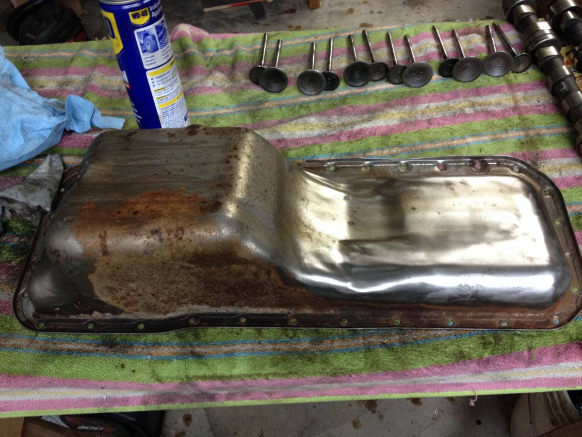

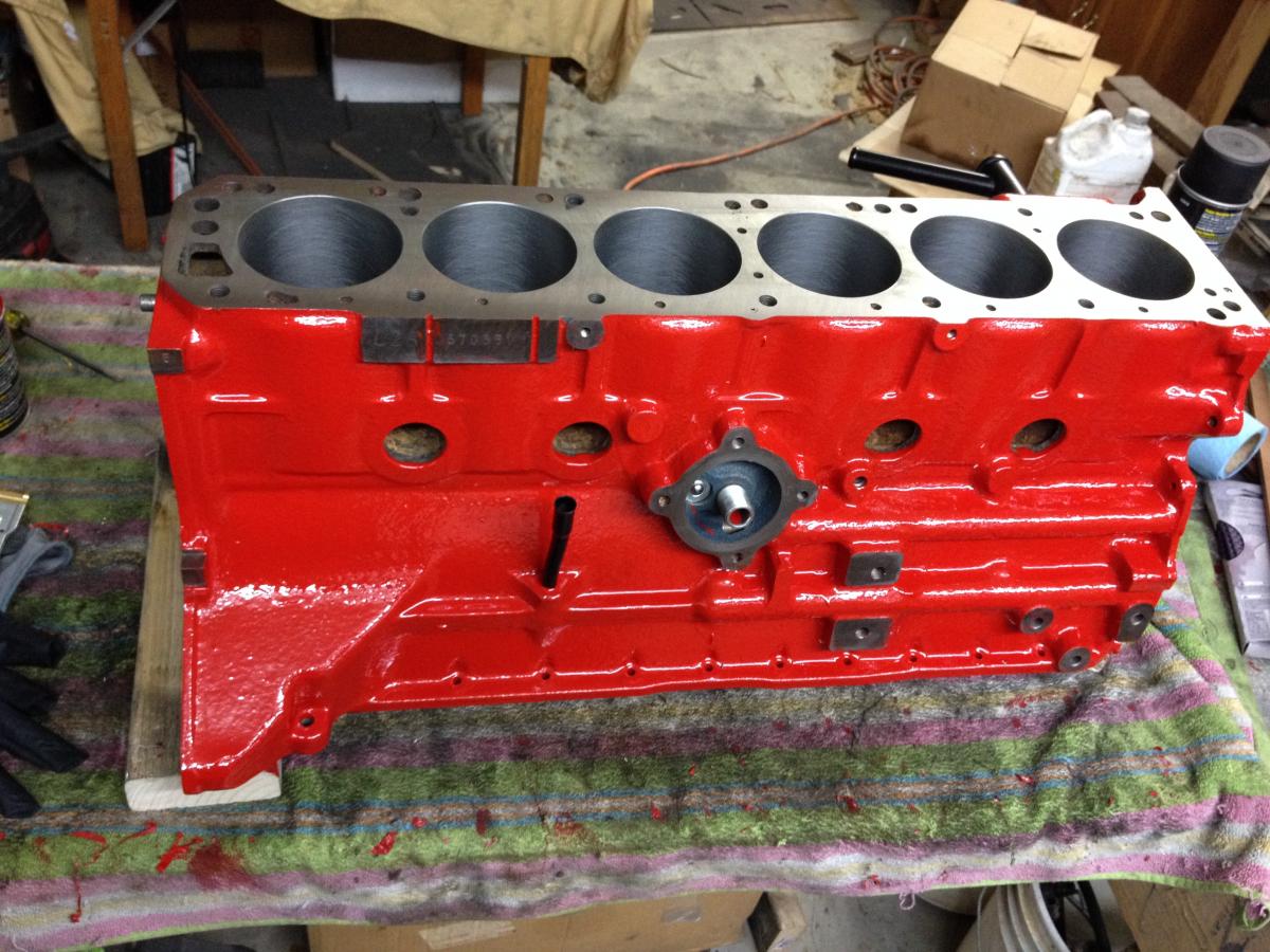

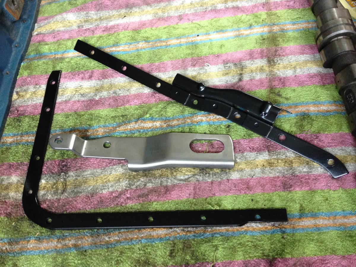

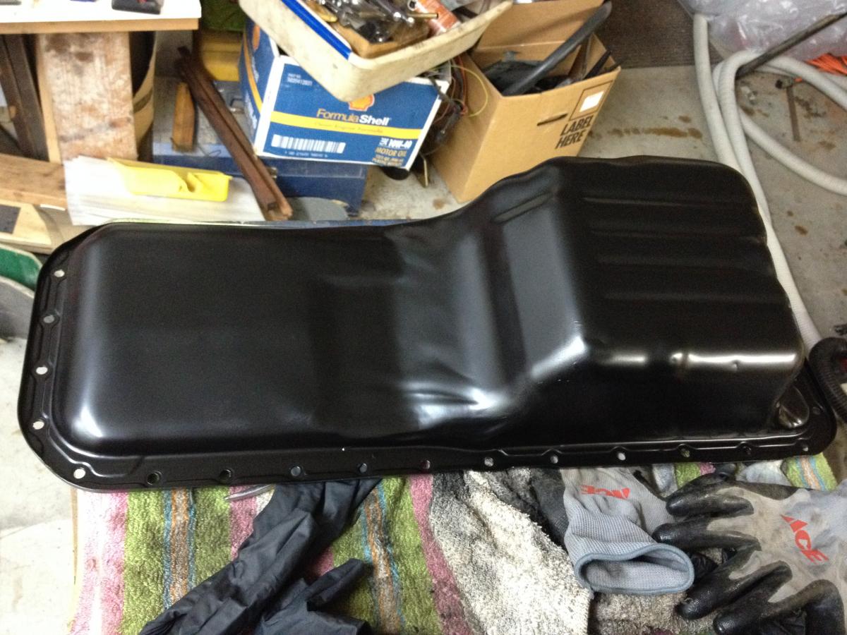

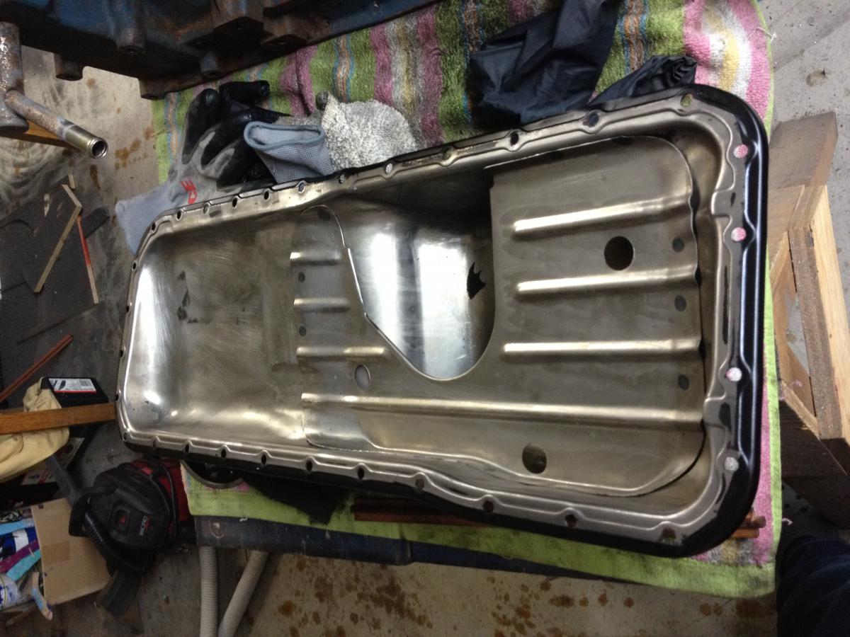

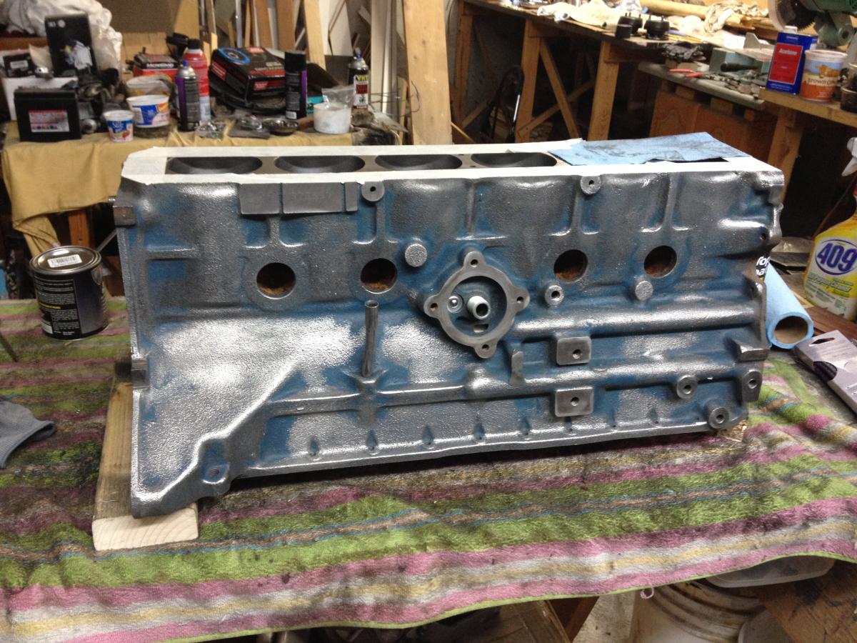

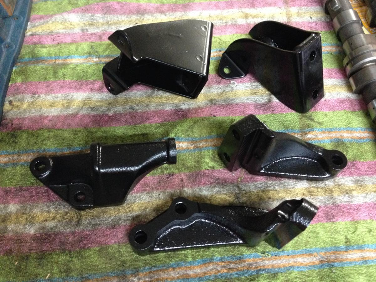

a little progress over the last couple days - stripped the pan (an hour w/the wire wheel and more w/hand abrasives), straightened the dimpled flange & painted, stripped a bunch of misc. brackets & painted. picked up the block from autosport seattle - tanked, deck surfaced, bores honed. ugly on the outside but real purdy on the inside. spent about 1 1/2 hrs cleaning it off using questionable safety practices - mounted my wire wheel on the angle grinder and went at it hell bent for shiny metal. by the time i was done i felt like i'd mixed it up w/a porcupine as i picked countless wire bristles out of my clothes and flesh... all in the name of progress. 2 coats of POR engine block paint and she don't look half bad.
pan in process & done:
post-28907-0-97329500-1431613111_thumb.j post-28907-0-76057600-1431613122_thumb.j post-28907-0-97316000-1431613114_thumb.j
misc bits:
post-28907-0-40389100-1431613117_thumb.j post-28907-0-08556500-1431613100_thumb.j
block transformation:
post-28907-0-38576400-1431613120_thumb.j post-28907-0-20324000-1431613125_thumb.j post-28907-0-35118600-1431613103_thumb.j post-28907-0-08697000-1431613106_thumb.j post-28907-0-02057200-1431613109_thumb.j

I still love the red, don't care how many blocks end up that color. A wire wheel probably rated for 6000 rpm on a 10,000 rpm grinder will do that to you. As long as no one lost an eye its all good. I have the same wide band and it seems to work pretty good, except I need a new o2 sensor

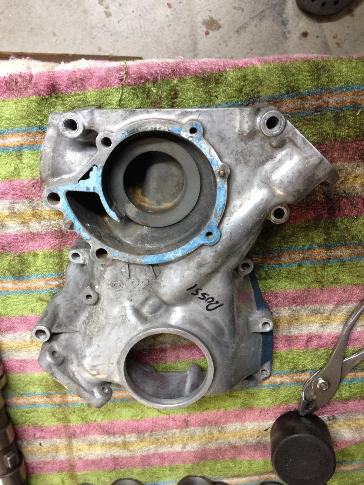

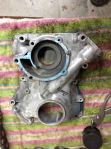

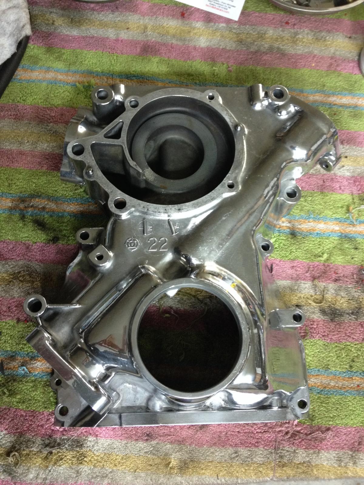

the front cover is a pretty rough casting - the inside is actually nicer than the outside, so it didn't polish up that well. looks better than it did though.
post-28907-0-37241100-1431902990_thumb.j
post-28907-0-77524000-1431902986_thumb.j

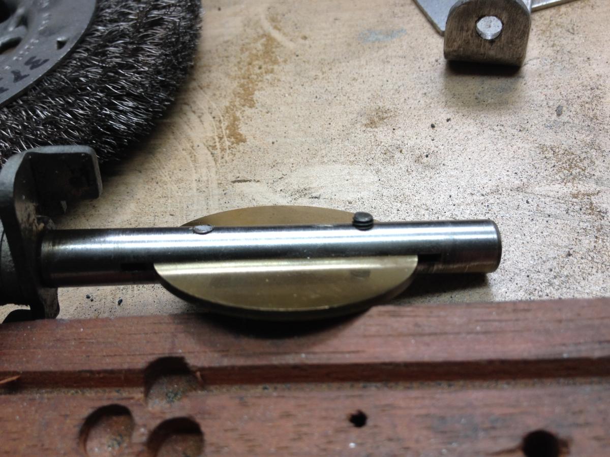

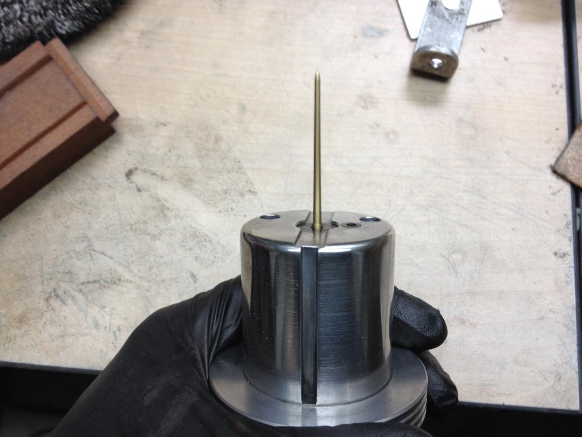

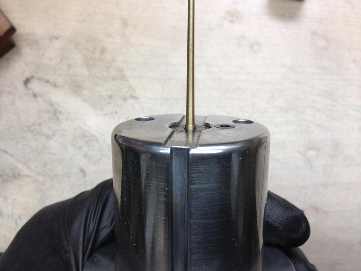

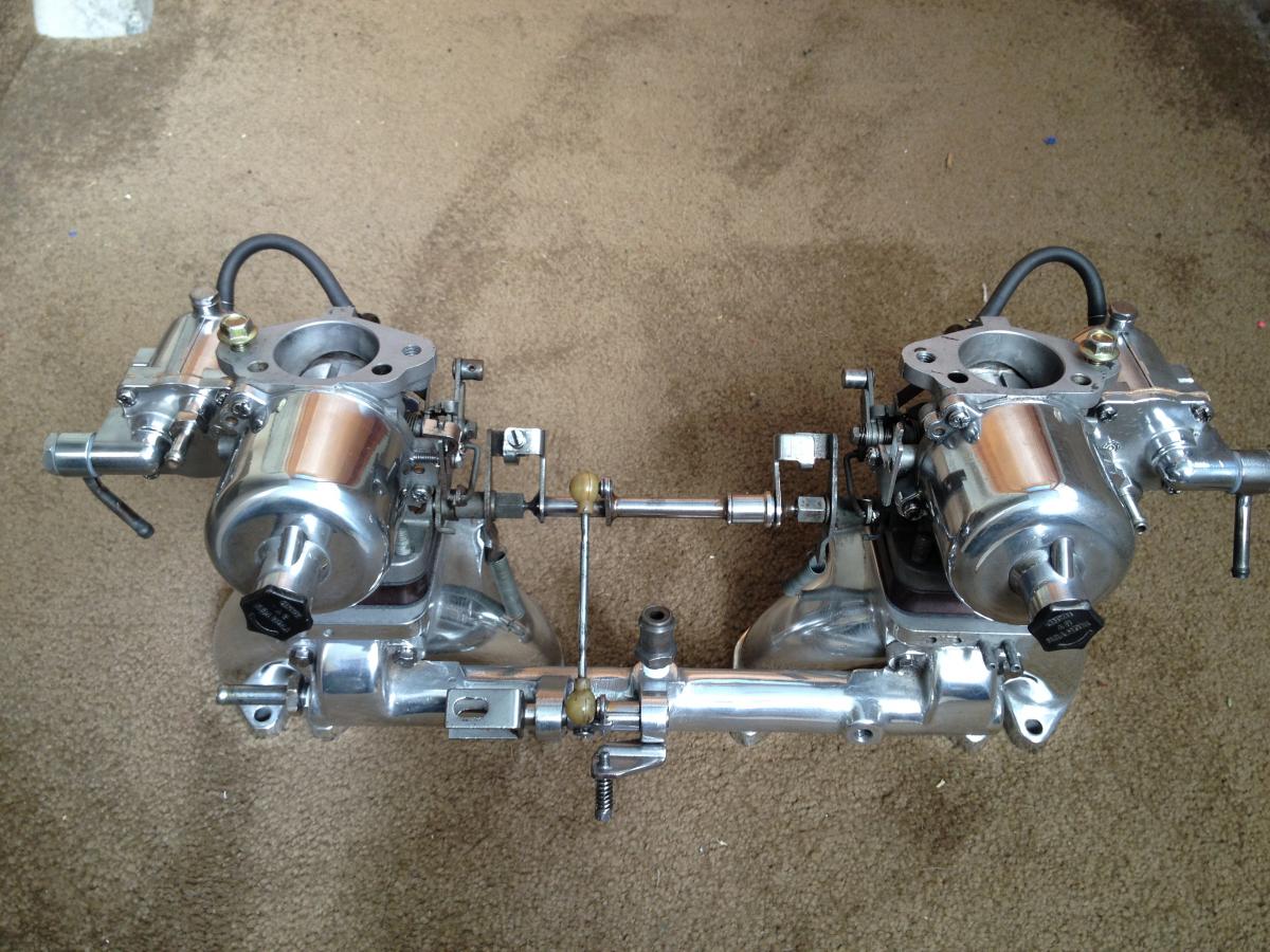

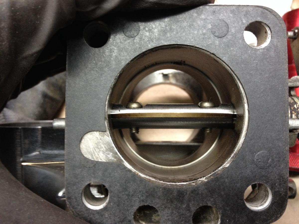

finished re-building the su's following the detailed info on the "just su's" video - new nozzles & sm needles all set up. these carbs have got to be the simplest think on the planet compared to the 4-barrel chevy stuff i've worked on. the trickiest part was setting the float levels, but even that was pretty straightforward. while i was at it, i beveled & polished the pistons and trimmed the butterfly screws to get 'em out of the air stream. then just for fun i hit the float bowls & linkage w/the buffer wheel to make 'em shine a little.
i ordered a firewall grommet for the choke cables and when that arrives i'll put the su's on my current engine (along w/the low-pressure fuel pump) and do some initial tuning and a butt-dyno comparison w/the efi.
butterfly bolt trim:
post-28907-0-65511400-1431903858_thumb.j post-28907-0-41015300-1431903861_thumb.j
piston bevel:
post-28907-0-97142100-1431903865_thumb.j post-28907-0-11706400-1431903870_thumb.j
all done:
post-28907-0-28182100-1431903939_thumb.j
