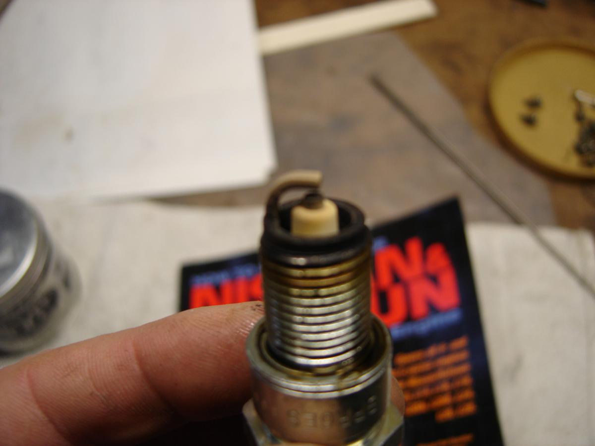

post-23570-0-23193100-1420849781_thumb.j
Number 1 plug looks good,
