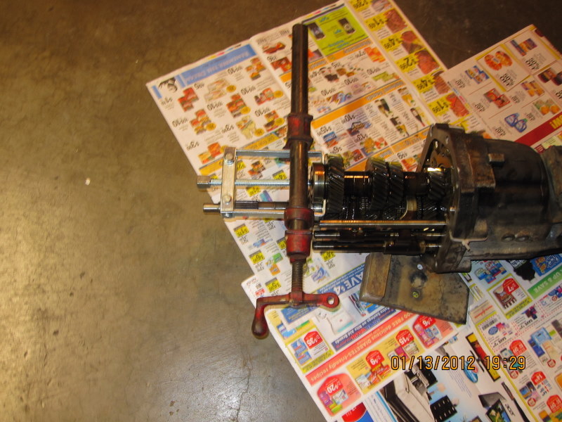

You got a lot done in a short time. Impressive. I like the bailing wire puller trick, I did similar with an adjustable pipe clamp on a two jaw puller, to break a bearing loose and pull it. I think I took a picture for the record just because it looked so bad.
Found it...
