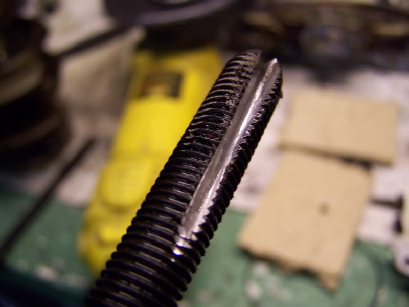

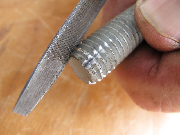

btw if you wanted to "tap" those holes first, just get one of the screws/bolts and file a couple of axial grooves in it using the long edge of a file.
This works great for chasing/cleaning bolt holes and for taping soft materials like plastic. (I first did this using old head bolts to clean the holes in the block.
Here is a picture of someone starting the "tool making" but the grooves have to go all the way along the bolt.
Here is a variant that is cut a bit deep and only a single. 2 or 3 cuts are recommended
