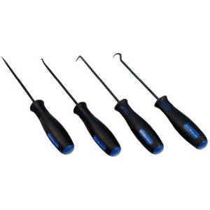

I've found that a hook-shaped pick does the job for the door handle retainer. It's on the splined shaft, you can see it if you try. You can get something like these almost anywhere.
