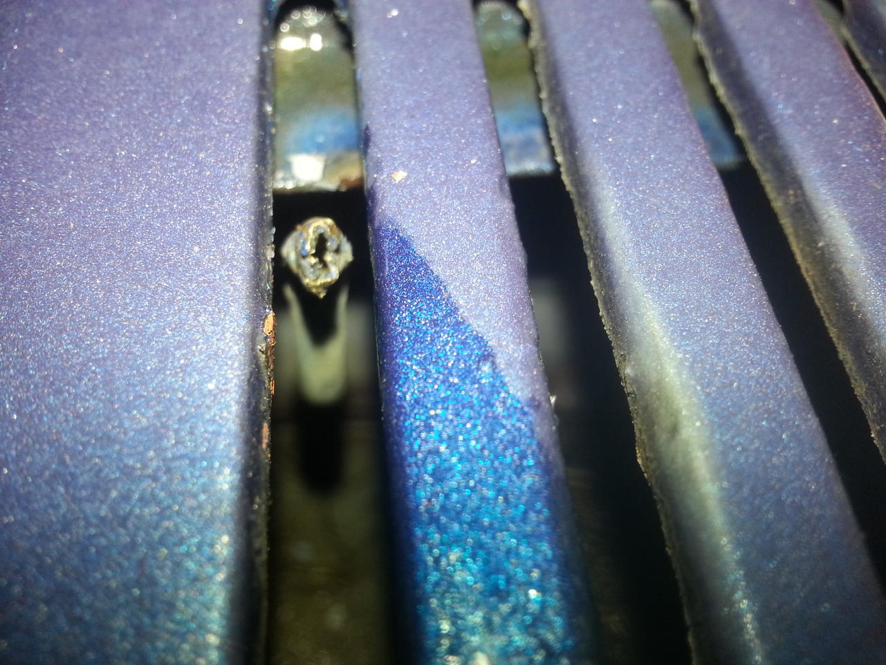

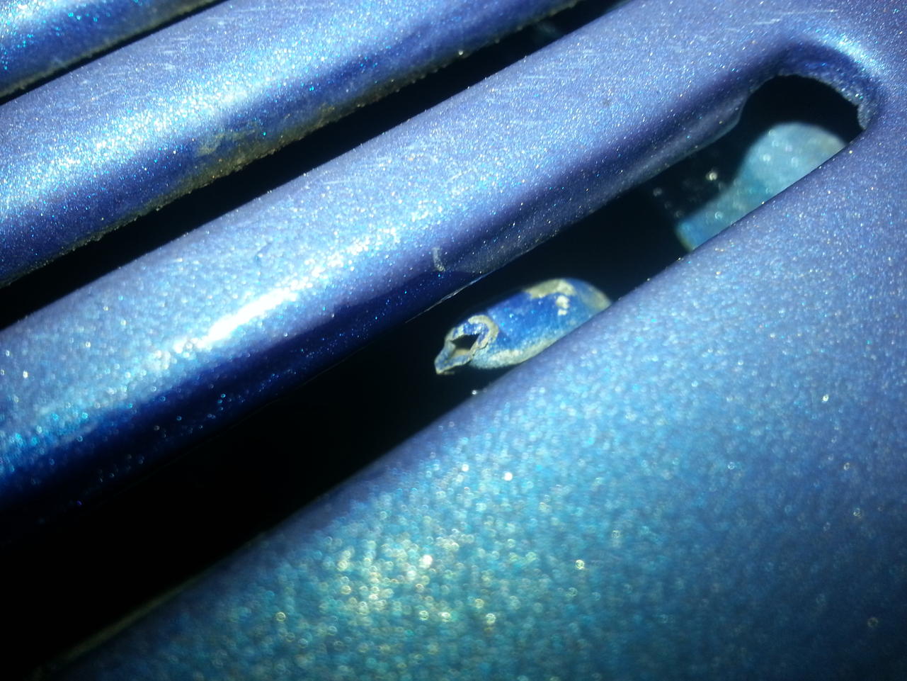

Anybody with a working 240z windshield washer sprayer mind taking a picture of the end of the nozzle? Mine seem to have been mangled by the previous owner.
My pump was dead when I got the car and I finally replaced it, and I get a steady limp wide stream of water that comes almost to the windshield. All I can find is tips on using wire to de-clog the system, but I'm thinking with how chewed up mine are I think somebody might've reamed out the nozzles too far. Smaller orifice should provide more pressure and therefore distance, right?
The closest picture to the business end of a (ostensibly functioning) nozzle is from this ebay listing and it looks pretty flat and even, whereas mine look kind of like somebody chewed on the end of a pencil. How wide is the orifice when viewed dead-on? If it's narrow I'll just mangle them further with some pliers, but I don't really want to do that without a little more info on how they're SUPPOSED to work.

Yeah, they have been "adjusted". They are close to stock, but definitely opened up some. The orfice size is critical to having a stream velocity that will reach the windshield but still deliver decent volume.
Try tapping them shut a little at a time until they squirt better.

Resolved, I attacked the nozzles with a pair of vice-grips and fixed a bit of a kink that was probably at least half the problem :facepalm:
....Then I had a fully working roof-washer sprayer
A little re-aiming later and everything is a-ok! It's just nice to have a second opinion before potentially destroying a part that may or may not be function and may or may not be hard to replace.
