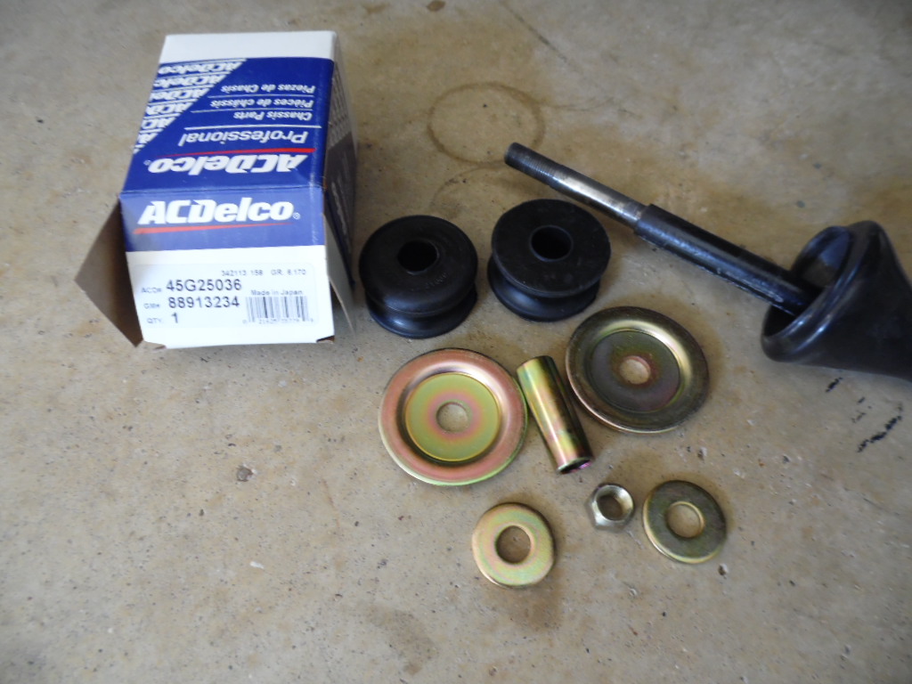

Today I started the process to get rid of polyurethane bushings and return to OE-style rubber. First off was the T/C rods using the AC Delco kit another member so kindly identified and available from our friends at RockAuto. A club tech session next weekend will see the rear LCA and steering rack bushings going back to rubber. I am really looking forward to a more civilized ride! :)

Price of that "kit"? Also more is shown in the picture than just the "kit" - yes/no?
thanks,
Carl
Carl,
The kit is as shown but not the T/C rod or boot. The price is $10.46 per side before the typical 5% discount and shipping. Look it up by the # 45G25036, it does not come up by our car models.
Jim
A bit more info - the plastic bag for the kit shows it to be made in Japan (no surprise there) and has a P/N of 2749099. Not a Nissan-style # but possibly from one of their long time OEM's. Lucky for us that AC Delco chose to pick it up for re-packaging.

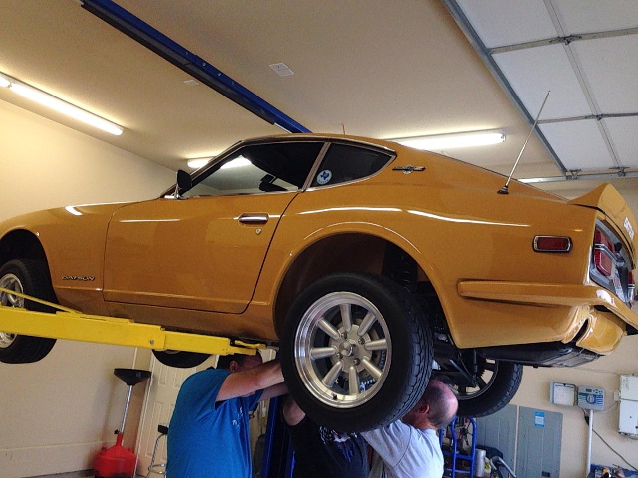

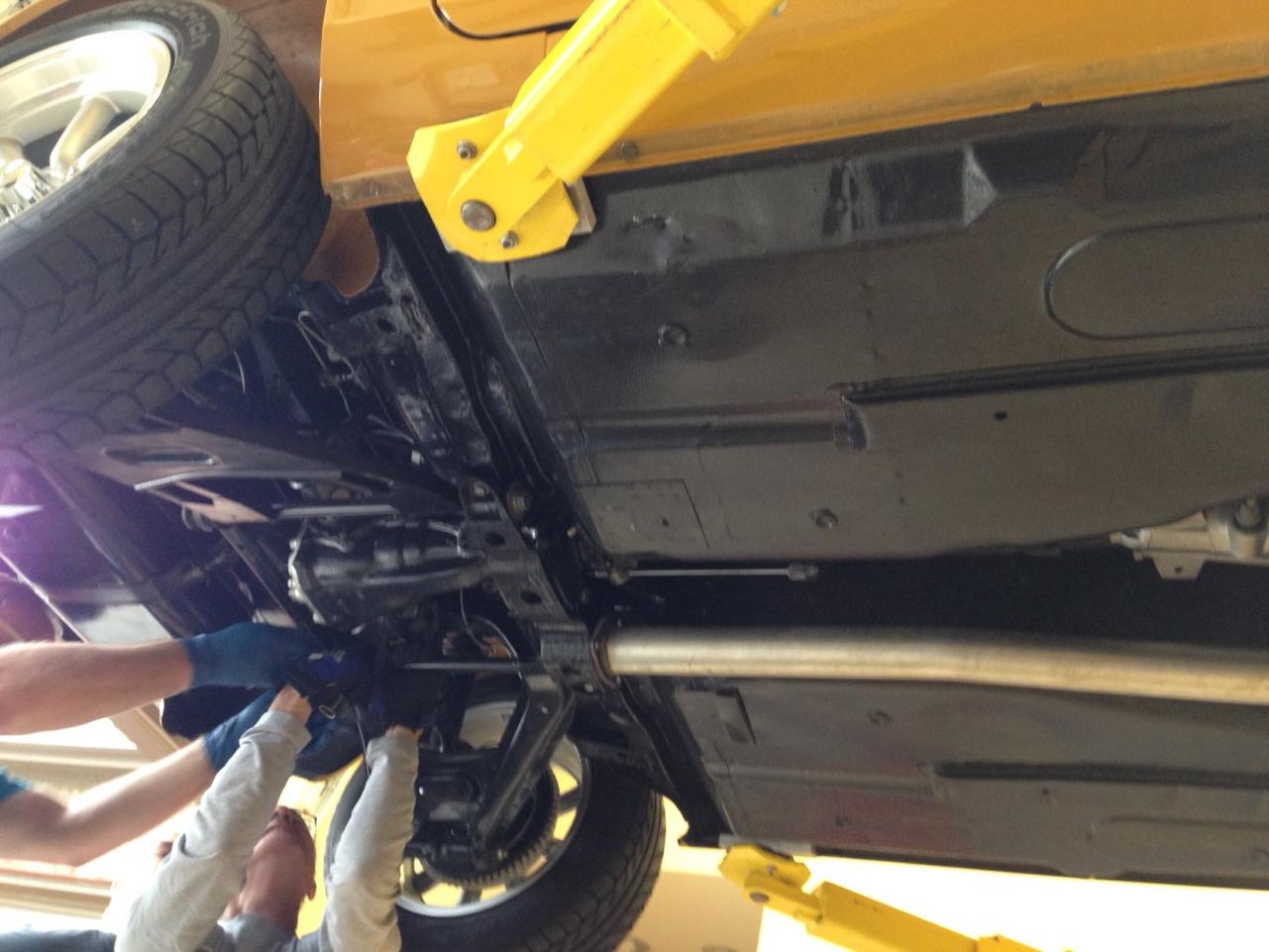

On the lift at a club tech session yesterday to get more poly bushings swapped out for rubber. The inner rear control arms were changed as was the steering rack. With eccentric bushings on the front control arms I won't get a lot of improvement up front but at least some of the snap in the steering wheel goes away. I can tell the difference already with the T/C rods and rear control arms now changed. The steering rod will also get swapped back to rubber in the next few days.
Beautiful bottom you have there!
Gawd, I luv it when you guys talk dirty! :love:
