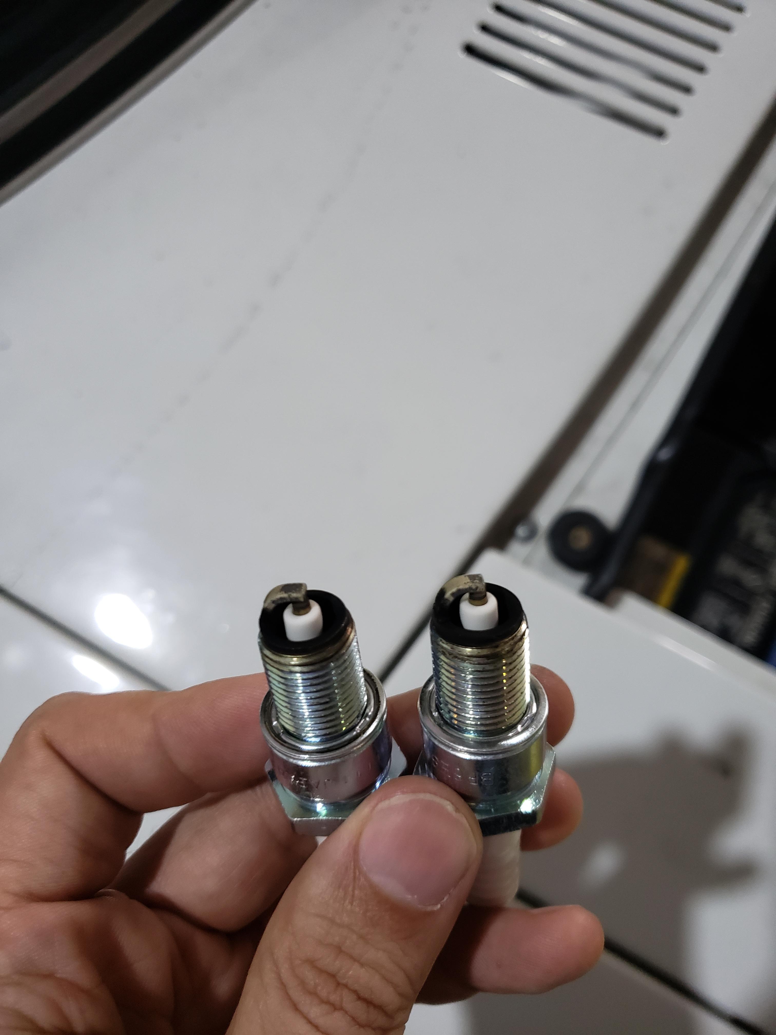

Plugs 4 and 3
@jalexquijano LOOKIN GOOD. The plugs are definitely lighter than we used to run the "back in the day" but you report the engine is running good so I'd leave it alone. I think the problem with #4 was in the cap, rotor or plug wire connection. #4 definitely looks better now. The lighter plug color could be due to modern gas formulations as reported by others. I'm still curious about that previous lower compression reading. I'm hoping it was a poor test and not tight valves. Any thoughts?

I would be more concerned with the low compression readings you posted. You say the car is running good, why not drive it and do as you said "please calm down"?

 @jalexquijano Ignore my last post to you. Leave the floats alone. (Everyone can breathe a sigh of relief) If you want to lean it out a bit (1/4 -1/2 turn) to see how it runs, try it. Most of learned by trial and error. Remember, your plugs looked nice and clean at the current settings and it runs good.
The misfire issue due to carbon fouled plugs was clearly because i pulled the choke knob all the way and left it running 2 mins with the choke fully on while the engine got warm.
