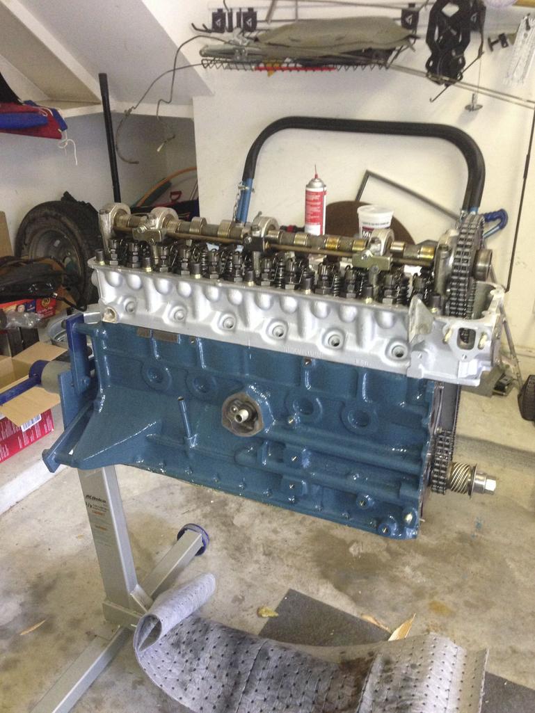

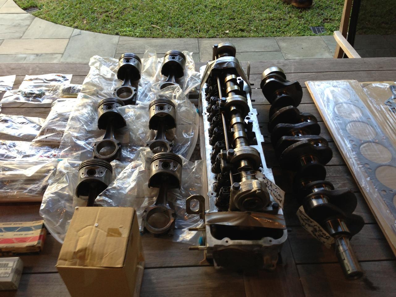

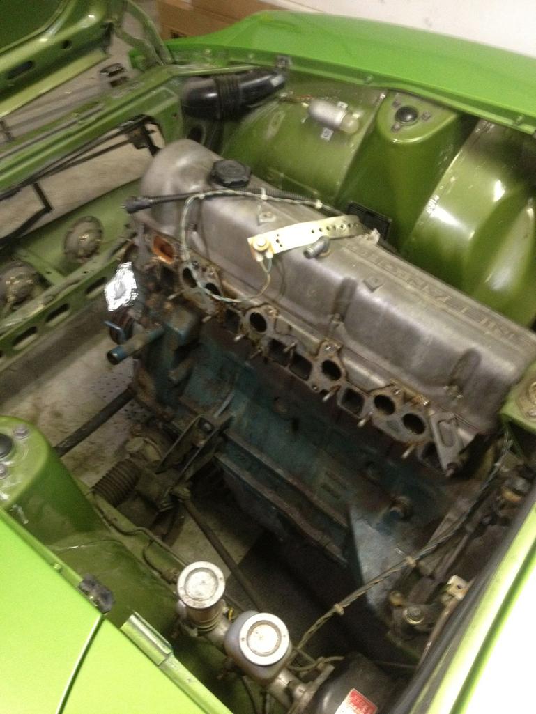

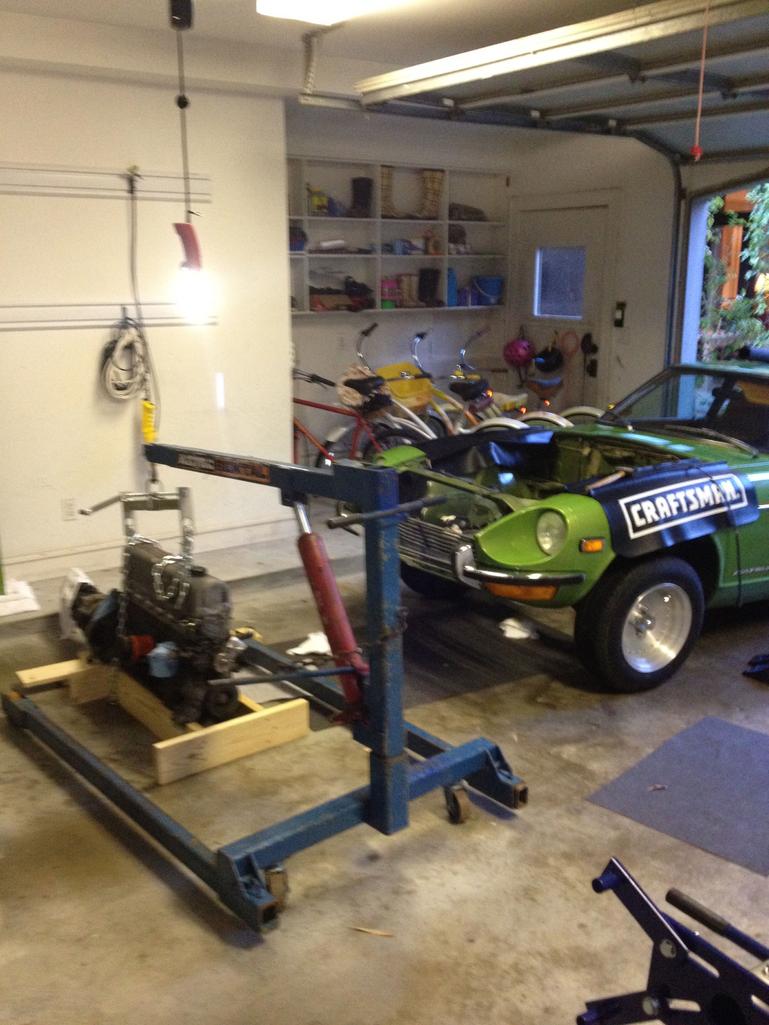

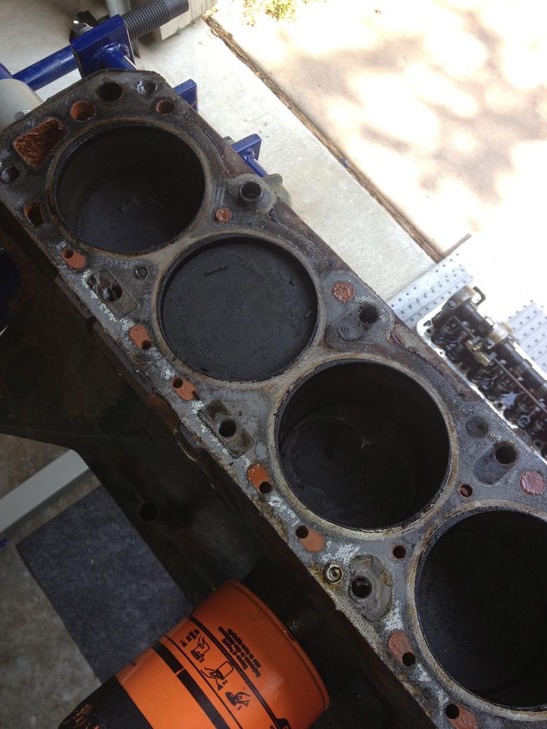

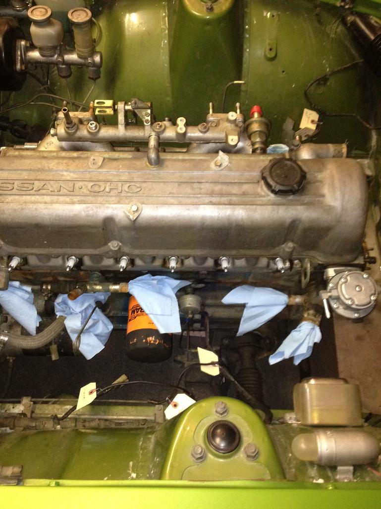

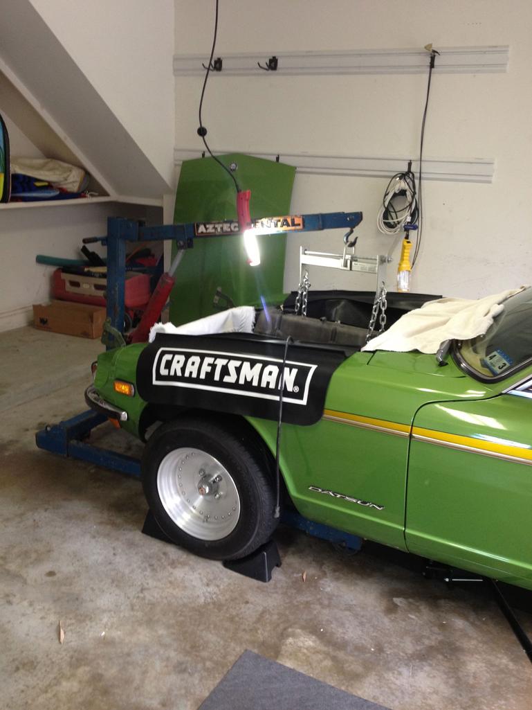

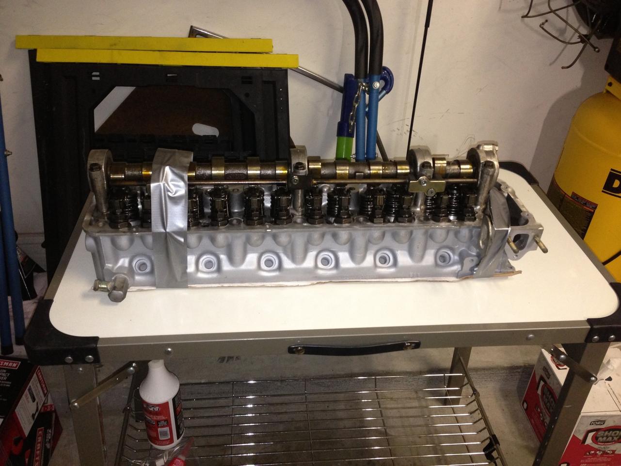

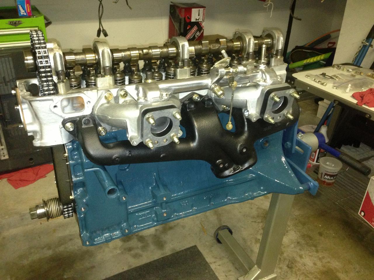

Thank you. I wish that I could lay claim to the garage, but that belongs to Classic Cars of Houston. My home garage is a much more "intimate" space. Here are a few pics from the engine tear down and rebuild. When i purchased the car it only had 52,000 miles on it and so the engine just needed a little re-honing, repainting and refreshing. New rings, bearings, seals etc., plus a good old fashioned valve job.

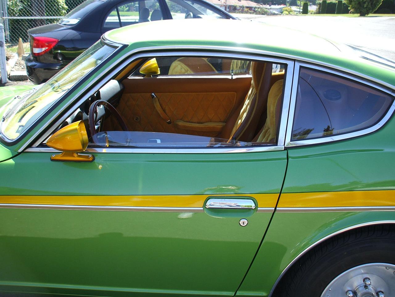

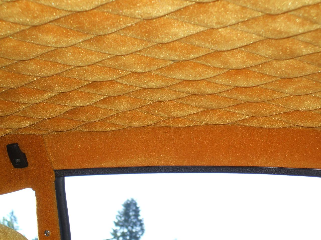

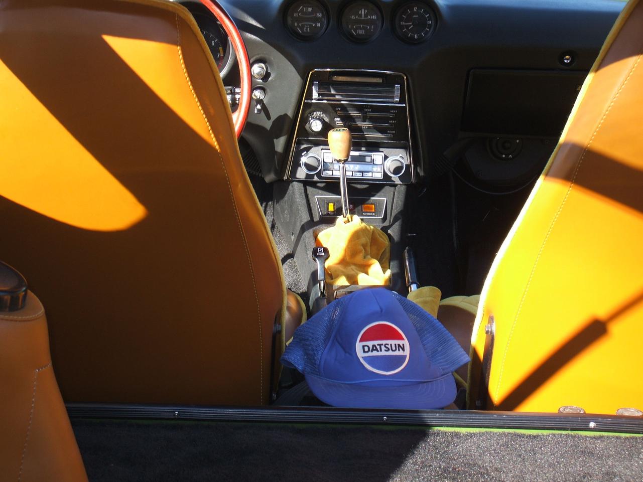

Here are a few more pics of the interior and the exterior before I started the restoration. Check out the headliner and the shifter boot.
Yes, it really was very cool. The guy that owned it lives in Everett, Washington and it was his baby. It was like I was buying his favorite child and I'm thankful that he sold it to me. Hopefully I can preserve it and enjoy it with my kids and then pass it on to someone else in 40 years.

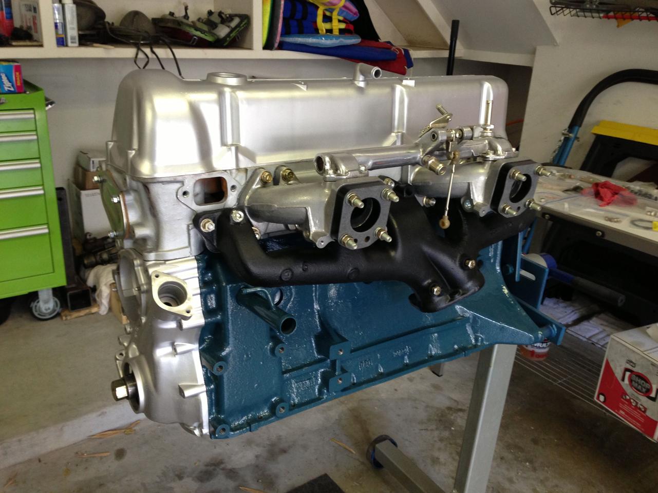

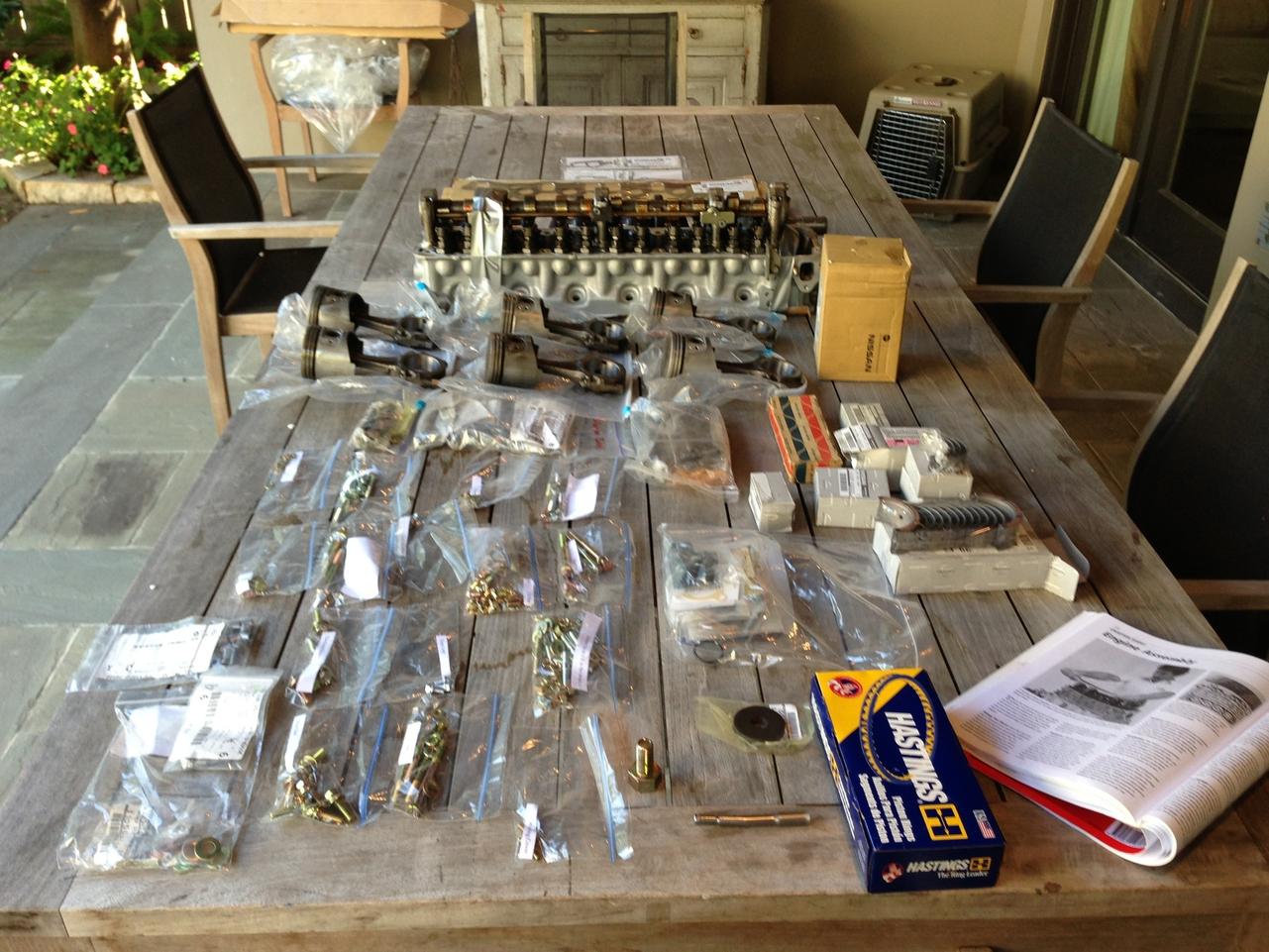

Your car is looking fantastic. Would you mind sharing details of your engine refresh? Original pistons? What brands did you choose for rings, bearings, gaskets, etc? Did you leave the camshaft as is or regrind?
Also, are you painting or powder coating the black suspension pieces? If paint, what are you using?
Thanks.

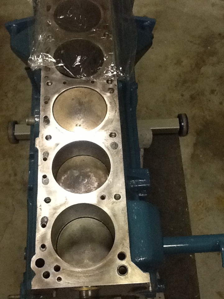

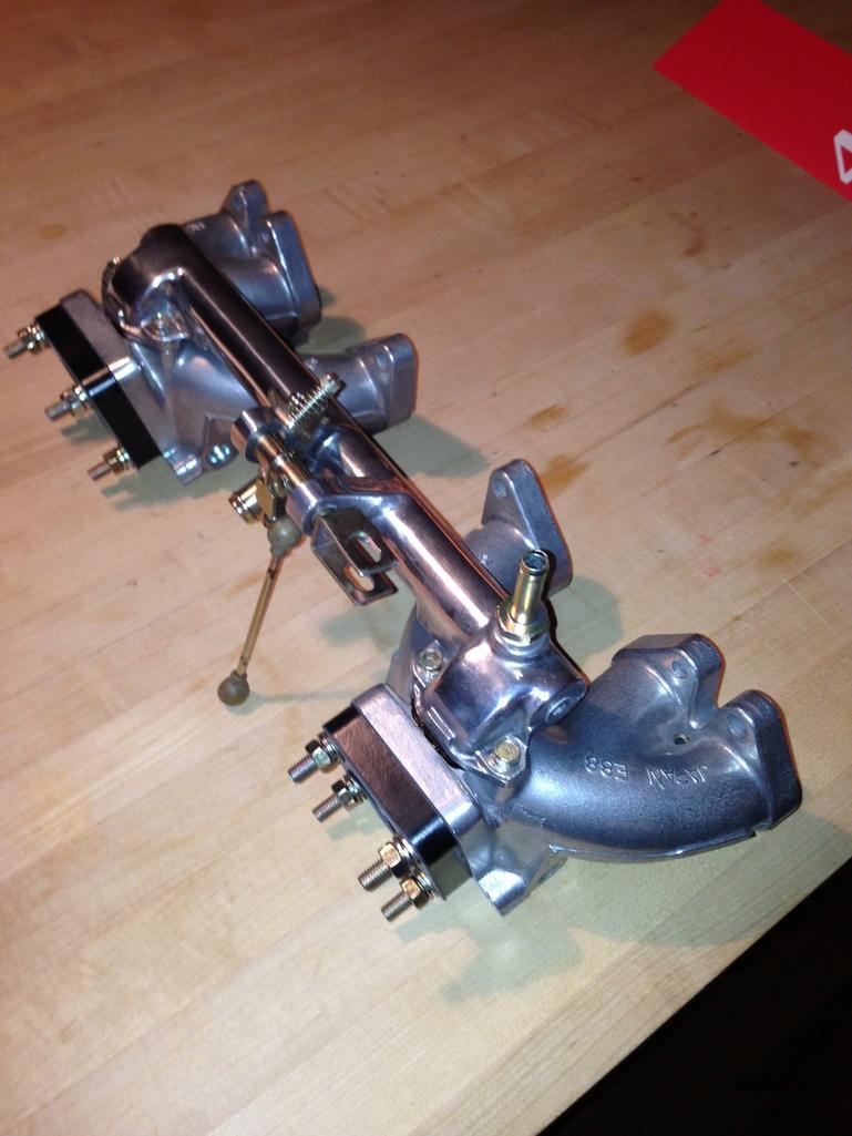

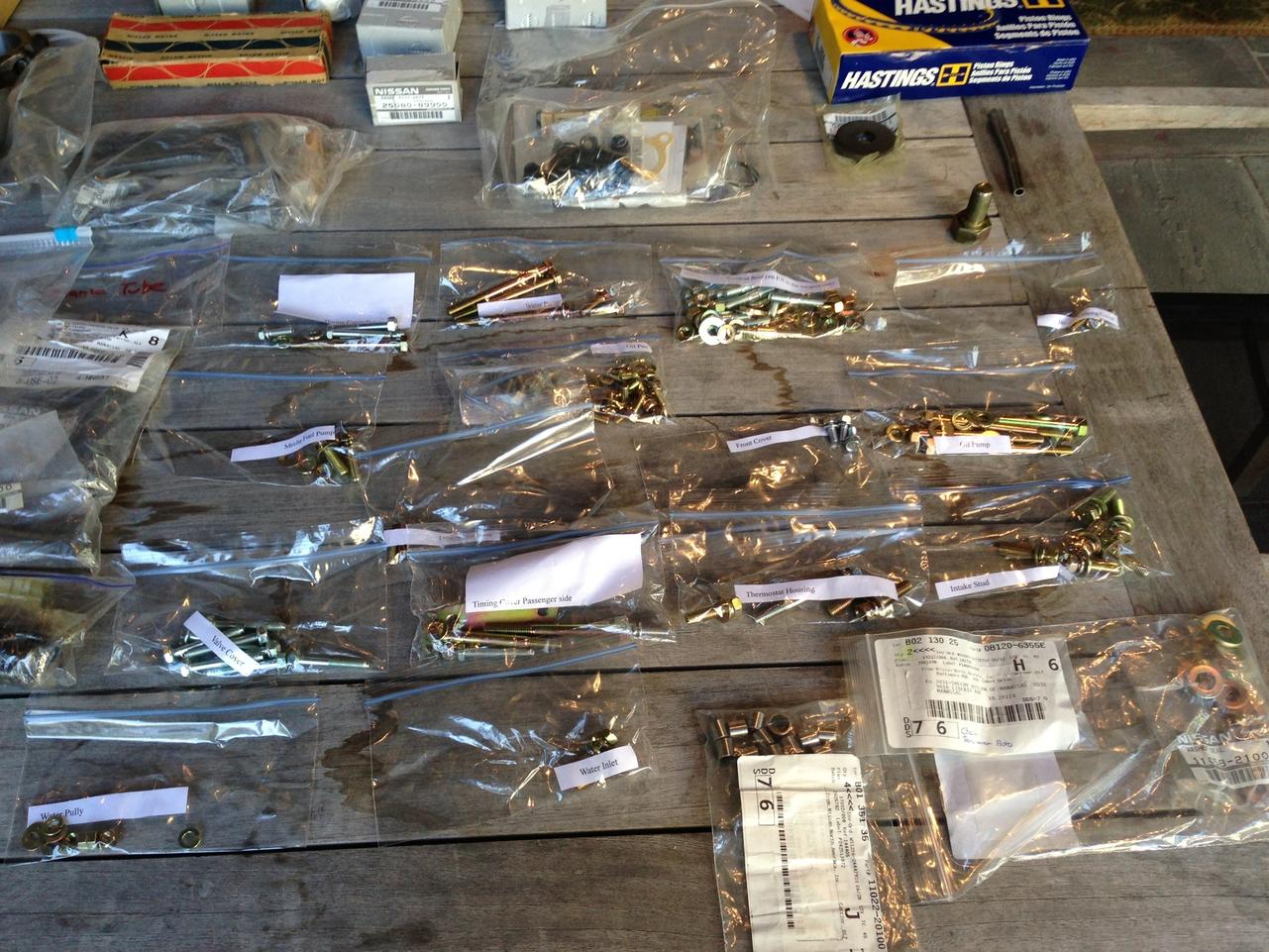

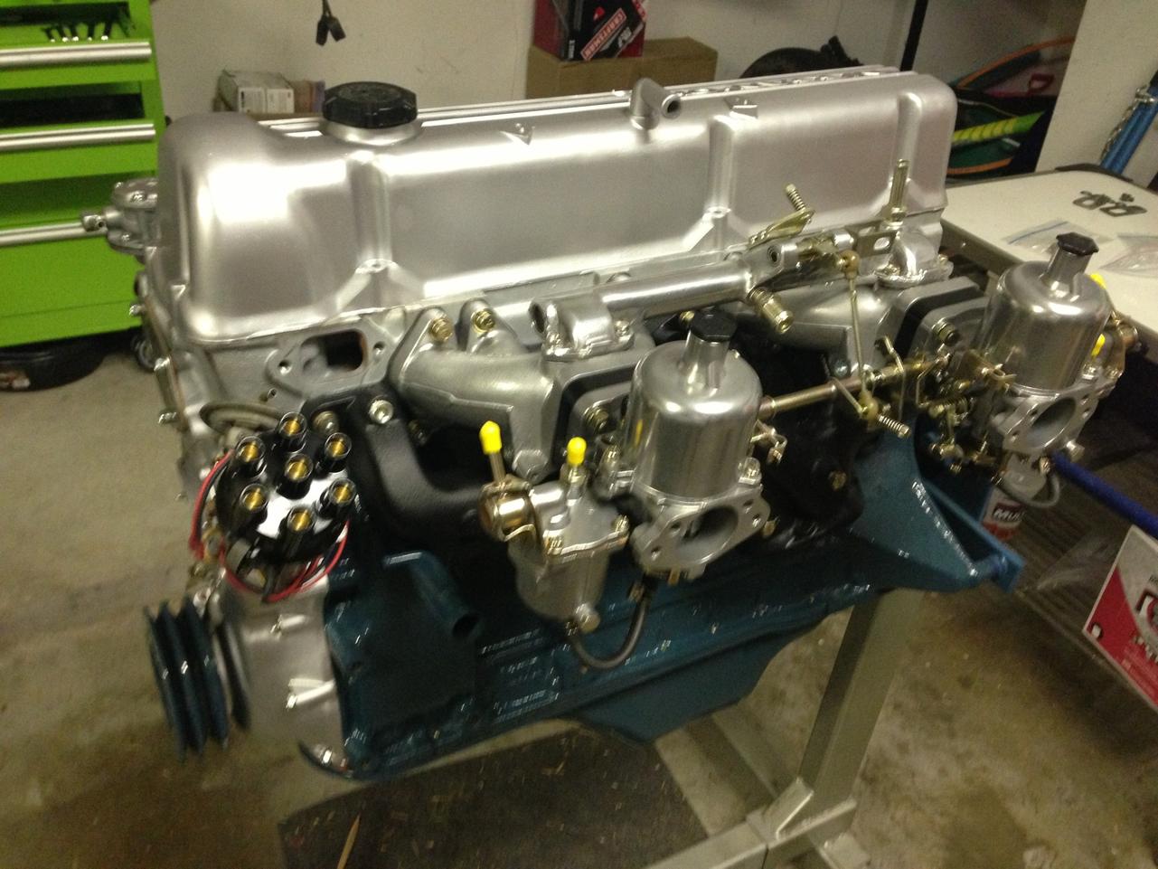

Thank you very much. I'm happy to share any and all info. Yes, the pistons are the original ones and just needed a good cleaning from the machine shop. I had the block mangafluxed, rehoned the cylinders, gave it a thorough cleaning and then repainted with the original Datsun blue. I replaced the rings with Hastings moly rings. The engine nuts, bolts, bearings and gaskets are OEM (had to use a few non-OEM gaskets). I didn't have to grind the cam or crank (polished only) as they were in really good shape according to the machine shop. The suspension parts are all being sandblasted and painted at the shop that painted the car. I don't remember the brand of paint, but it is a durable low-gloss black with a coat of clear for a little more protection. I wasn't planning on replating all of the nuts and bolts, but this restoration thing is a slippery slope and I am doing a lot more than I had originally planned to do. I also had the carbs and intakes rebuilt by the magicians at Z-Therapy. Also sent the original exhaust manifold off to Jet Hot for cleaning and coating. Here are a few more pics.

Sorry for all of the questions. We are approaching things in similar ways. I used Jet Hot for my exhaust manifold also. I think I will do as you did for valve cover and timing cover. Did you coat gasket surfaces? What about surfaces exposed to the internal engine- under side of valve cover, underside of timing cover, water pump area of timing cover?
