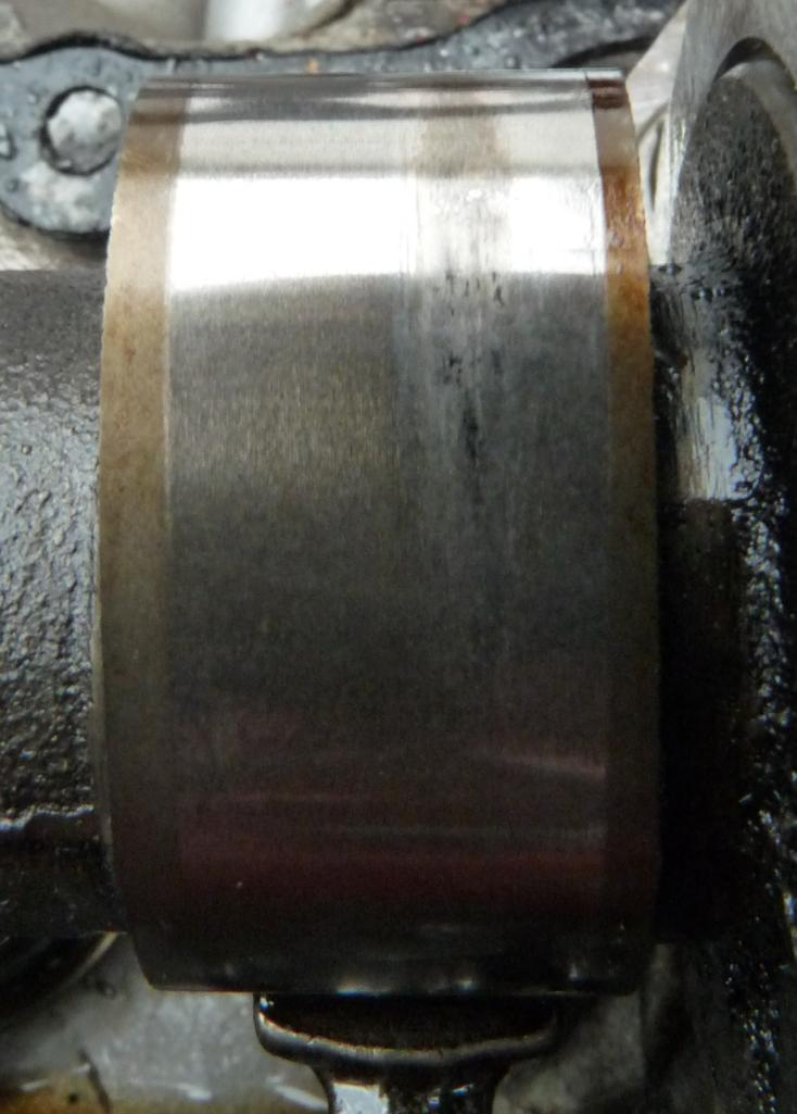

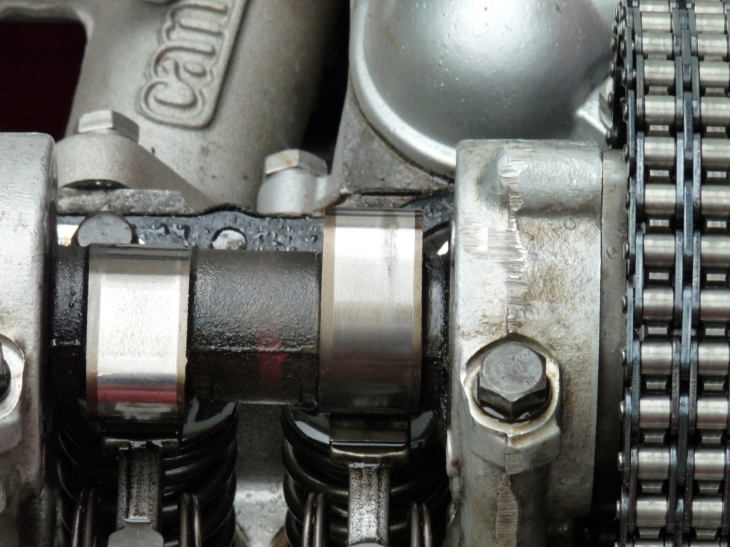

A new medium Schneider Cam with new rockers was installed 1,500mi ago and lobe 1 is starting to show wear. (on the back side of the lobe). The oil is dyno with zinc additive.
I am now guessing that the Schneider springs and/or a partial oil blockage to the head are to blame. The springs were extremely difficult to install due to their high spring constant and the oil flow out of the cam when cranking using a remote starter seems less than the old spray bar that I have seen many times.
Any ideas?

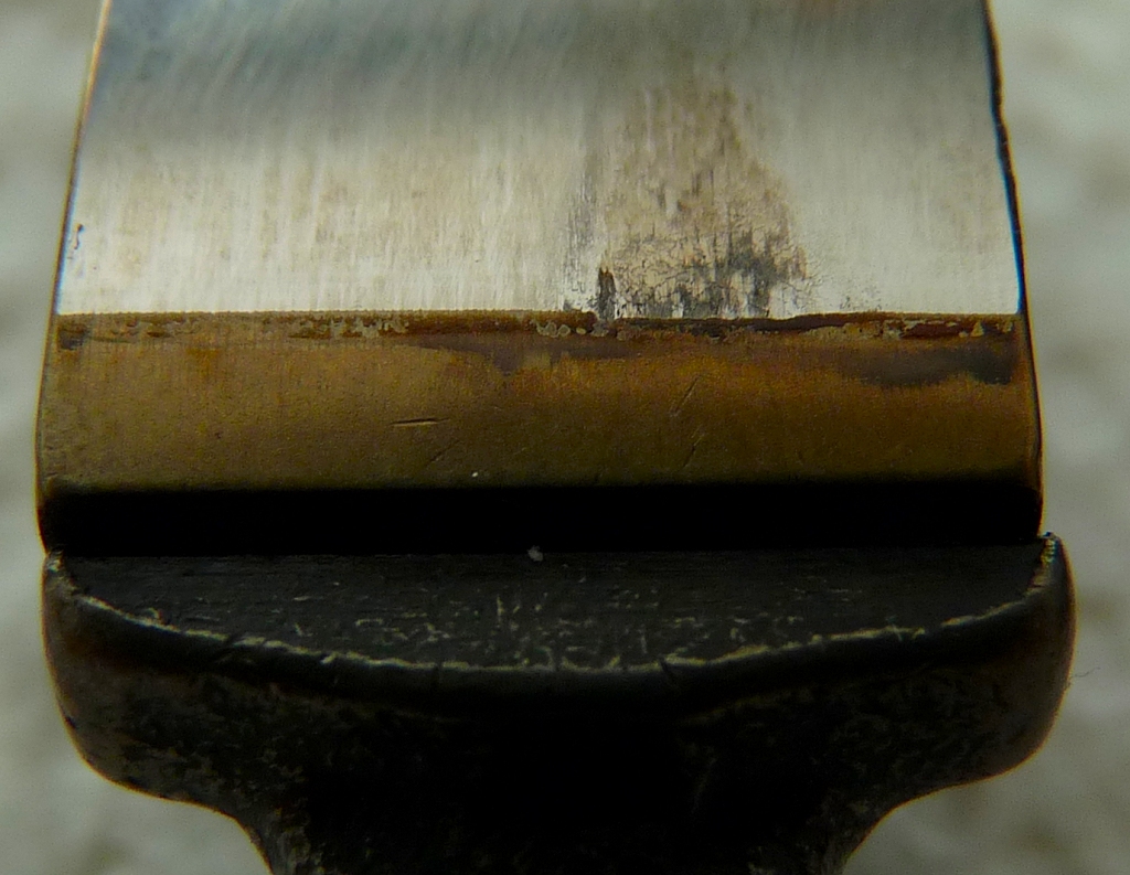

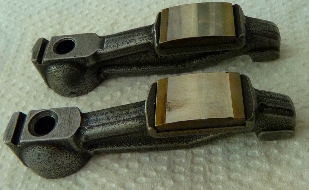

Here are photos of the rocker from #1 Exhaust corresponding to the worn cam lobe.
I also pulled off #1 Intake to compare.
Both have good wipe patterns.
I notice a ridge on the plug side of the pattern on both rockers. It is easily felt with a finger nail and can be seen. It is more noticeable on the worn one. There is no ridge noticeable on the distributor side of the wipe patterns. So it seems there is more wear on the valve return portion of the cam's cycle.
I also observed great oil flow after cranking but it seemed longer than normal for it to appear. Any ideas if there is anything related to this? Only Purolator and Wix filters were used since new.
The rockers in the photo are Delta regrinds. I have other used stock Nissan rockers i can throw in if that may be the culprit. Yes/No???

Blue....It looks like a defect in that rocker.....is that an optical illusion or a little defect just before the bright wipe pattern? I'd try a new rocker and see if the wear transfers to the new rocker. If not, just run it.
