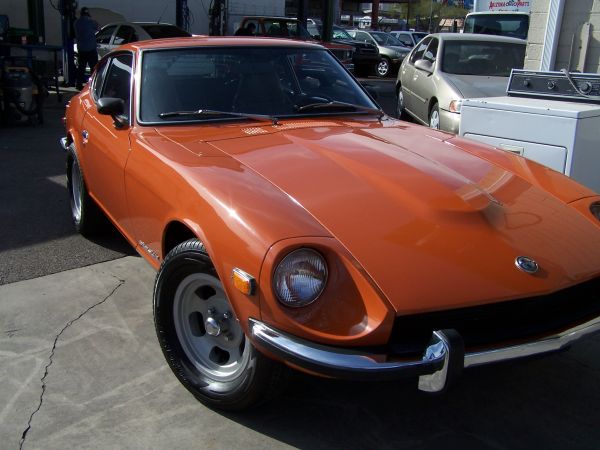

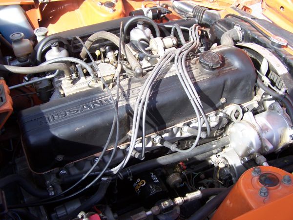

All in all it looks like a really nice car but a few things stand out. Air cleaner painted black, valve cover painted black, would like to see what the seats looks like under the covers. If they are original you can bet $ the foam is collapsed. Not a deal breaker but when you are spending $12K for a Z you would expect everything to be top notch. A big bonus that it has cold AC!
Looks like a nice car, but I don't like it when people say stuff like this...
this is a 100% original Arizona 240-Z that has only 87K miles.

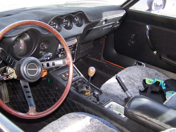

Rug on the dashboard?
Steering column clamshell off and sitting in the passenger seat?
Aftermarket puffy armrest on the center console?

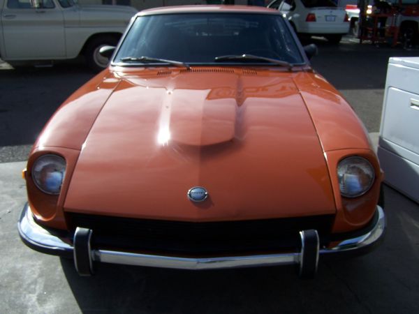

and... Where are the flat-tops? 73 should have flat tops!
For $12K? 100% original?
I mean, I wish mine looked that nice, but... Original what?

The car has a dealer installed ac system and it looks like the original York style compressor has been replaced with late model Sanderson style compressor, a big upgrade for sure and weight savings to boot.
Was removal of the original fuel pump always part of adding A/C?
No, but the 73 did have an electric fuel pump (at the tank) as well. The original York compressor had a bracket around the mechanical fuel pump, if I remember correctly, and stood off the engine further. The original piston compressor stood vertical.
