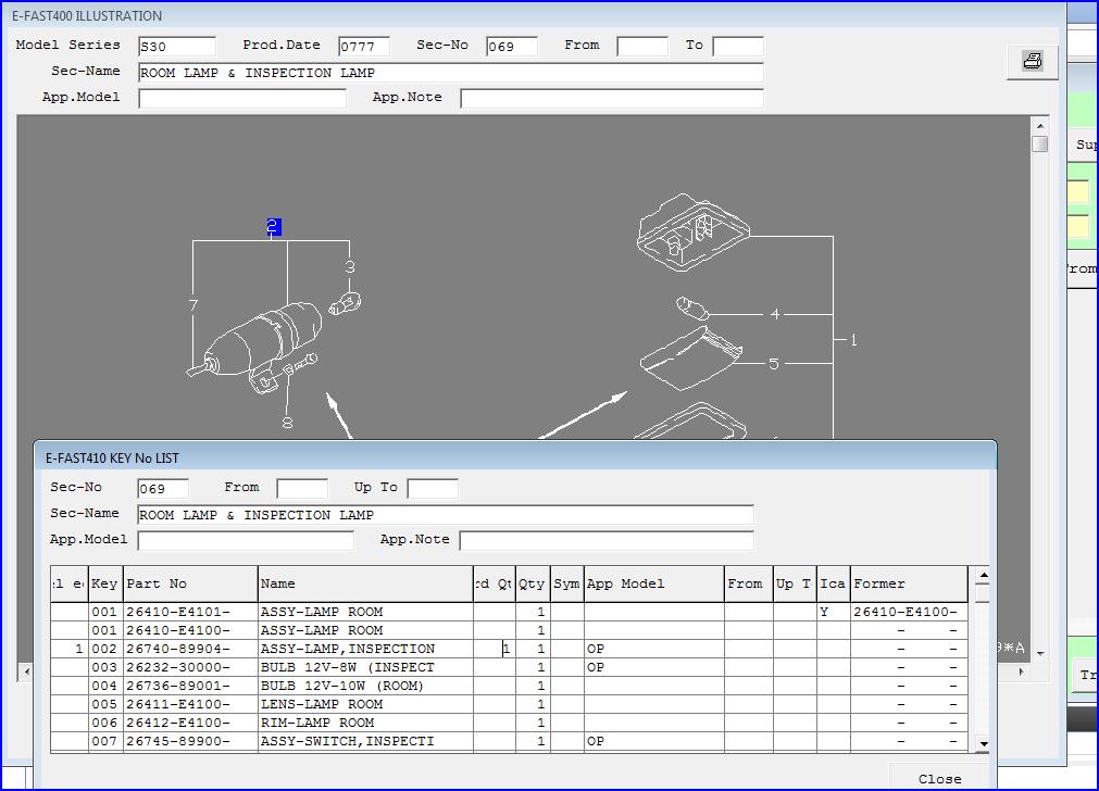

Nissan here says the p/n: 89902 is NLA. I wonder what the difference is between the two part numbers 89902 and 10W00? Maybe one is sivler and the other the gold colour?
The 10W00 is the P/N for the Datsun 720 Truck. It supersedes P/N 26740-89904. I believe the P/N you're referencing is likely the 240z P/N. Same part, different numbers for different applications. Someone else would have to explain the "why" behind that.
Normally the E-Fast database shows the new part number and former. I can only find the "former" number. The Nissan dealer pointed me to the 720 truck part number.
I was just wondering why Nissan didnt add it to the 240Z - 280Z parts cat. Would have same time searching. Maybe its because it was an option in the Z's?

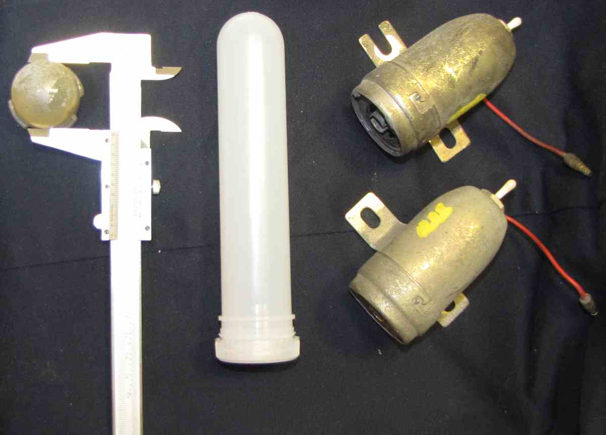

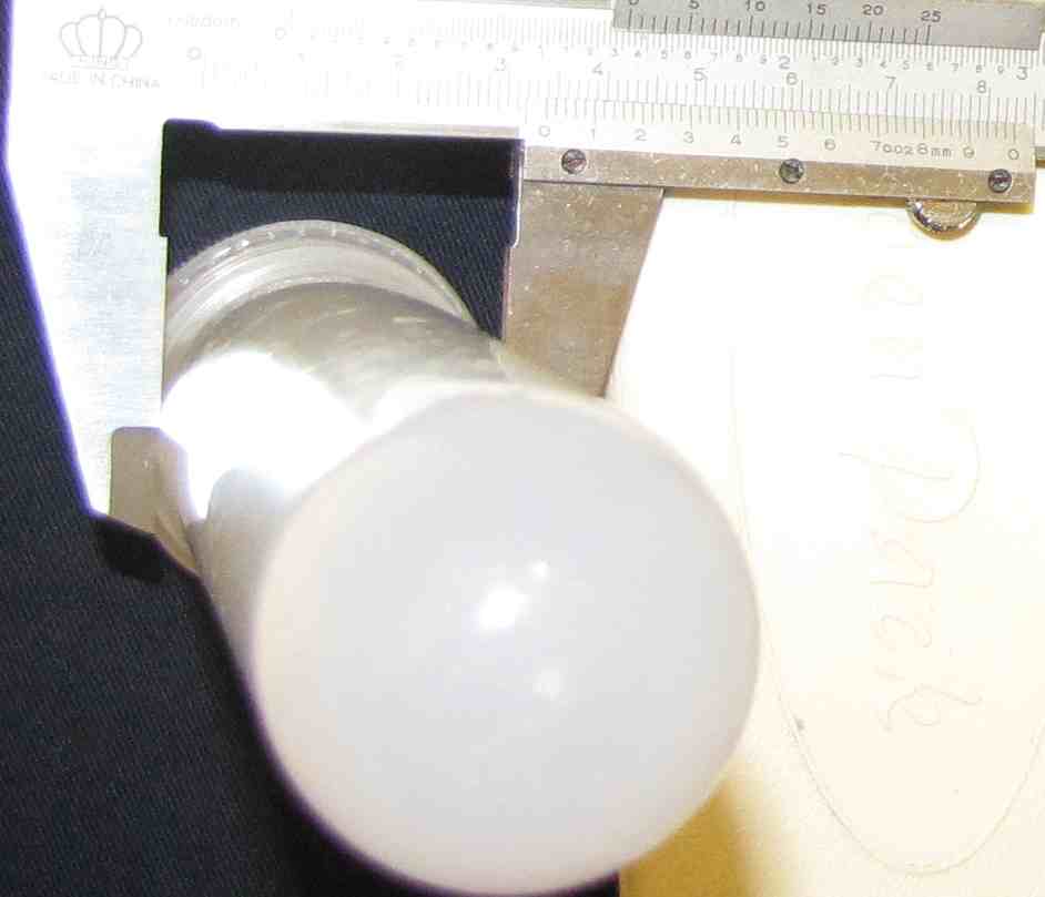

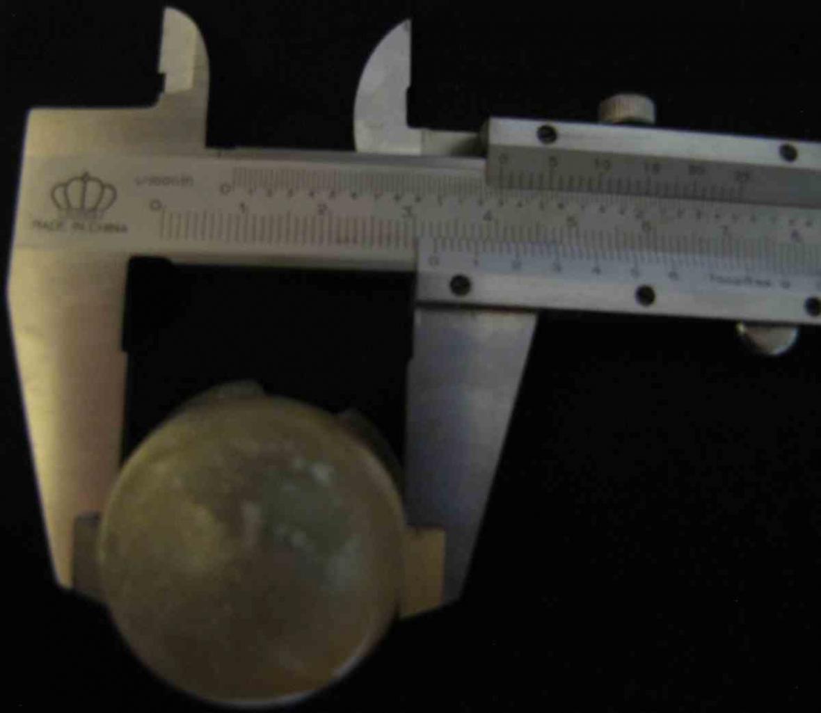

If a new lens is needed apparently one can be made by sawing off the bottom rounded end of an empty energy drink tube someone gave me. Unfortunately I don't know the kind of drink it was but I will get that this week from the guy who gave me the empties. The old lens per my measurement is 32.53 MM in DIA and the energy drink tube is 33.78 MM in DIA if I am reading the caliper right. The new lens material can be ground with a bench grinder where the retaining tabs are on the metal body for a tight fit so it won't fall off though there are variations on this idea. One of you may have a better idea on how to captivate the lens that is more like how the original mounted than what I came up with. I plan on sharing anything further on this VIA my blog when I get done with it in case anyone else wants to try this. The old lens shown here and the two engine bay light assemblies came from JY 280ZX's; my car is missing this item. The pictures vary in brightness but were adjusted for maximum readability of the caliper.
Mike
New lens material and old lens:
New lens material measures 33.78 DIA:
Old lens measures 32.53 MM DIA:
