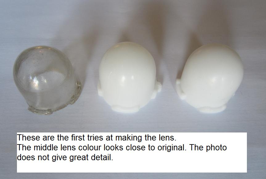

I made a couple of lenses with a white dye. The second one I made looks pretty close to original. Thats the one in the centre of the photo.

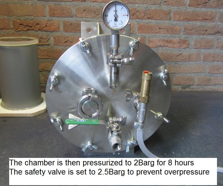

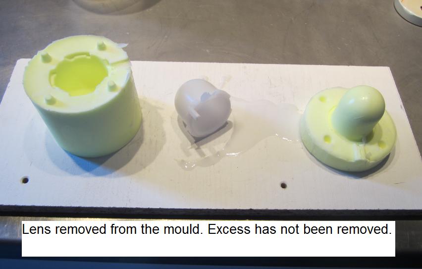

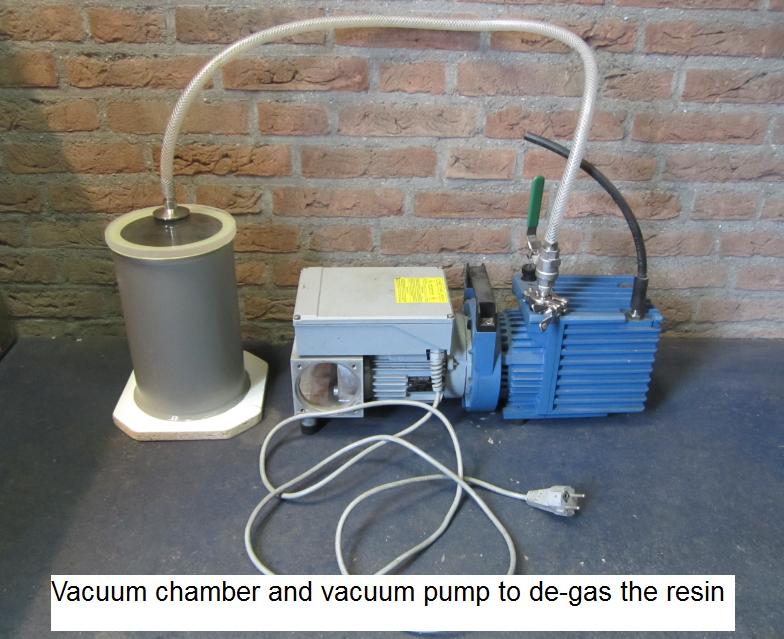

Equipment; A compressor - Vacuum pump - Vacuum chamber to de-gas resin - Pressure chamber to pressurize resin until it cures. This is to prevent champagne bubbles effect from forming in the lens - Scales to weigh resin, dye & hardener - Seringe or something to inject resin in mould - Release agent (spray) to help release mould and clean up.
