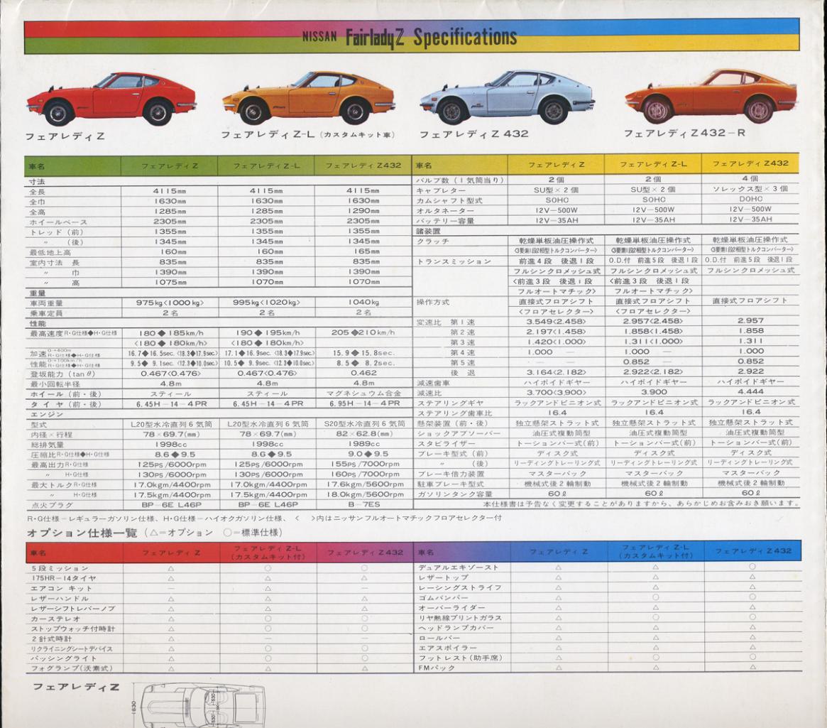

Damn, if only that engine/trans combo made it into production! A factory L24 with triples, 10.5:1 compression, and 175 "BHP" at 6800RPM paired with a close-ratio 5-speed would've been awesome, to say the least...

The brochure page you are looking at was prepared and distributed in North America prior to the arrival of the first cars. It is evidence (I believe) of the original confugurations of manufacture planned for the North American market. The same sort of issues apply to the picture of the engine configuration and technical data. This information reveals what was obviously an anticipated manufacture configuration but not the final.
