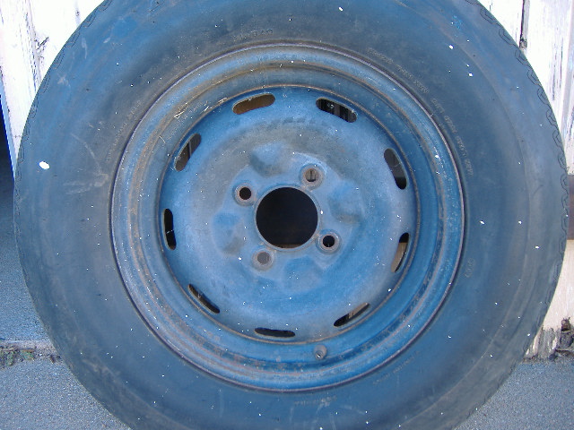

You may be getting misled as to the "original" 1970 rim.
The vehicles arrived in the USA with the OEM Stamped Steel Wheel that is more than likely the same one your spare tire is mounted on.
Datsun Dealers would remove the steel wheels and hubcaps and replaced them with aftermarket "mags", most commonly using the "slotted oval" variety. The steel wheels and hubcaps now command high prices because of this.
Due to the vagueries of obtaining the same wheel on the East Coast, the Mid-West and the West Coast, there are some variations even within the "same" style. There are 4 slot varieties, there are stepped edges and angled edges as well as smooth and stepped transitions to the center flat.

Correct. At least for the North American market, there were no other factory installed choices. Anything else was dealer-installed.

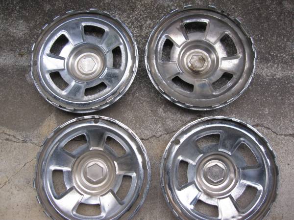

This is the OEM wheel / hubcap combination as the vehicles arrived in the North American market. Other markets may have had differences, the main difference that I'm aware of is that the Japanese Home market had a Z instead of the D in the hubcap center. (I may be misinformed, and if so welcome clarification.)
Hubcap For the 70/71 Z:
http://www.classiczcars.com/photopost/showphoto.php?photo=29933&title=stock-amp-quot-d-amp&cat=2
http://www.classiczcars.com/photopost/showphoto.php?photo=9922&title=d-caps&cat=2

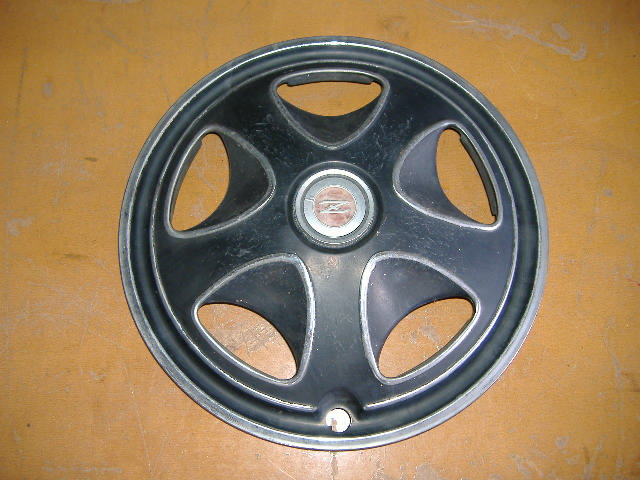

Here is a steel wheel and a wheel cover from my 73, like the 72 it does have a Z in the center with a red reflector. Over time the red turns to orange or pink when in the sun for 40+ years. I painted the orange to pink reflector blue to match the car. Very few even notice it is not 'right', but I like it.

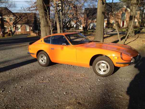

Yes they were very popular on Z's, Camaro's, Mustang's,Javelin's,Challenger's,Malibu's,Torino's, and almost any car from the late 60's to early 70's. My former Z had them and seems that most Cali Z's that I looked during my first hunt had them. I rather have a less popular look and add a little personality ;)
