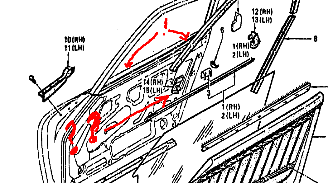

The FSM for 240's and 260's shows the door glass rollers or bumpers almost in the center of the door along the top outer lip. However, the shop is telling me that they do not fit in that location. Can anyone describe the correct location or provide a photo of an installed roller?

Probably more of a mis-aligned drawing where the perspective line is easy to misconstrue.
I've attached a snapshot of the respective sheet of the club's CD with the locations annotated.
While the vehicles arrived from the factory with only ONE, there is provision on the door for TWO. Many users have found that having both rollers greatly reduces window rattle when the window is only partly lowered.
The rollers ARE sided.
HTH
E
Yes - it is a bad perspective. The Drawing shown is for the 260Z from Aug 73 Forward. Where E has the ??? is where the Roller is shown in the 260Z Drawing.
The Drawings in the Parts Catalog for the 240Z is a little less confusing - as it shows the Rollers in relation to the door panel fuzzy - and moved away from the door in the background. The Parts Catalog shows different Part Numbers for the 240Z and 260Z as well
Right and Left 240Z
80933-N3400
80934-N3400
Right and Left 260Z
80840-E4101
80841-E4101
I have not seen the Rollers on the 260Z - are they mounted straight, unlike the 240Z Rollers? If so I could see that they would be mounted toward the rear of the window.

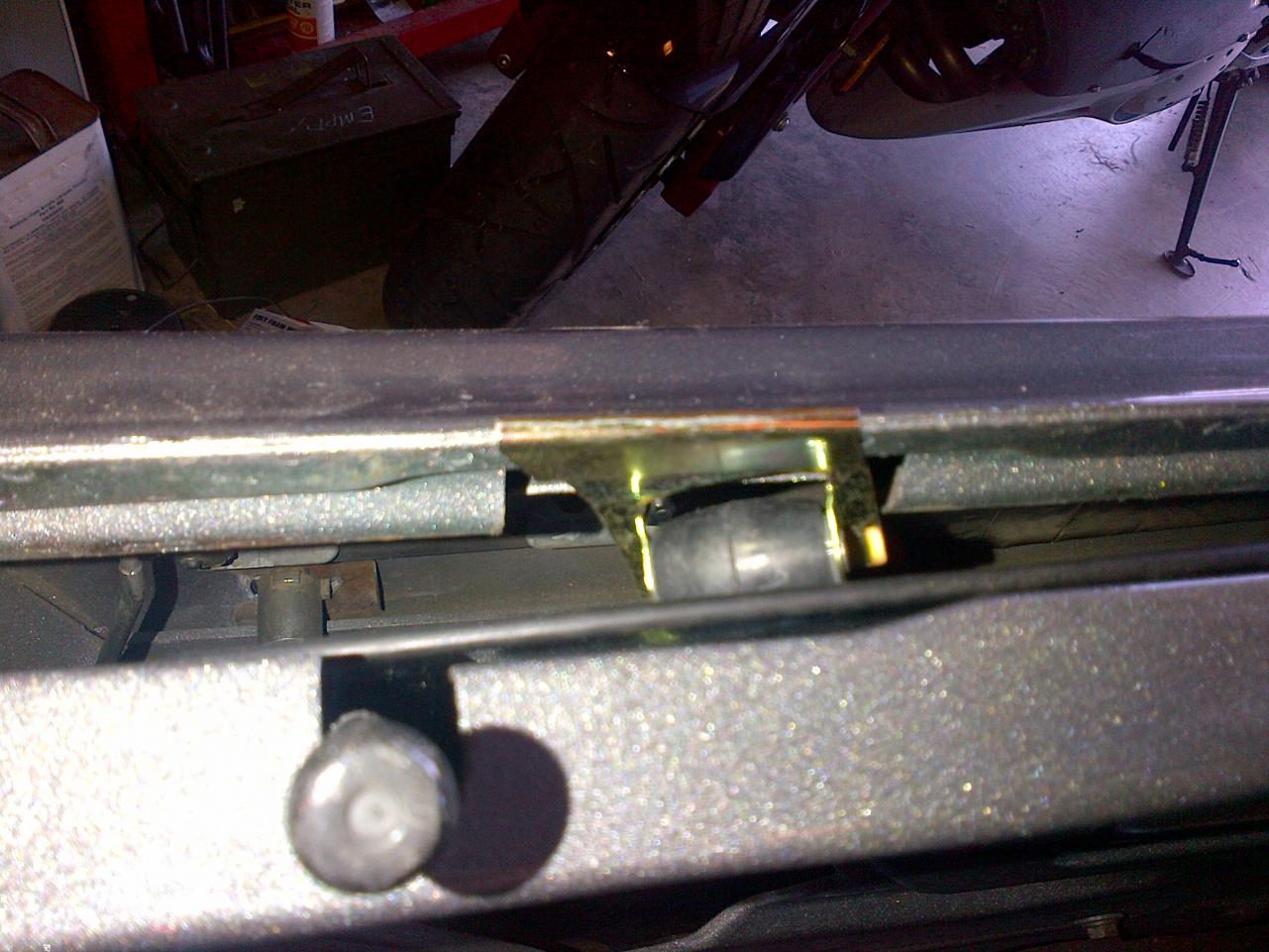

FWIW, I put a second roller to the rear of my '73. Found a pair in the junk yard. They work fine w/ less rattle than before. Also, when I first got my car I found both rollers in the bottom of the doors. Apparently they had fallen off at one time or another...windows really rattled w/o them.
Cheers, Mike
