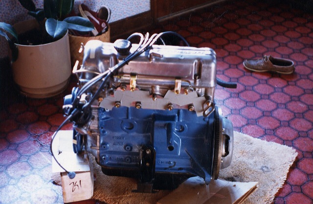

I built a 510 motor on my kitchen floor years ago. Same system.....plastic tarp....3 layers of cardboard and muscle. Nice!
