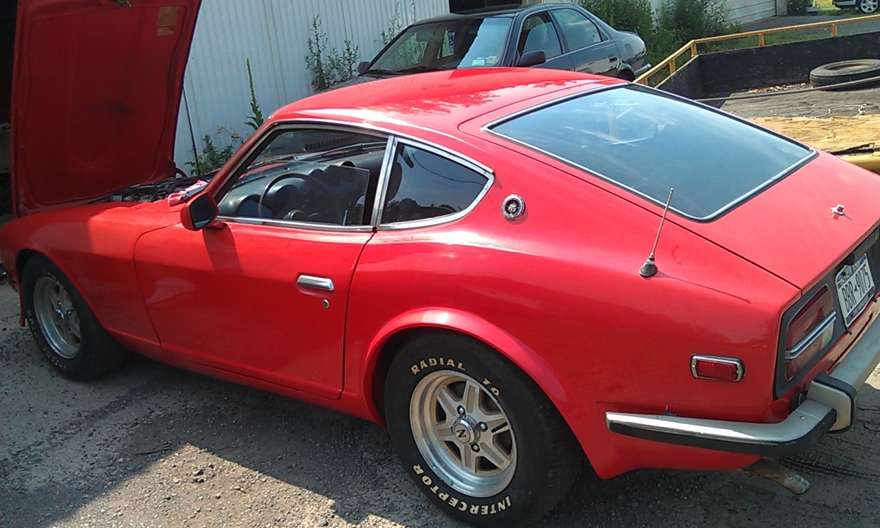

Anyway, there was a very good (at least I thought so) on a 73' 240z I couldn't pass up and just bought it. Here is a phone pic until I can find the cable to my camera.

The car seemed like a good buy at $2900. There is not a single ounce of rust. The suspension is fairly clean, I checked all the common places for rust. Pulled up the carpets and checked the floorboards, spare tire well, front and rear quarters, and the engine bay. No rust anywhere. The motor has 43,000 miles, original to the car. The wheels are also in good condition. It starts right up and runs. I don't now much about dual carbs and how to go about tuning them so any recommendations to guides would be appreciated.

You say no rust, how about bondo or any other sign of previous body work? It looks like it has a new paint job.
After finding suspect areas by tapping lightly with finger tips, use a fridge sheet magnet to confirm any possible bondo'd areas.

If you need any help. Hit me up. BTW Beautiful car! On a side note, I keep seeing those rear quarter arches on a lot of Z's. That rear wheel arch lip is not stock IMHO. What is the story with those?
Here is the stock rear wheel arch lip.
With about $2000 to $3000 dollars in parts, you can fix ALL the problems in your list and have a GREAT car. I wouldn't worry about paint bubbles unless they were caused by rust. Sometimes, like mine, they are just caused by poor prep work under the paint.
