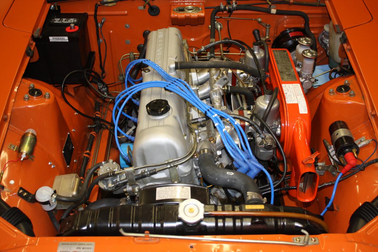

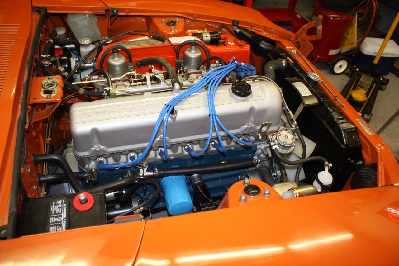

October 22, 201212 yr Author comment_404957 Update.......Installed the L28/L24 combo motor in the new 72 Z. I put 350 miles on her and didn't really push her till I put the new 2 1/2 inch MSA Premium exhaust system on. WOW.......What a wonderful motor.....she pulls so quickly, smoothly and torquey to 7,000 rpm that you need to be ready to shift (it sneaks up on you so fast). This engine is so much better than I thought it would be. It's just is so silky smooth up the rpm band and down the rpm band (downshifts). The L28 motors (with L28 cranks) are pretty much done at 6500. Not this motor.....It is a joy to drive and as OZ mentioned, it must have the perfect bore to stroke ratio, cause it's truly amazing! I would recommend it to any Zed Head! Link to comment https://www.classiczcars.com/forums/topic/39741-new-engine/?&page=6#findComment-404957 Share on other sites More sharing options...
