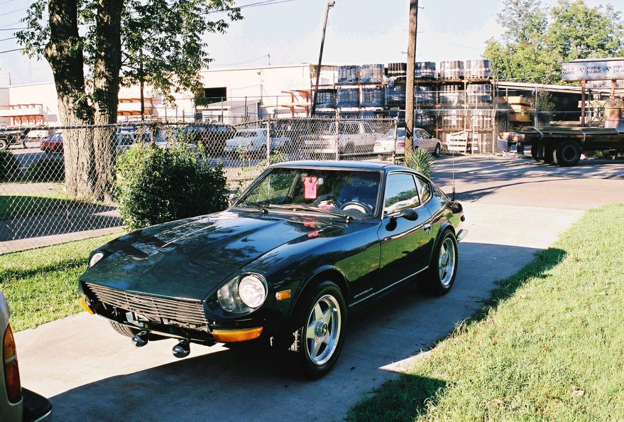

The first set I put on my AVATAR rubbed the outer lip 225/50R16 16X7.5 wheel. They rubbed in front and back. In the front only when wheel was locked to the left. The second set I went to a 40 series tire. Problem solved. I still run the stock suspension with a thick anti roll bar, a thick rear anti roll bar will also almost eliminate rear axle squat under hard acceleration. 7.5 wide is about as wide as you really need to go IMHO
