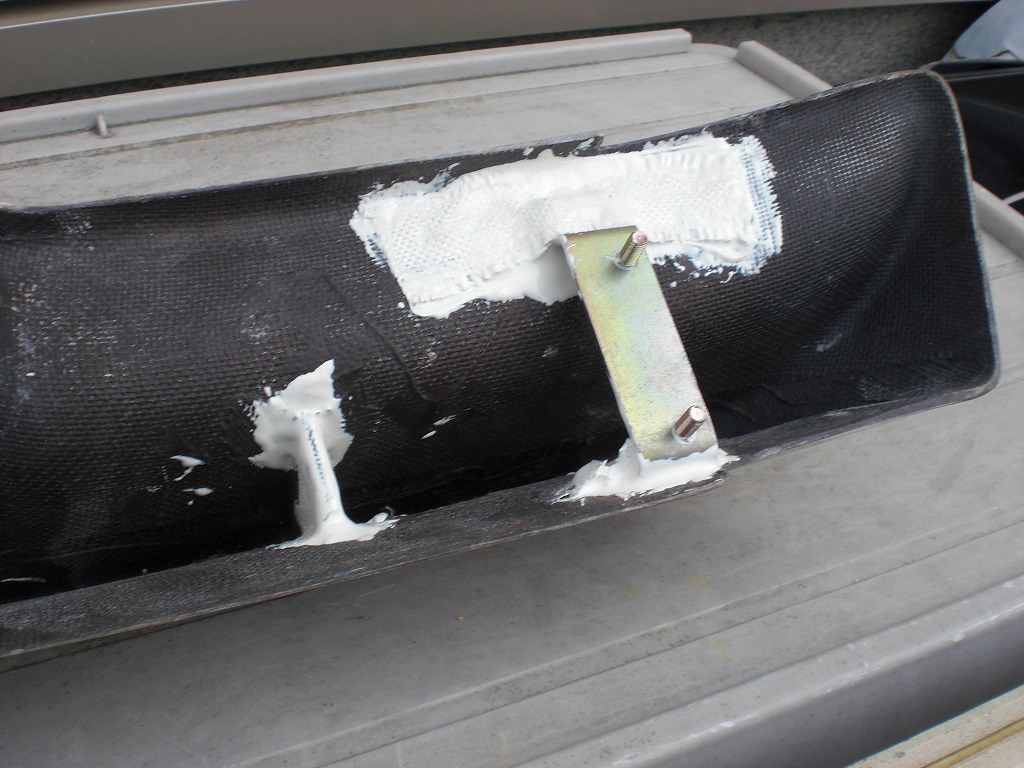

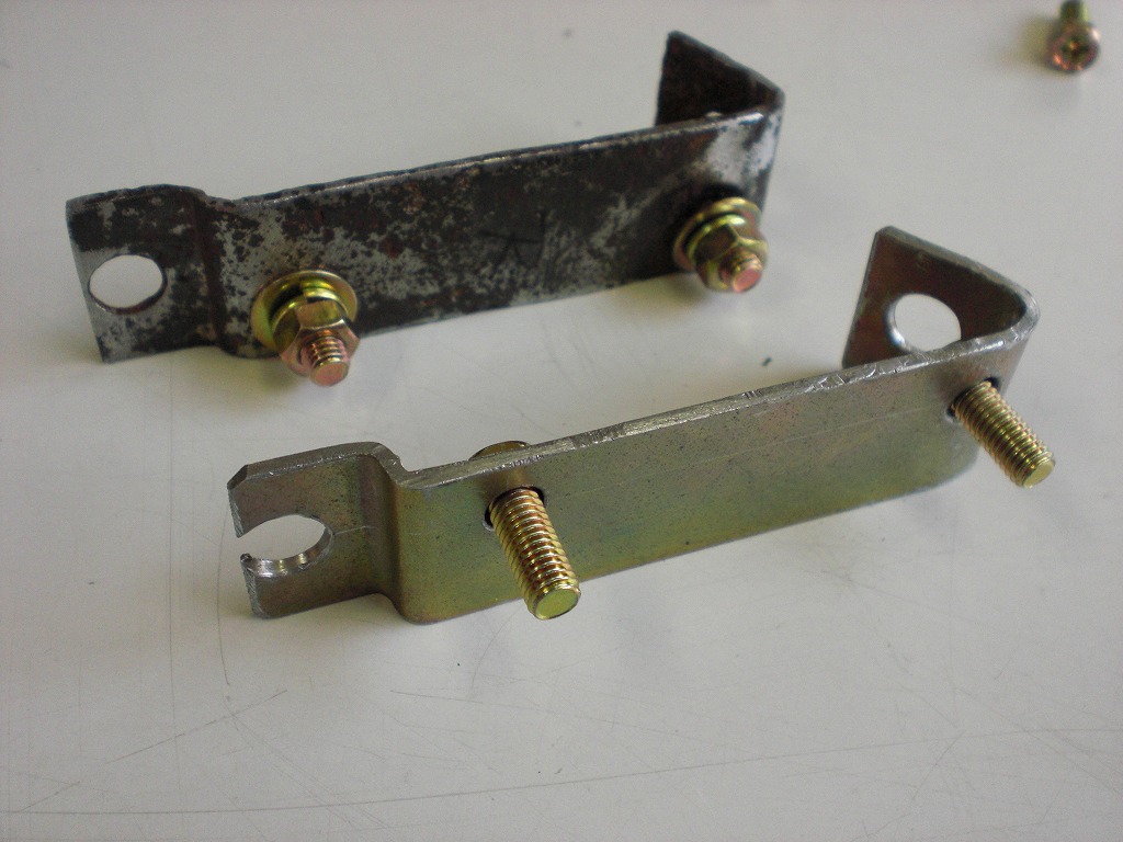

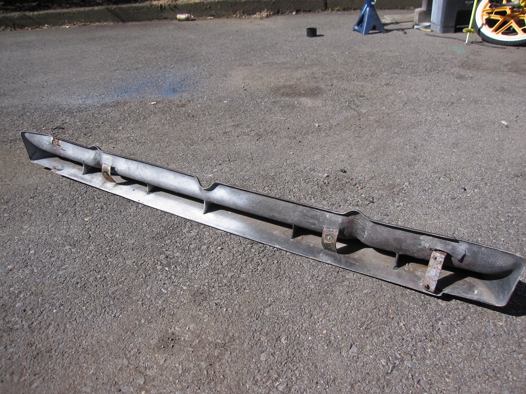

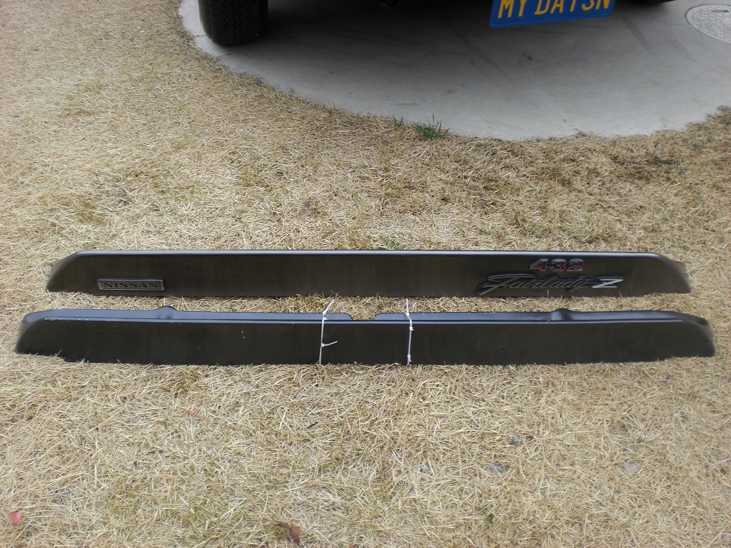

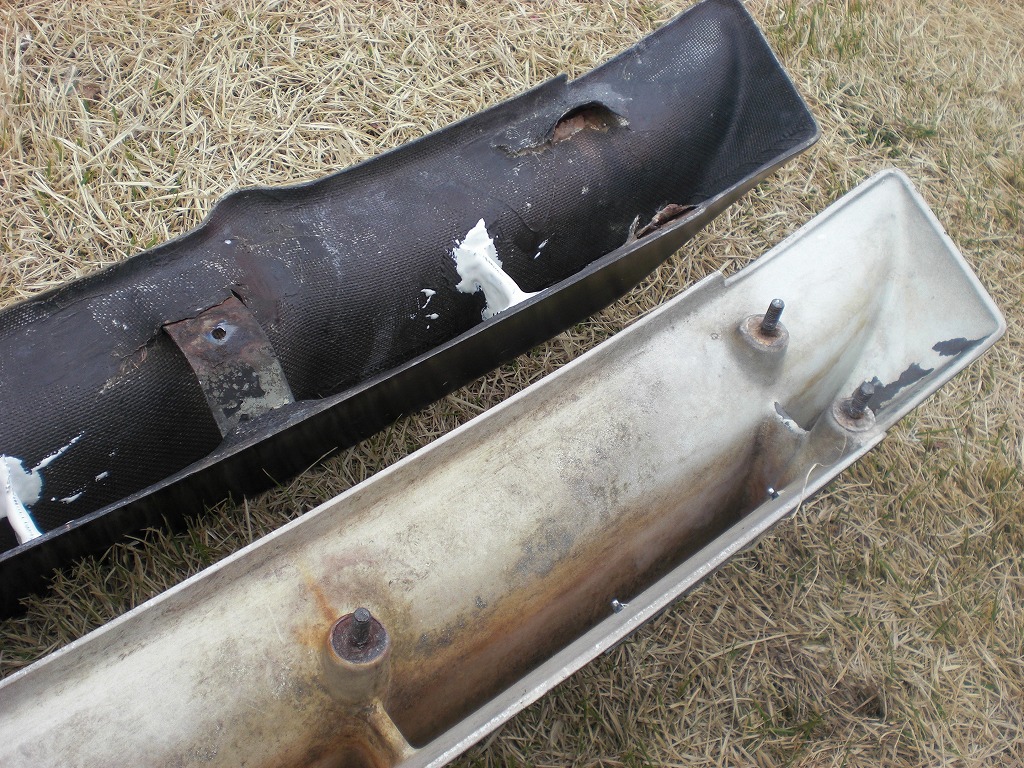

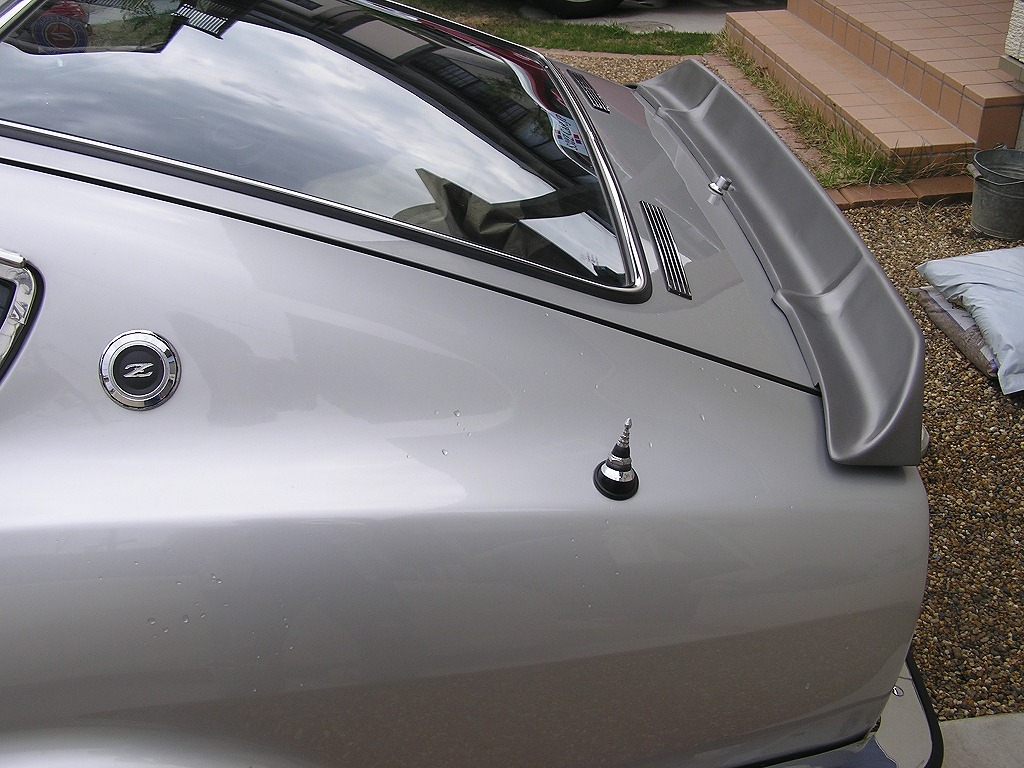

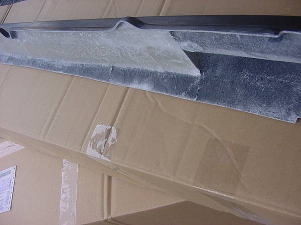

Hi,
My Z432 has an genuine option rear spoiler.But it is not periodically correct one.
The one is for 1971 or later.
Last month I have got a genuine earliest spoiler from Mr.Terashima.
He is a hard core enthusiast , he has 2 Z432s and 1 Z432R.

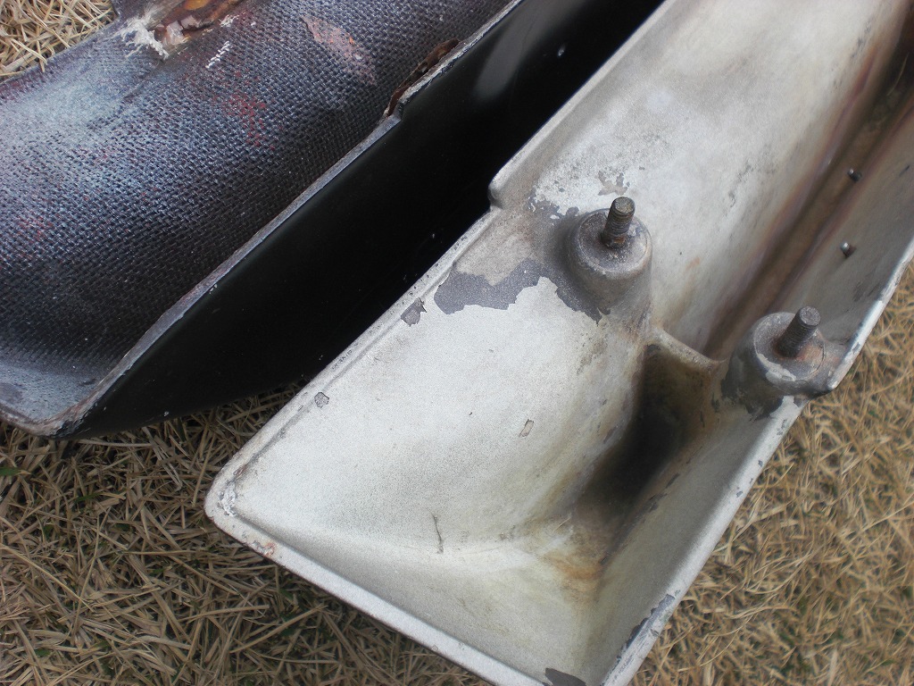

The earliest spoiler is a very,very rare to see.We sometimes see the ones but they are usually reproduction one.It is easy to distinguish, repro one does not have
correct stud bolts nor brackets.Also we can see it from the outside, the 2 vertical ribs on the top face is a kind of short,lack of its length.
My earliest spoiler needs to be restored,I want to do it myself.
The later spoiler is improved so much in the forming and strength. It became
very heavy then bolts went to 6mm from 5mm in the early one.
If people do not know much about the earliest spoiler, they will think this one is not genuine option spoiler from Nissan...It is too thin and light and not so good quality of making.
However I want original early looks for my 1970 Z432.

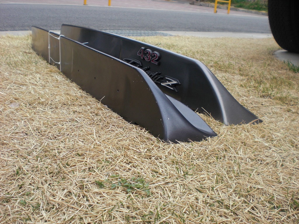

That is a great find, Kats. Should not be too difficult to restore it. It will look perfect on your 432.

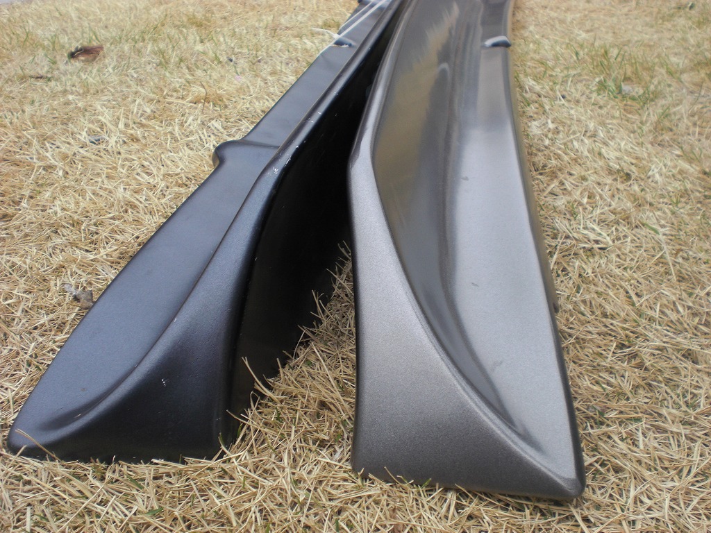

Thanks for the pictures, Kats! Very interesting - different material and construction technique. I would have guessed the black one is a reproduction type.

Wow! I did not know the early type had "brackets" to hold it in place rather than "studs" you see on later type. I have a later type one on my car like yours, but it is so heavy (part filled with rasin material) to a point my brand new rear hatch shock comes down when it is cold day.
Great photos!
Very nice kats! Cannot wait to see it on the car... I have the "later type" as well, purchased from Esprist.

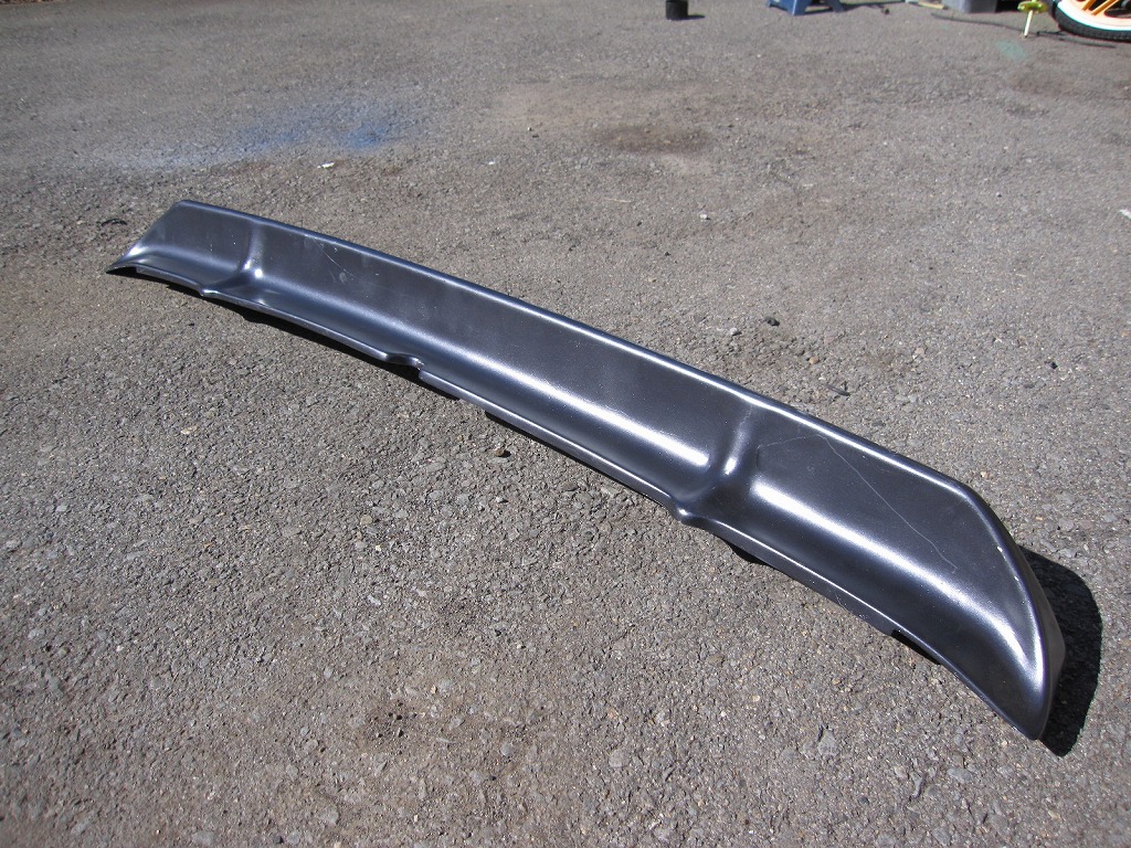

The spoiler that I sell is the same one that Kats shows as it came on my RHD Z many years back. But the brackets inside seems a little flimsy so when we made the mold I opted to put a bottom plate on ours to strengthen the brackets and help keep moisture and dirt from getting under and laying on the paint. I am fairly sure that this spoiler was the model that BRE used and refined for their needs because my real BRE spoiler is slightly different. So we are going to be finishing the new mold for the BRE spoiler soon and again Our rear spoiler that is availible now is the same one Kats shows but with a bottom cover on it. Les
The early spoiler has 2 mounting tabs, the ones near the humps. These spoilers also have a tendency to bow inward, don't know why but they do.

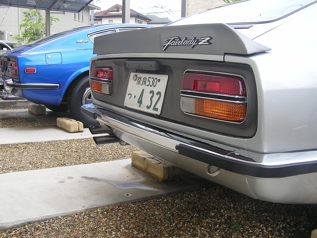

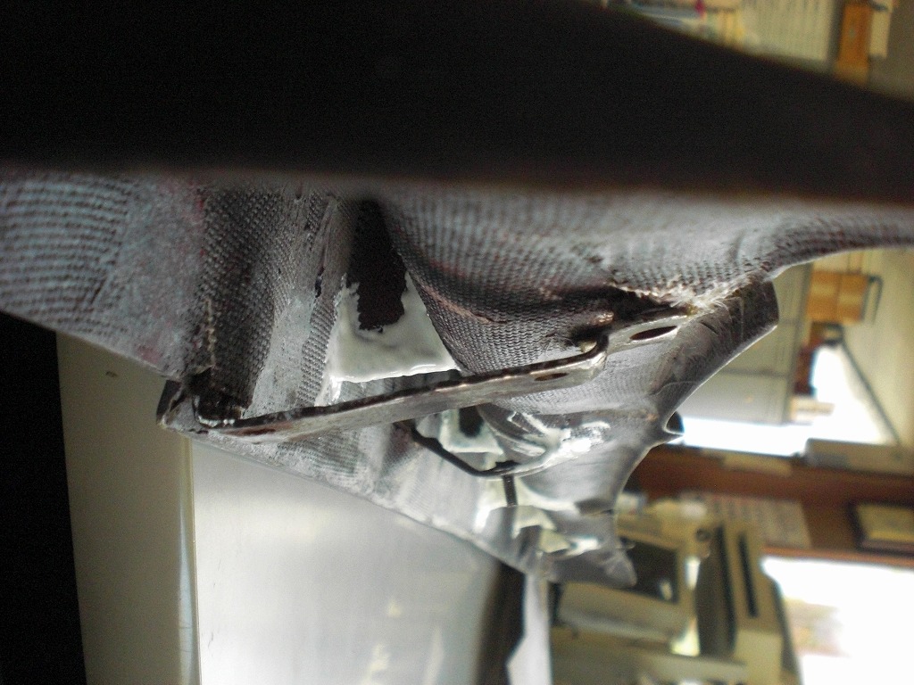

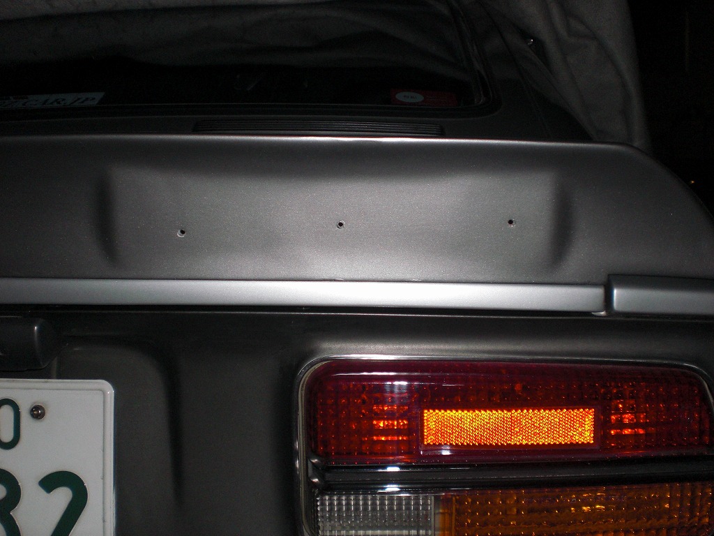

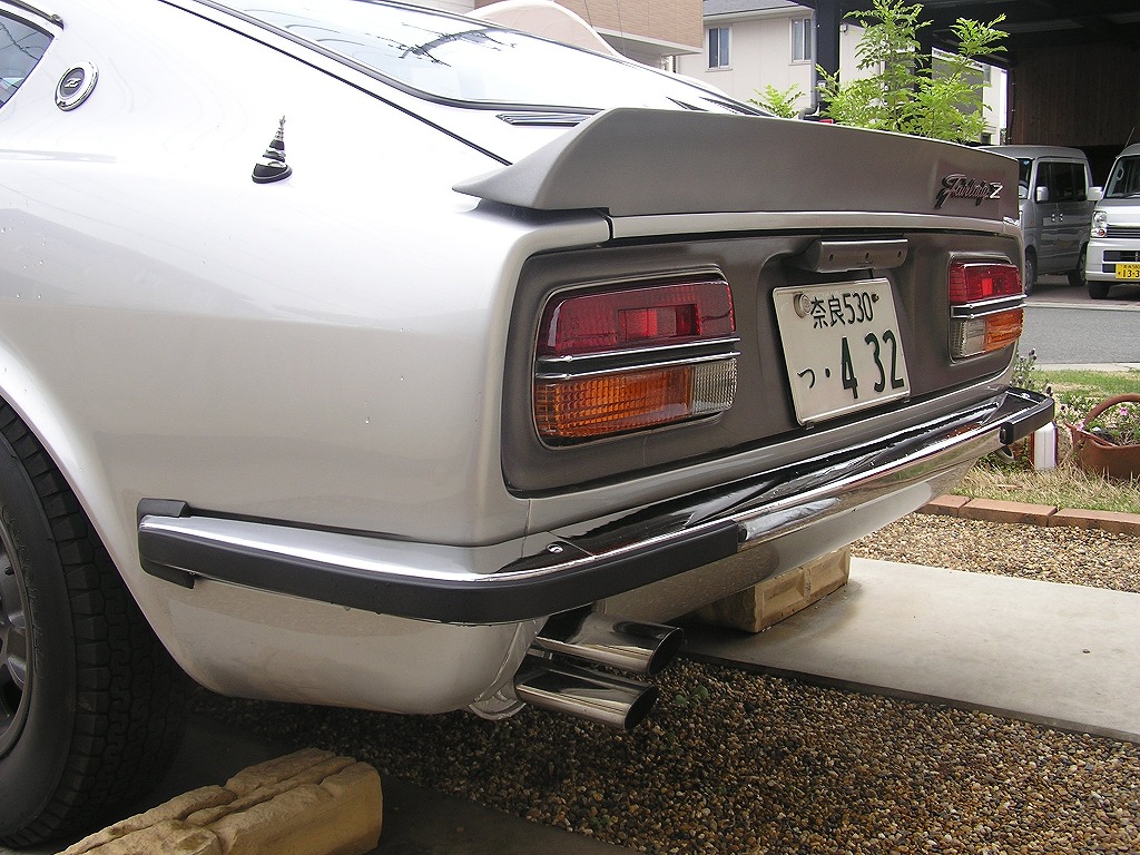

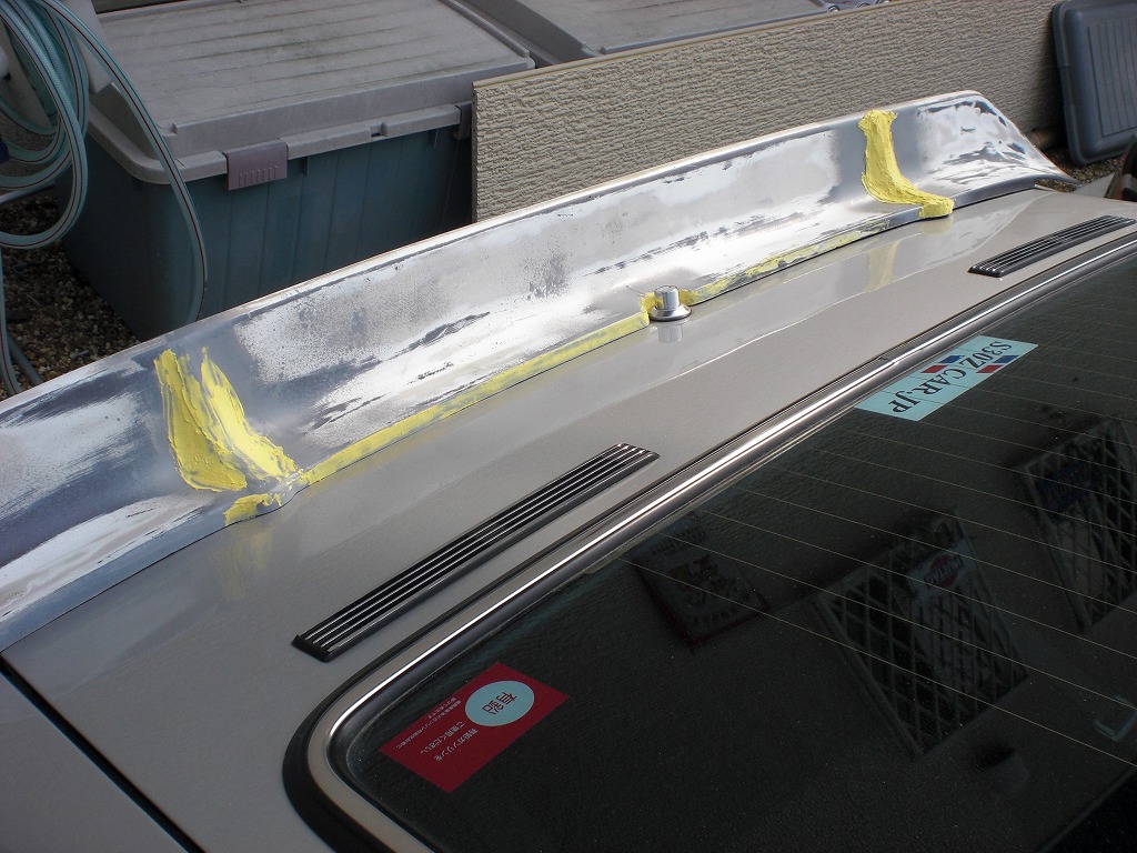

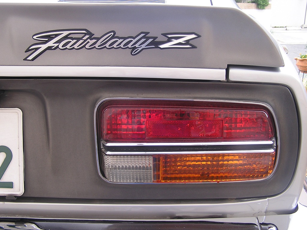

Hi,Thank you everyone,I did restored the spoiler.I am not happy with its finish, I should work hard for sanding and painting.But currently this is my best,do not look it closely!I used a heat gun to be flexible the portion of it where should be straighten.Also I put FRP liquid and cloth to fill the gap between body panel and the spoiler.And for reinforce the spoiler.Color is not matching for the original,but I am OK.Please note 3 holes for the emblem on the back,they are a good sign of original early one.The earliest spoiler has only one emblem " Fairlady Z" . These holes are exactly correct locations and dot size.Compare the official photo of Z432-R, you will see mine has the same location of the emblem. I looked into holes from inside of the spoiler,there are no evidence of repairing or filling extra holes. kats

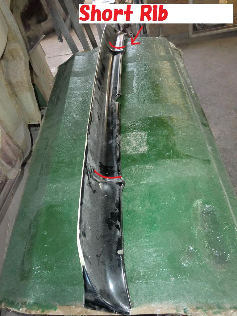

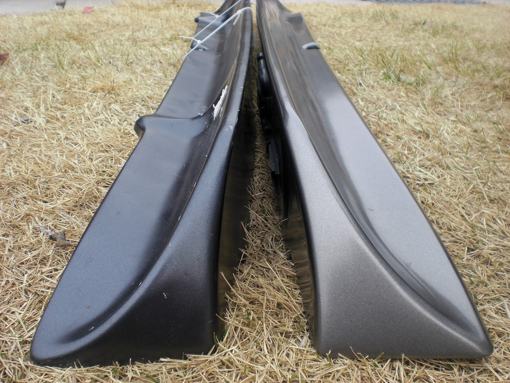

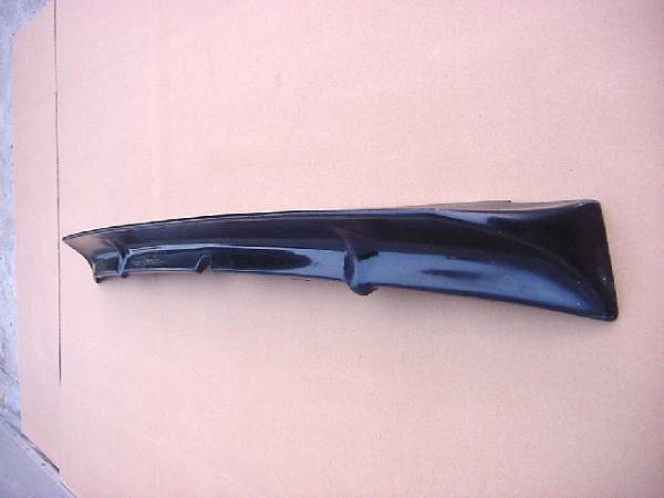

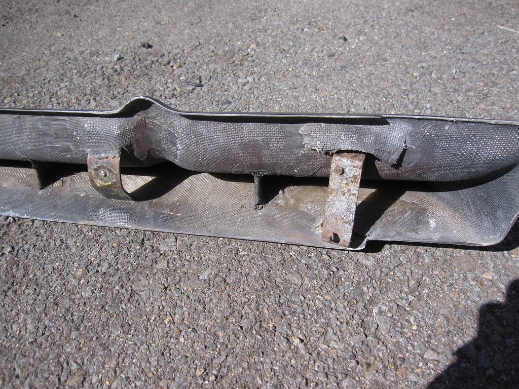

Hi,
These photos are typical aftermarket early spoiler in Japan.
Please note shorter ribs and different inside and without bolts.
kats
Your spoiler turned out better than mine. I'm jealous. Nice job.
