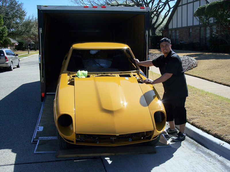

The car is getting a full restoration and just recently returned from the paint shop (that's the painter in the pic). Reassembly is underway, on the road again by summer is the goal.

Like the paint, like the 920 color can't wait to get mine in the shop. Mine was built in April and will be contacting the shop for her 40th. What brand, prep, and number of coats was your car? I'll be doing 920 also

On the paint question, the products used are all Matrix brand. I have a note in to the painter for additional details but he has not yet got back to me. Here is what I have so far.
Just prior to painting, the car was sprayed with a sealer, product unknown. The primer is MP3 catalyst primer. The color coat is Matrix base coat, topped off by MS42 clearcoat. There are two coats of color, hand sanded between coats, also two coats of clear. The finish was color sanded, then buffed with three levels of progressively finer product, topped by a polish. I don't know what process or program was used to determine the color mix - one of the questions I have in.

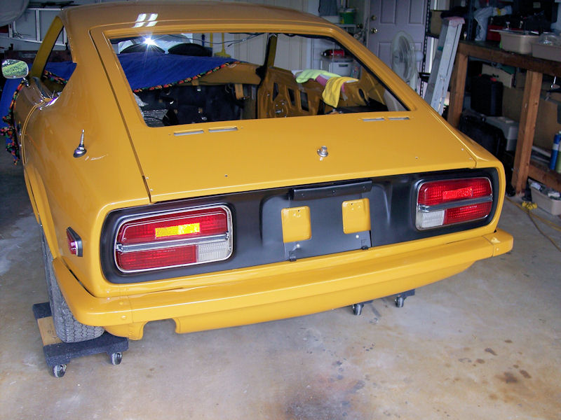

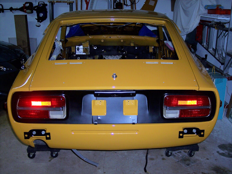

Here is a picture from yesterday, it show two of my personalizations for the car: the rear finisher in satin black, and the rear bumper - fully slicked, and finished in body color. The front bumper is likewise finished, it and the grill - also satin black, won't go back on until after the engine goes in.
I try to keep a few progress shots updated in "My Garage".
