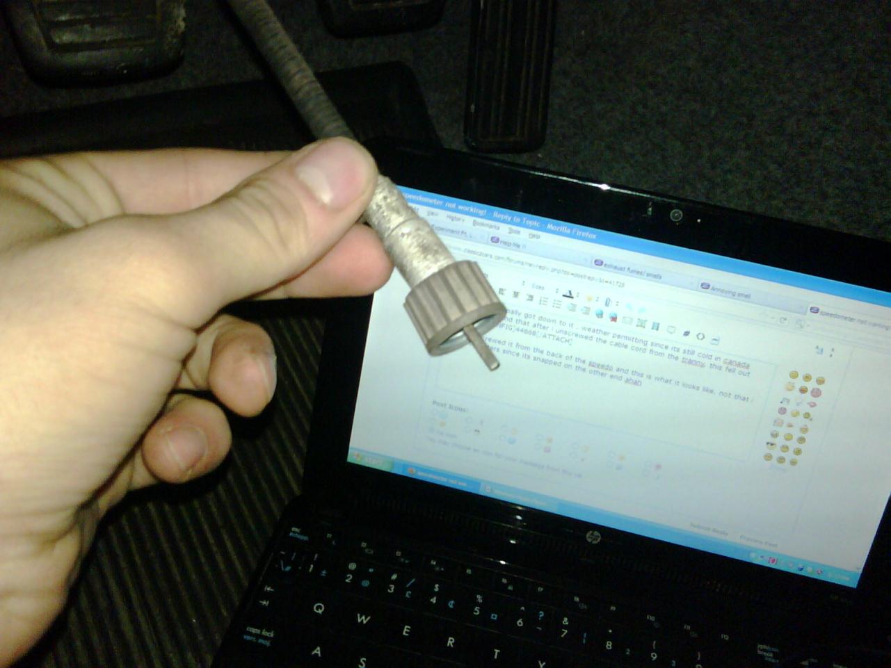

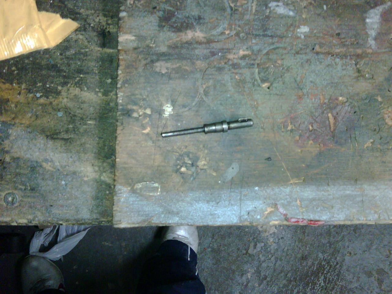

hrvat Posted April 27, 2011 Author Share #13 Posted April 27, 2011 alright guys i finally got down to it , weather permitting since its still cold in canada (grr), and i found that after i unscrewed the cable cord from the tranny, this fell out i also unscrewed it from the back of the speedo and this is what it looks like, not that i think it matters since its snapped on the other end ahah so now the question is, where the heck do i get a new cable? do i just pull this old one out? Link to comment Share on other sites More sharing options...
