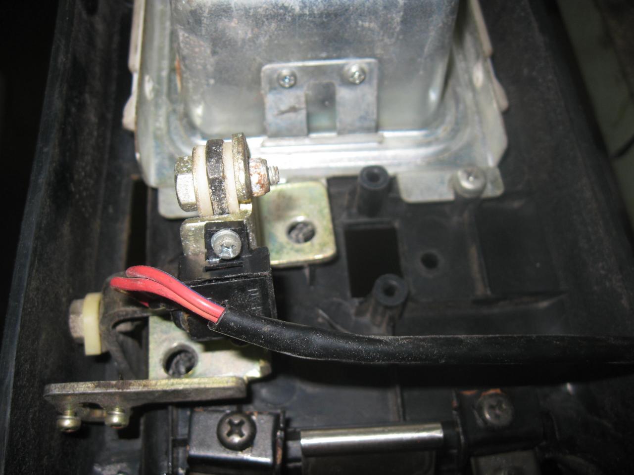

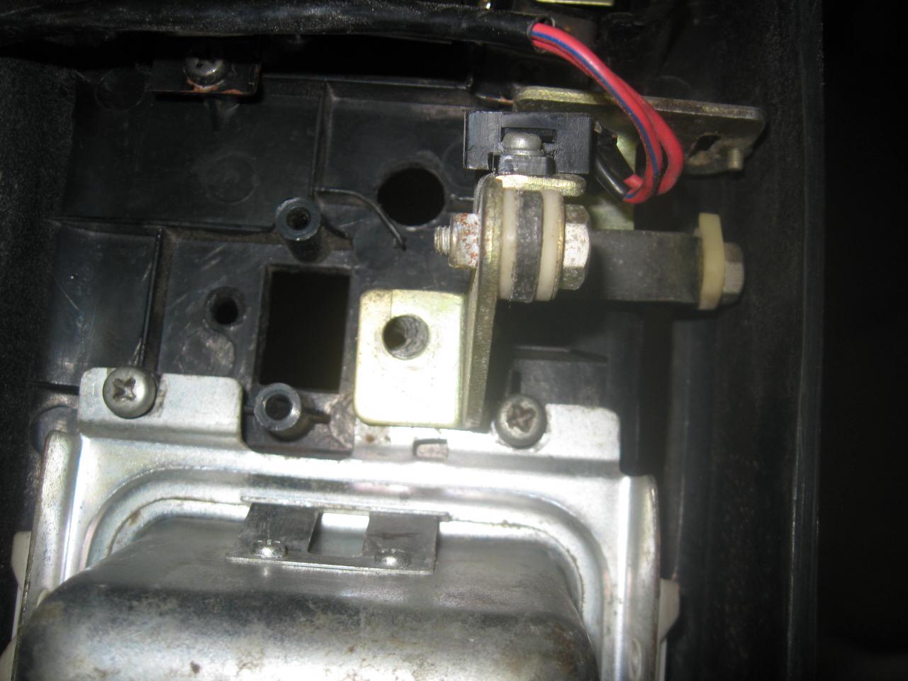

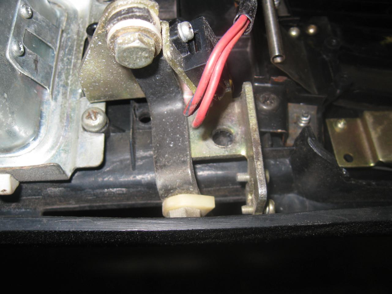

Here are some pictures from a '73 console. This is from an automatic, but the choke was mounted the same for auto or manual.

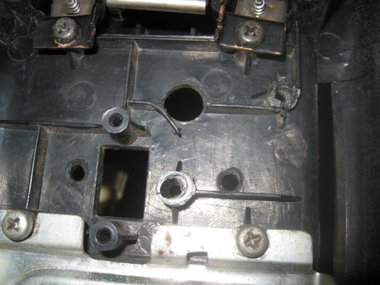

The mounting posts get damaged from the pressure exerted on them when the choke cables start to stick, or from something heavy pushing down on the lever. I'm in the process of restoring several consoles and have not arrived at a method of reinforcing the mounting. Notice the big hole in the center area. I have no idea what that was for, but it will be plugged.
Choke mounting posts - (gear shift at top) the post beneath the large circular hole and to the right of it are the mounting points.
Choke in place top view (ashtray at bottom)
Choke in place lever side view
Choke in place front to back view

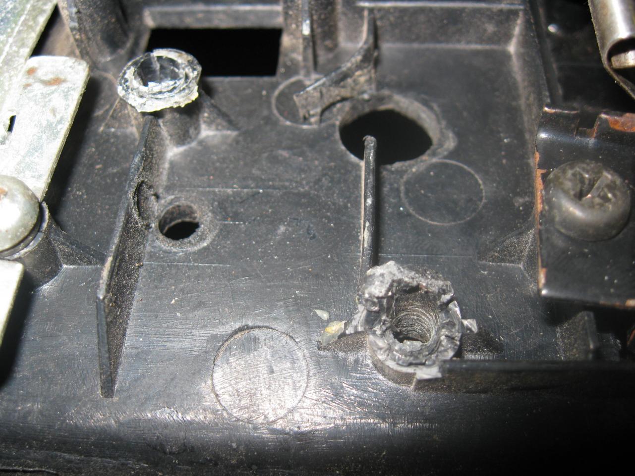

Side view - notice typical damage to mounting post
Those broken bosses are pretty typical. I had the same condition and ground the entire choke boss down and used a piece of lucite and gorilla glue to make a new one to screw into. If the bosses are just cracked, I've found that ABS glue embedded with fiberglass strands (wrapping around the boss) works pretty well.
AH! Thanks all. Especially for the pictures. So it screwed in from below. I have been doing my homework and I read somewhere that the rectangular hole was for a light switch on Euro models and never used in the U.S. Thats where my a/c wires come up.
