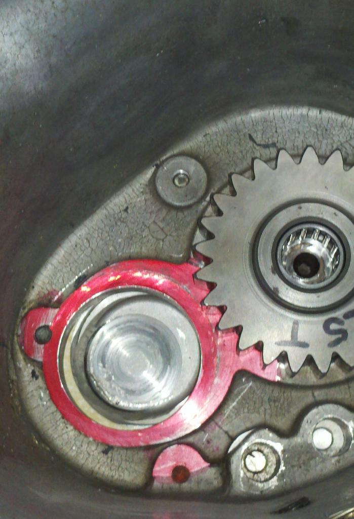

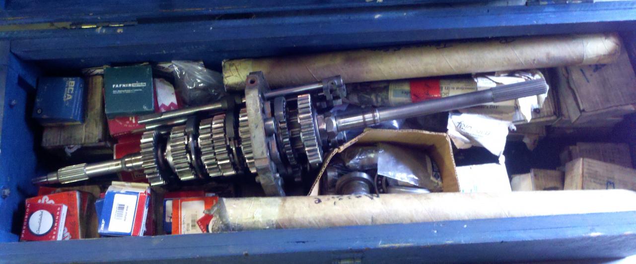

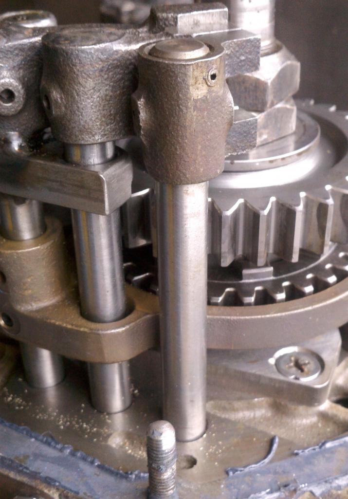

The attached pictures show one of the Preston 5-spd "dog-ring" transmissions that was used in the BSR/Newman 240/280 race car.
It doesn't use synchros but rather dog rings (see picture of it next to the gears) and ratios can be selected from a wide range of gear sets to match whatever type of road condition you might encounter for a given race situation.

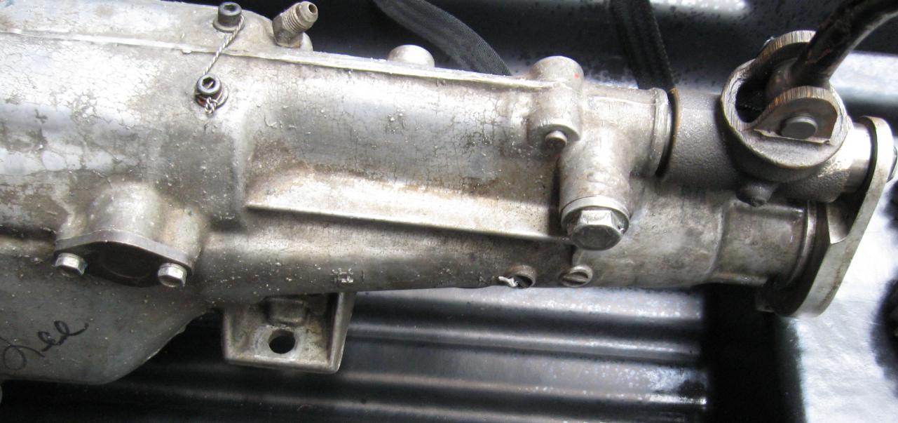

Note the lack of tabs at the tail of the tranny (one for a 280b and two for a 280a tranny but none on this one). The added collar at the end of the tail and the machined spacer were mounted to provide additional support for the shifter as more pressure (a lot of pressure) is used to change gears.
There are AN fittings for the gear oil cooler and the inner case was machined to accept the gear sets.
You can see the name "Lee" at the bottom left on one of the photos and that's Lee Chapman who had the BSR Z in his shop in early 1999 after Bob sold this car and several others to a gentleman in New Hampshire. The car is now owned by Adam Carolla.
Here are the gear sets I got when I purchased the tranny:
QTY MFG Ratio Gear 1 Gear 2
1 Preston 1.67 18W30 30W18
2 Preston 1.94 16W31 31W16
1 Preston 2.00 16W32 32W16
1 Preston 1.24 26W21 21W26
1 Preston 1.14 28W31 31W28
2 Preston 1.18 28W33 33W28
2 Preston 1.29 21W27 27W21
1 Preston 1.35 20W27 27W20
2 Preston 1.40 20W28 28W20
3 Preston 1.53 29W19 19W29
2 Preston 1.61 18W29 29W18
2 Preston 1.67 18W30 30W18
1 Preston 1.76 17W30 30W17
1 Preston 1.82 17W31 31W17
1 Preston 2.43 34W14 14W34
