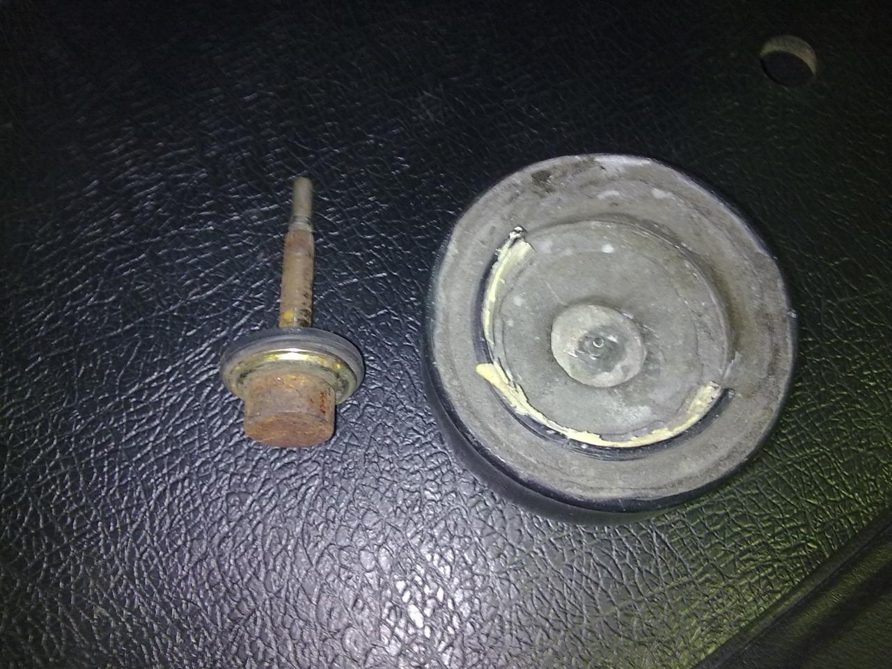

I couldn't get it off without doing any damage so i let the valve alone for a while..It was stuck in the hard lines. Is this part somehow related to my braking problems? In other thread there were some discussion about this part. I think it belongs inside master vac..? (dont mind about that broken steering wheel cap)
Just be aware that a faulty master vac can cause a really stiff pedal.
I got mine reconditioned. I assume that you Zee guys can get yours done if needed?
