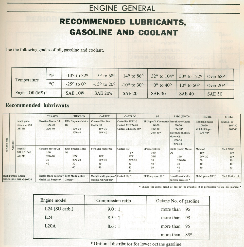

I'm certain that the individual who suggested synthetic oil probably uses Crisco as after-shave! I can't believe all you guys (and there are some experts here) are making suggestions without ANY reference to what the manufacturer recommends. Whoa!
It is with distinct pleasure that Her Majesty the 26th offers this information from the engine service manual. This, of course, is from the 1970 service manual. Later issues may differ.

The reference you present is informative and compelling.
Does this mean we should also be on the look for 95 octane gas? After all, that IS what that sheet recommends. Last I checked, 92 octane IS considered Premium, unlike the 100+ I used to pump into my motorbike in the 70's.
Don't get me wrong, it is an excellent reference and should help a lot. However, I'm just wondering how many of the oils specified are still being offered in their original specifications. That is, the ORIGINAL formula as specified by the Nissan Engineering team when that sheet was printed.
Many expendable items for our cars have changed in the 35+ years since they were new (and 40 for the dates of this specific spec sheet).
You really would have a hard time finding 175HR-14 tires at your local tire store, and if you DID find a set... would you really buy them and not Radials? Then again, would you rotate them as the original manual shows? The manual does warn about mixing the THREE different types of tires, but does NOT give a recommendation on size / type of the other two types. Does that mean we are limited to only ONE type of tire? Or that the engineers felt that you would make an educated or informed choice?
Oil also changes formulations as time goes on.
One spec sheet from my manual for the 72 Z shows that the Monograde oils from Shell and Esso listed on the sheet you provide were "Not Available" at the time of printing, and that's just 2 years AFTER your sheet. Additionally, Caltex, Castrol and BP are NOT listed, and in their place we have Sunoco alone. Not to mention that Shell's X100 oil on your sheet is now Super Motor Oil on mine (and only in Multi-Grade), and Chevron dropped the RPM in their oil name, and Texaco went to the Havoline Super Premium name.
Yet the Mil-Spec (MIL-L-2104B) remains the same for all those oils.

I think part of the point of all this is, that things do in fact, CHANGE! This is what this thread is all about.
Your reference is good.... for a starting point. But as far as to what to use today... well that's what everyone is asking.
