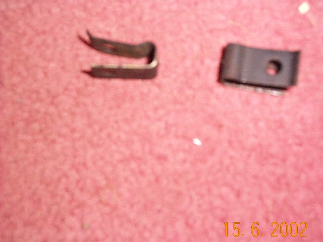

Oh my! Let's go back to that thread MikeB was so kind to reference. Here is a picture of the clip. This clip holds the ducts to the hatch and the grill pin snaps through the hole in the pin. That's how this installation came from the factory.

The "pin grabber" clips you are referring to are commonly known as "Barrel Clips". A good automotive trim store will have them in various sizes, depths and thickness of metal to apply to. Even Lowe's and Home Depot's specialty fastener section has them as well as True Value. They're not impossible to locate.
However, as has been mentioned, those are NOT the correct ones for the hatch grill in the 70.
