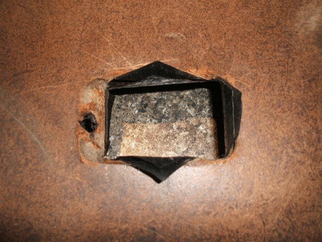

Oops, I put my new glasses on and now I see that the pic of the panel on the first page does have the cut outs. Sorry for the confusion chaps.

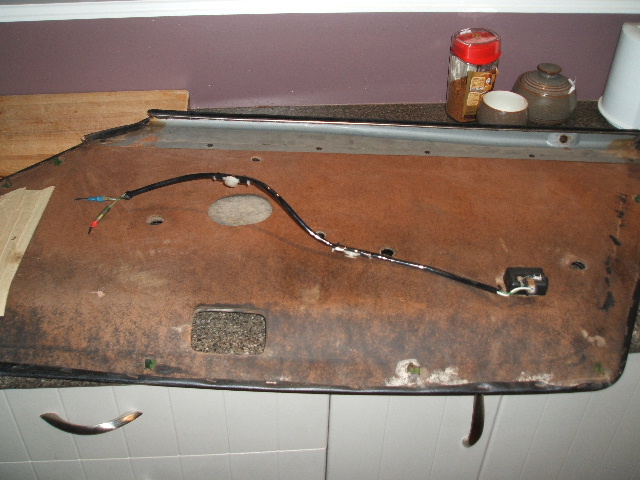

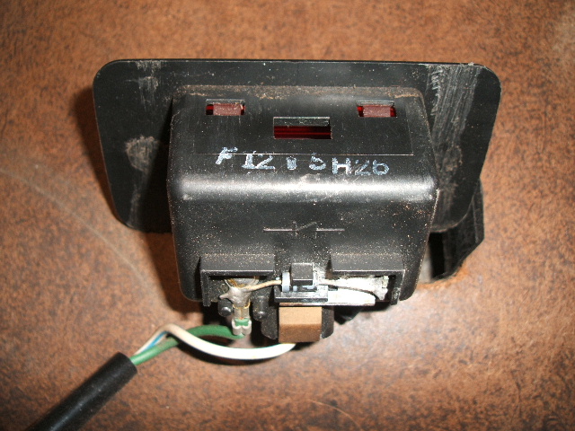

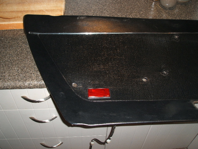

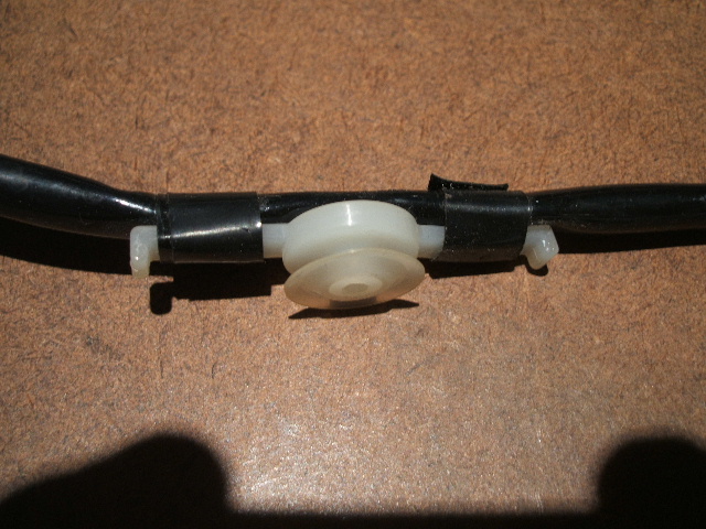

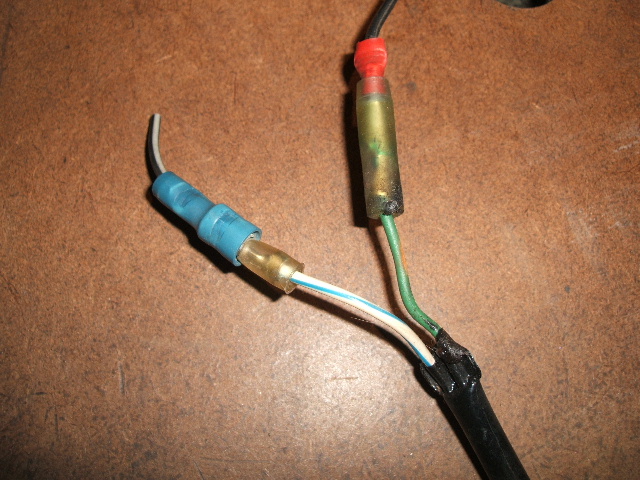

Here are a few pics of the step lamps on HS30-00352
Not Nissan by the looks of them. If you look close you will see that there were two mounting studs that have been cut off with a hacksaw. They are too small for the cut out in the door card. But the cable looks very much like a Nissan product with the ends heat crimped.
So sorry guys, I'm now not sure what the hell they are. They will not be going on the car until I know more. Not that the car is ready for them...sheesh.
To me, they look like the work of a safety conscious individual, maybe someone who made frequent stops on the side of the road. Who knows? Anyways, they are something that make your Z unique. Unless you are a stickler for originality, I'd keep them. :bulb:Get yourself a paper route.:bulb:LOL
