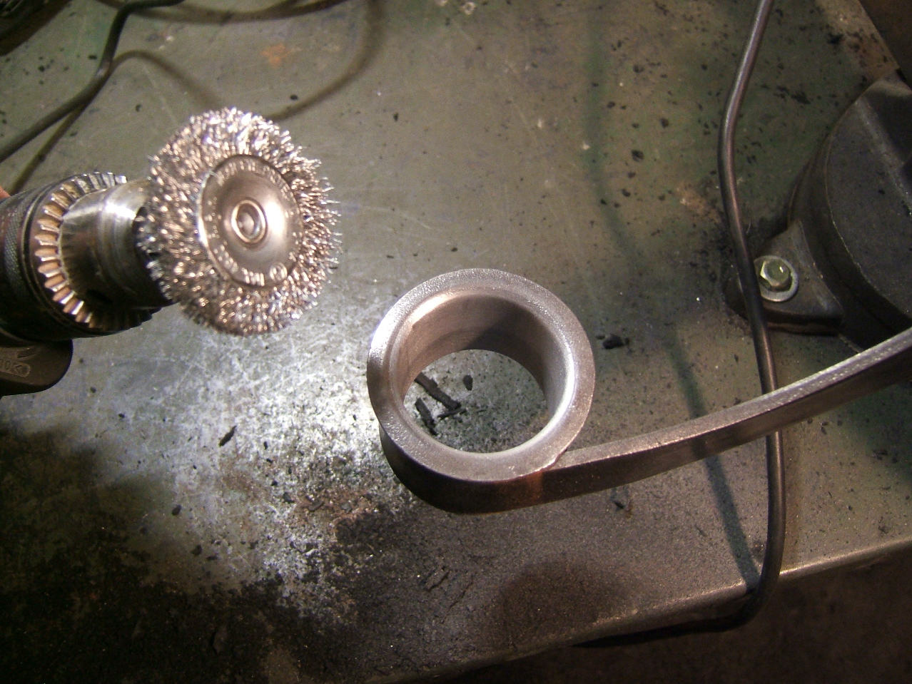

Hello guys. I just want to verify this. I have removed the factory mustache bar bushings (using Marty's drill technique which worked very nicely) and cleaned up the residue as shown in before and after photos. The mustache bar will be painted, and Nissan rubber bushings (PN 55476N4300) will be installed. So, as posted by Marty and clayton 260Z, the sleeve inside the loop ends is not removed, correct?
Gary S.
