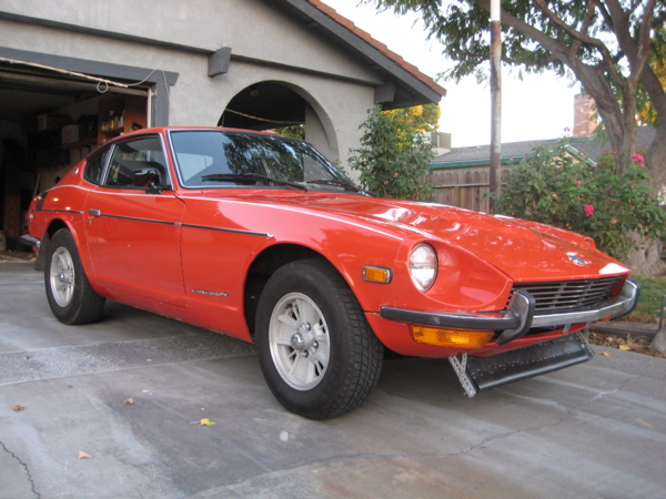

Hopefully a photo:
Brutal, cheap and effective. Cost for the parts was under $15.00 (excluding the rubber sheathing which I had around -- figure another $5.00 if you want) and it nails the front end to the ground. Big improvement in crosswinds, even seems to cut down on exhaust odor. Hasn't cured my rhoomytism, though.;) and I'm sure its extracting a mileage penalty, but in all honesty, I haven't noticed one.
I didn't mention it in the original post because if it had turned out that the unloaded coils were a source of the floaty problem, the spoiler could have been covering up the problem.
Holy Mecano set-up....
I suppose it isn't noticeable at speed...
Just don't slow down...
